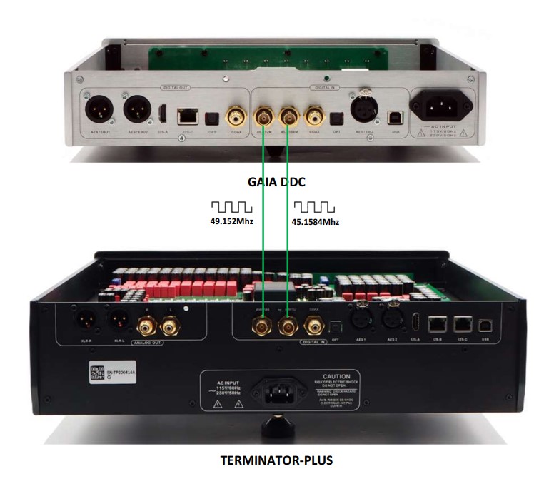

You can use a DDC between the U1 and the DAC. It is critical that the DDC must be compatible with the DAC for DSD signal as there are several non-compatible variations of I2S over HDMI. Incompatible ones will result in DSD not working, left right channel swap, and/or other anomalies.
Therefore it is safest to use a Denafrips DDC with a Denafrips DAC. If you get the GAIA, you can try both USB and AES outputs from U1 (not connected simultaneously) to GAIA and see which sounds better to you. Note that AES output is limited to PCM 192kHz DSD64 (DoP). Also connect the clock as follows:
My friend thought the IRIS to his Terminator (non +) sounded better using the I2S (HDMI) as I recall over he AES option. no clock signals were available with the IRIS tho but its a lot cheaper.
