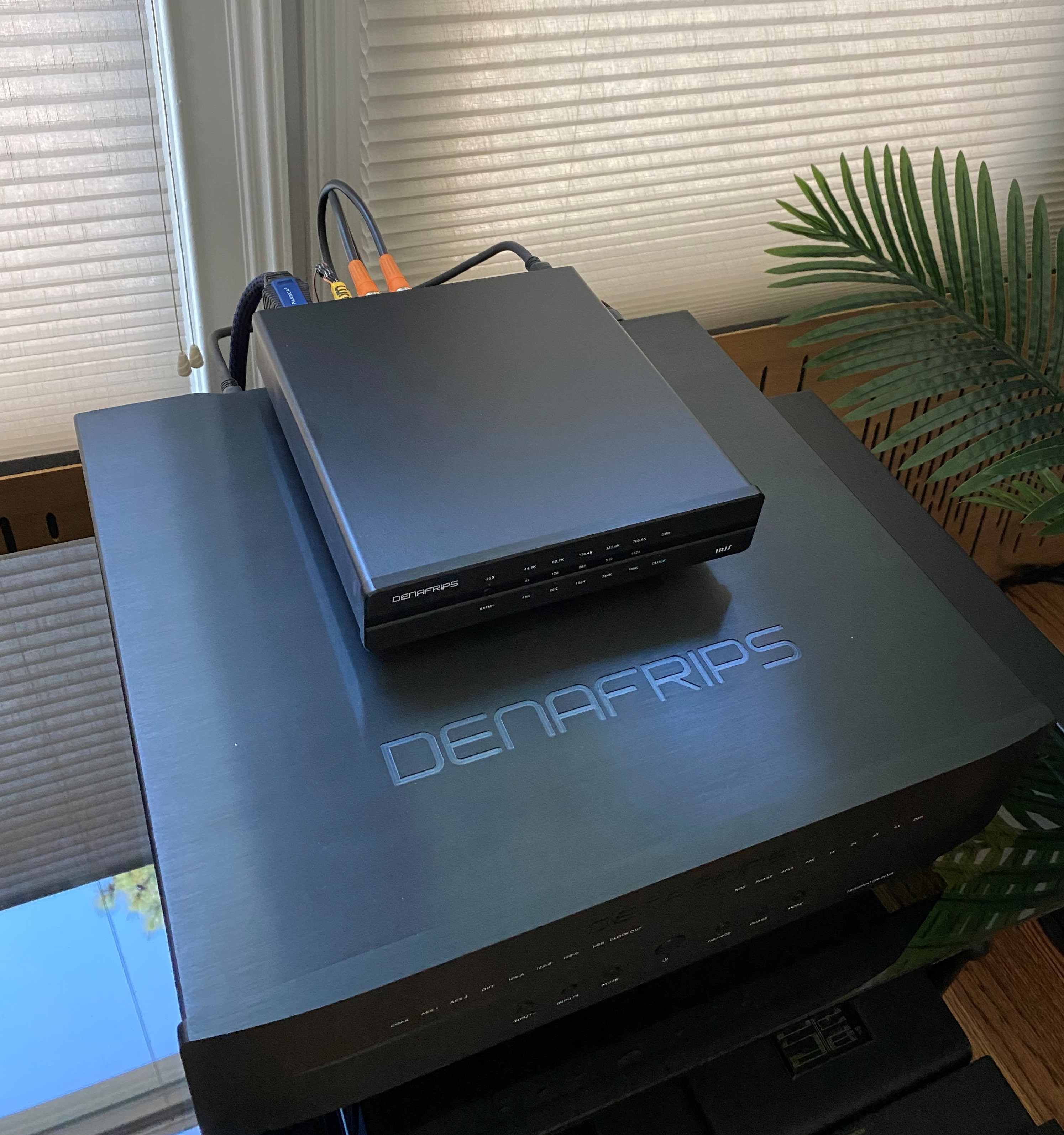

Playback of any track MQA or NON-MQA below 96khz is not playing. UI to GAIA is connected via USB. Using AudioQuest Carbon HDMI, yet to test with Fiber.
If i Disable the External clock sync then all the tracks plays. Do you think one of the clock cable is damaged?
Swap the clock cables.
I removed the clock cables and put them back… everything works now… I followed the criss-cross config earlier too… I guess I attached the clock cables when the unit was switched off earlier and this time it was powered on…

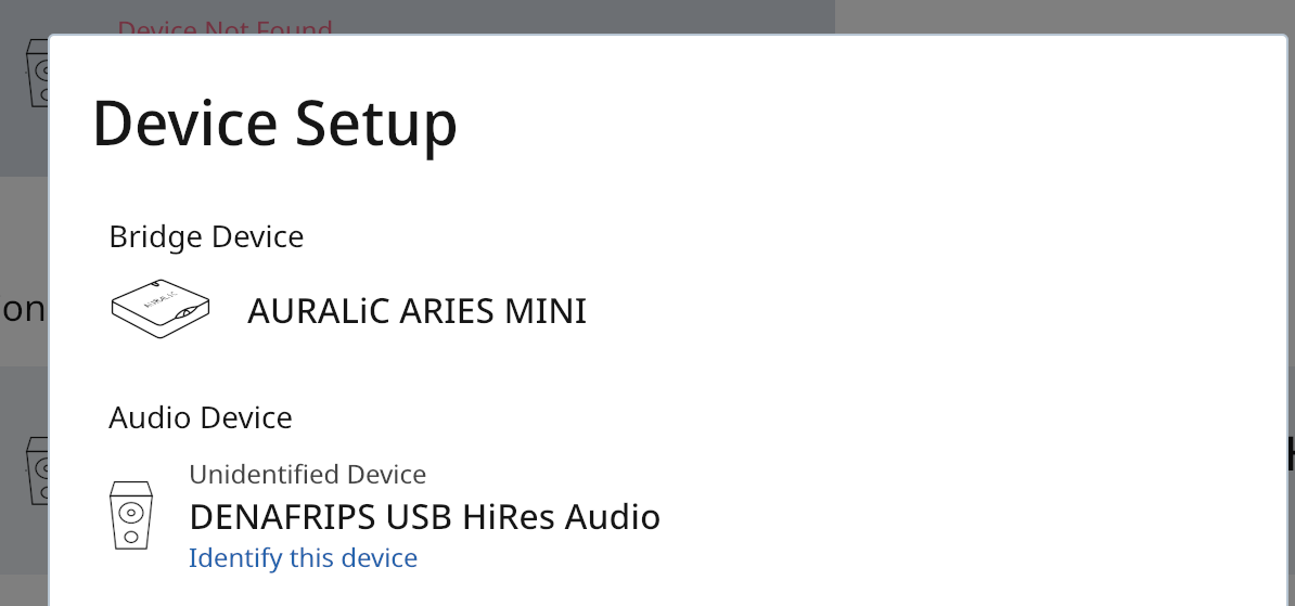

Hi All,

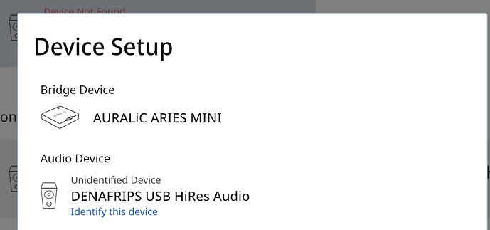

I have the Ares II connected to an AURALiC ARIES MINI currently via Toslink and was experimenting with using USB to connect instead. The Ares II is recognized by Roon when plugged directly into the core, however when via the Aries I get the below?
You’re good. Roon sees the DAC.
“Unidentified device” just means Roon can’t automatically configure the device.
ta.

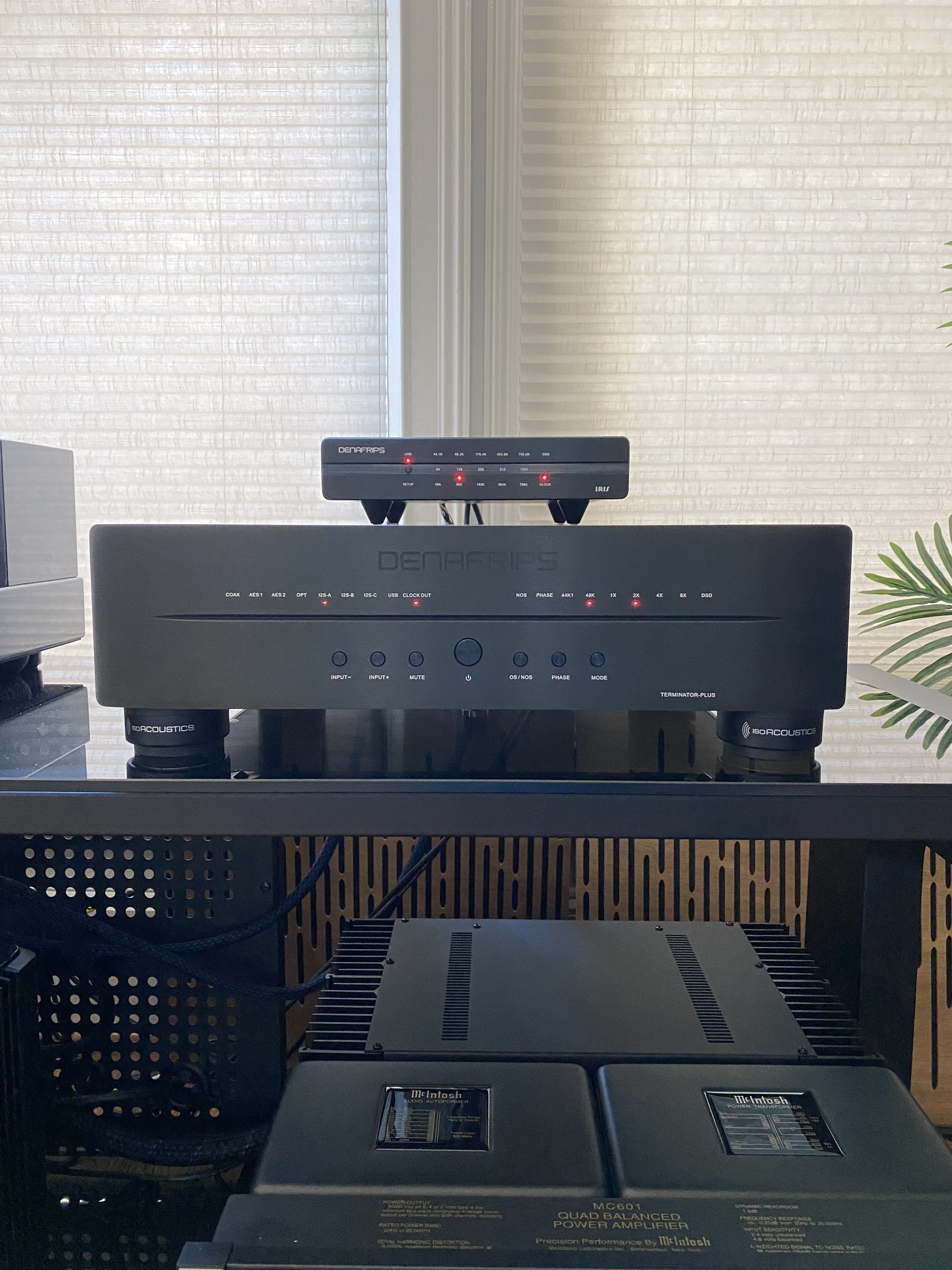

Had it on for a week and thinks it’s cracking. One more question…
Never once have I seen anything other than the “1x” and “44.1k” indicators lit, is that normal?

I do not know what streaming service(s) you are using, but hi-res files light up lights beyond 1x and 44.1k. Similarly, SACDs lights reflect the resolution. Speaking solely as an owner of the Terminator and then Terminator Plus. I do not have first hand experience with your DAC.

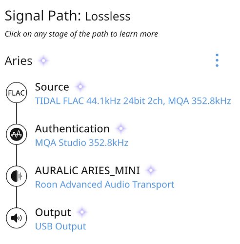

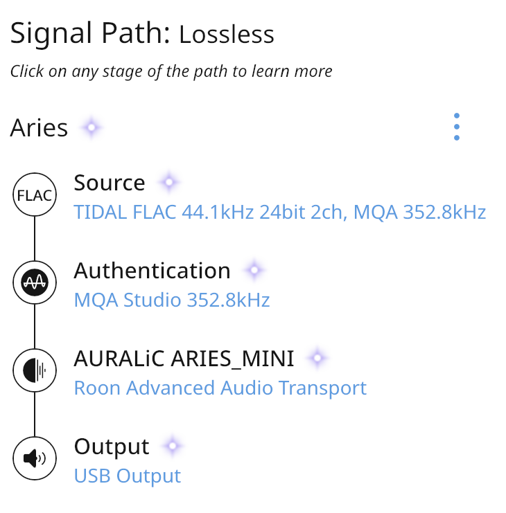

Can anyone advise on “best” settings for the connecting of my Ares II to an Auralic Aries Mini please.
I’ve buggered about with so many settings and configurations I think I need to reset!
This is my current signal path which suggests I’m fine to the Mini, however a lack of change on the lights of the Ares when switching files to hi-res maybe suggests maybe that’s what i need to be looking at.
Set MQA capabilities to No MQA Support, because both your steamer and the DAC do not support official MQA.
Enable MQA Core Encoder.
Thank you, that’s worked!
