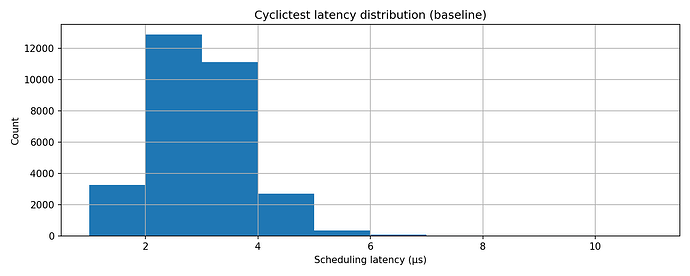

Host OS Scheduling Latency
Host cyclictest results show distribution of scheduling latency clustered at a few microseconds, demonstrating persistent OS wake-up variability.

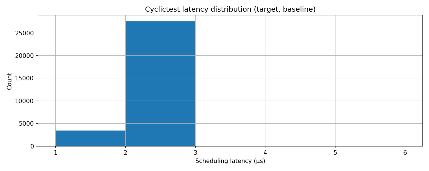

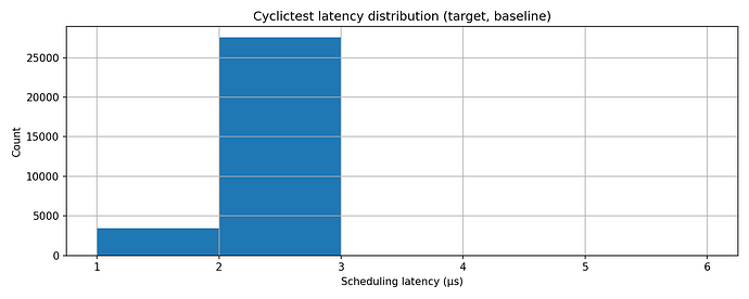

Target OS Scheduling Latency
Target cyclictest results show a tighter latency distribution than the Host, indicating that upstream variability is absorbed before reaching the USB boundary.
The higher number of cyclictest samples on the Target reflects fewer missed or coalesced wakeups due to a calmer execution environment, while the Host’s lower sample count and wider latency spread reflect additional scheduling pressure from network and control activity that Diretta absorbs upstream of USB.

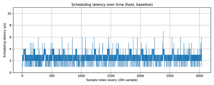

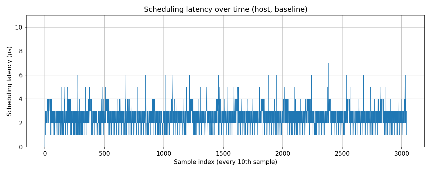

Host Scheduling Latency Over Time
Host scheduling latency varies continuously over time, confirming that timing variability is persistent.
The Host exhibits continuous microsecond-scale scheduling variability over time.

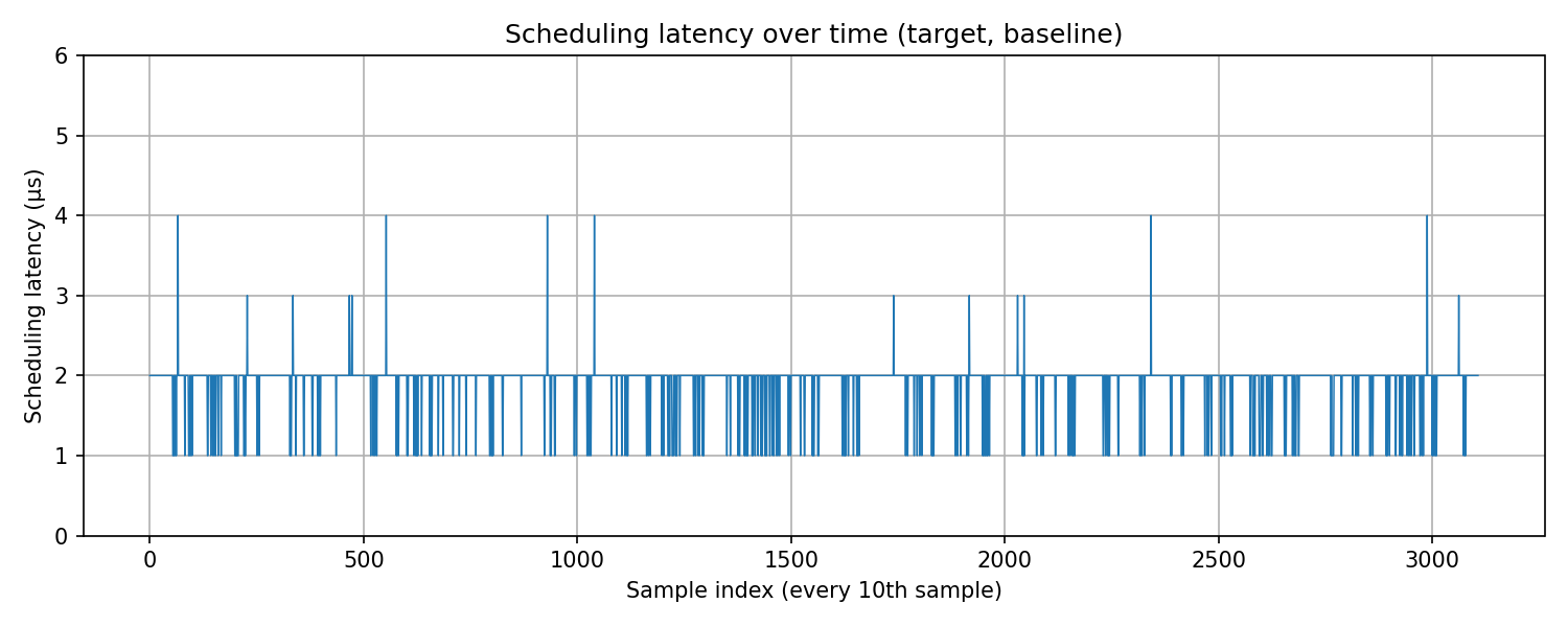

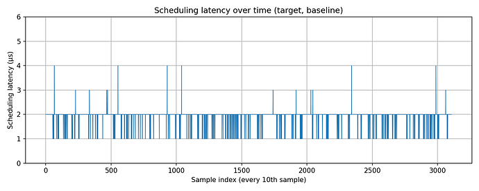

Target Scheduling Latency Over Time
Target scheduling latency remains consistently low during playback, confirming isolation from Host-side variability.
The Target shows consistently low and stable scheduling latency because upstream timing variability has already been absorbed before execution reaches the USB boundary. Even tighter clustering than the Host with fewer excursions often almost a straight line at ~1–2 µs. Because Diretta performs correction upstream, the Target’s scheduler is not asked to absorb bursts, is not reacting to network jitter, is not under timing pressure so its wakeups are more uniform, and more predictable.

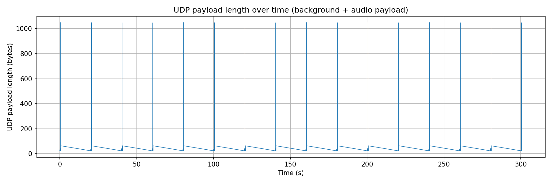

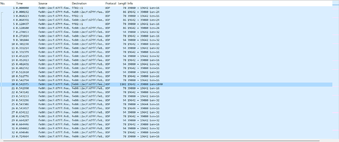

Host Network Packet Inter-Arrival Jitter
On the Host, the UDP traffic splits into two layers: a steady stream of small control packets (24–64B) and periodic large audio payload packets (1048B). The payload packets arrive in short refill bursts with noticeable gaps between them, which is what produces spikes in the inter-arrival plot; the small packets form the low baseline.
The key point is that the audio payload is not sent as a perfectly even stream over the network. Diretta instead uses two asynchronous channels: the payload channel moves audio efficiently in bursts, while the control channel runs continuously to keep the Target’s buffer centered. The Host logs (“Stream Rest …” then “info rcv … fs=…”) match this: the Target reports buffer/timeline state (reflecting ALSA/USB consumption), and the Host makes small pacing and burst-scheduling adjustments so the Target can feed the USB DAC steadily without underruns or buffer swings.

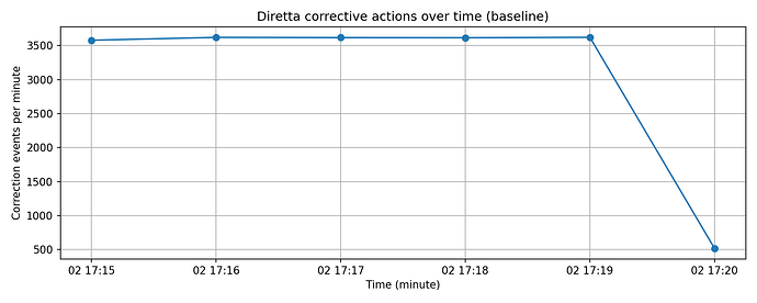

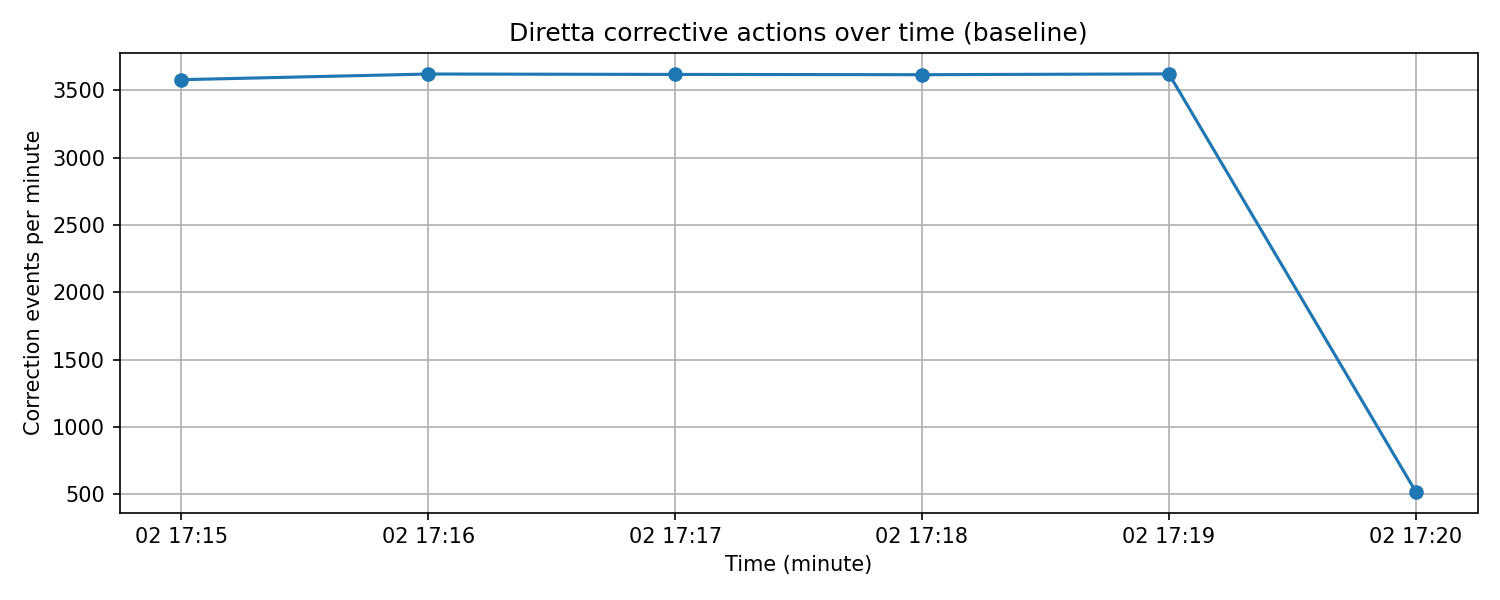

Corrective Actions
Diretta Host performs continuous corrective actions during playback, indicating proactive closed-loop control above the USB layer.
The Target continuously reports stream remainder (buffer/timeline state) while the Host uses that feedback to apply small pacing and refill-timing adjustments (fs micro-changes). This control loop does not eliminate burst payload delivery on the network. It keeps the Target buffer centered so burst arrivals and OS timing variability do not translate into buffer swings at the ALSA/USB boundary. In steady state, the Target’s Stream Rest converges into a narrow band, indicating the controller has locked to a stable operating point while playback remains free of Target-side instability - no xruns / stable ALSA RUNNING.

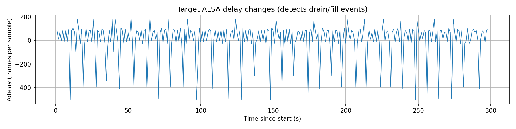

Target ALSA Buffer Behavior During Playback
These figures summarize how the Target’s ALSA playback buffer behaves during steady-state Diretta playback. They are intended to show whether the Target is being fed in a way that keeps the playback queue stable (no underruns, no runaway fill), even though upstream delivery can arrive in bursts.
Buffer refill / drain events over time
Change in ALSA reported delay per 1 Hz sample; large drops/peaks indicate discrete drain/fill transitions.
What this shows:
  • Most samples move in a narrow band, indicating small, continuous adjustments in queued audio.
  • Regular larger negative steps are consistent with periodic buffer refills (the writer catching up after a drain).
  • There is no pattern consistent with an underrun (no prolonged collapse to very low delay).

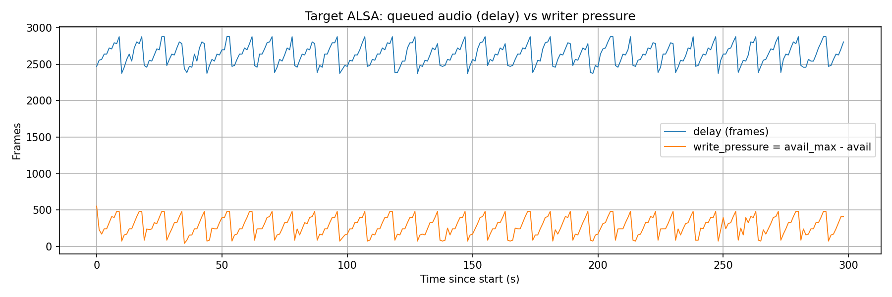

Queued audio vs writer pressure
ALSA delay (queued frames) plotted alongside write pressure (avail_max - avail).
What this shows:
  • Delay shows a repeating pattern: the buffer gradually drains, then is refilled.
  • Write pressure rises as the buffer drains and drops after refills, consistent with normal paced writing into ALSA.
  • The two traces move together in a way that indicates controlled buffering rather than reactive ‘panic’ refills.
ALSA ‘delay’ is the amount of audio already queued for playback (in frames). In stable playback, delay should remain within a controlled band and show regular refill cycles rather than erratic swings or underruns.

  • Diretta corrective actions graph (events over time) showing continuous corrective activity rather than rare recovery.

    These matter a lot because ALSA period scheduling is literally how often Diretta wakes up and moves audio.
  • periodMin=16 / periodMax=32
    period count bounds (or some period parameter bounds). More periods generally = more buffering / fewer underrun risks, but also potentially more latency.
  • periodSizeMin=512 / periodSizeMax=1536
    ALSA period size bounds (frames). Smaller periods = more frequent wakeups and tighter timing demands; larger periods = fewer wakeups, more buffering, potentially less scheduler stress.
  • syncBufferCount=12
    number of internal buffers queued/managed in the Diretta sync layer. Higher can smooth burst input more; too high can increase latency and blur the responsiveness of the control loop.
  • LatencyBuffer=78000
    an internal target buffer depth (possibly in µs or frames). This is a direct how much safety margin do we keep? knob.
  • alsaUnderrun=enable
    control underrun handling strategy (whether to detect/recover in a certain way, log, or change behavior). This doesn’t fix sound directly, but it changes how the system behaves near failure conditions.
Why: These parameters determine whether the Target spends its life in a calm steady state (buffer centered, predictable wakeups) or a reactive one (frequent refills, frequent wakeups, occasional close calls). Even if USB is periodic, the host controller and kernel still schedule work, keeping the system away from edge conditions can reduce incidental activity near playback time.
I suppose you can get to “plausible” at least wrt the sound quality claims. The next step is to convert plausible into tested, conclusive evidence that overcomes the existing, negative measurements and listening results. It is possible that certain DACs are well-served by these changes, which is why I think the Diretta community needs to figure out a testing protocol that demonstrates that there are acoustically relevant results beyond individual, subjective claims bolstered by plausibility.
I would like to hear your thoughts on how to achieve this.
