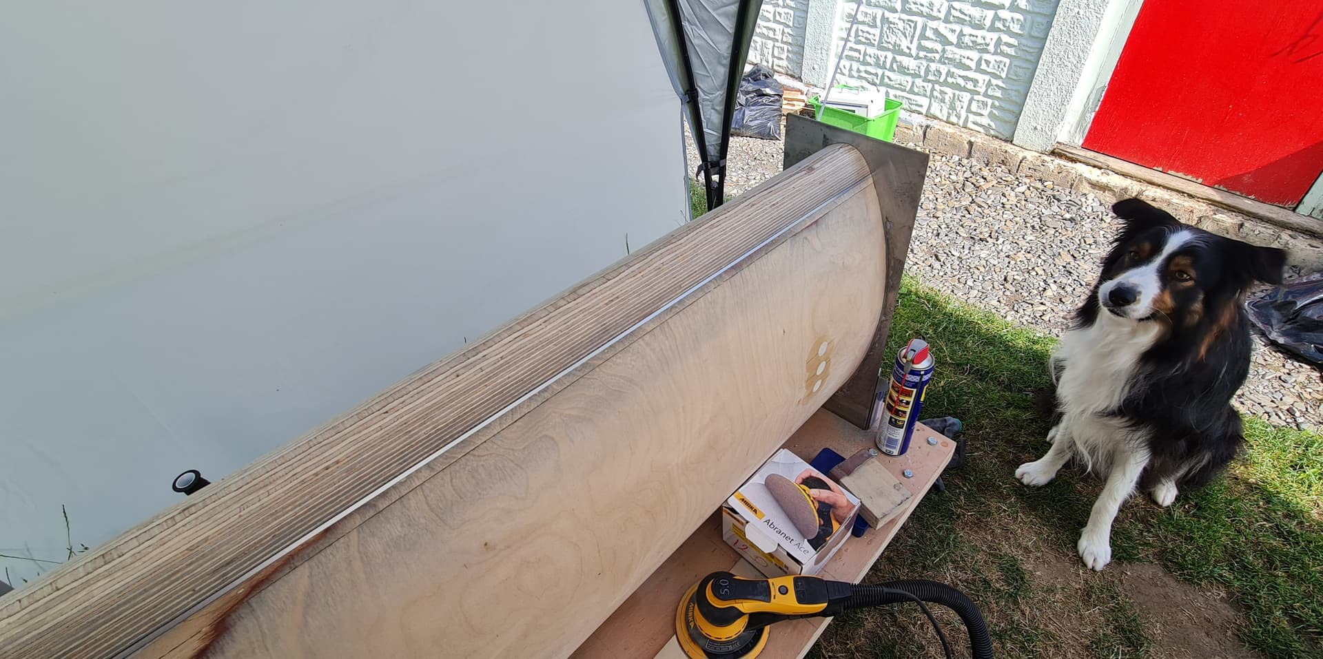

First edge sanded down:
My apprentice keeping a watchful eye as ever:

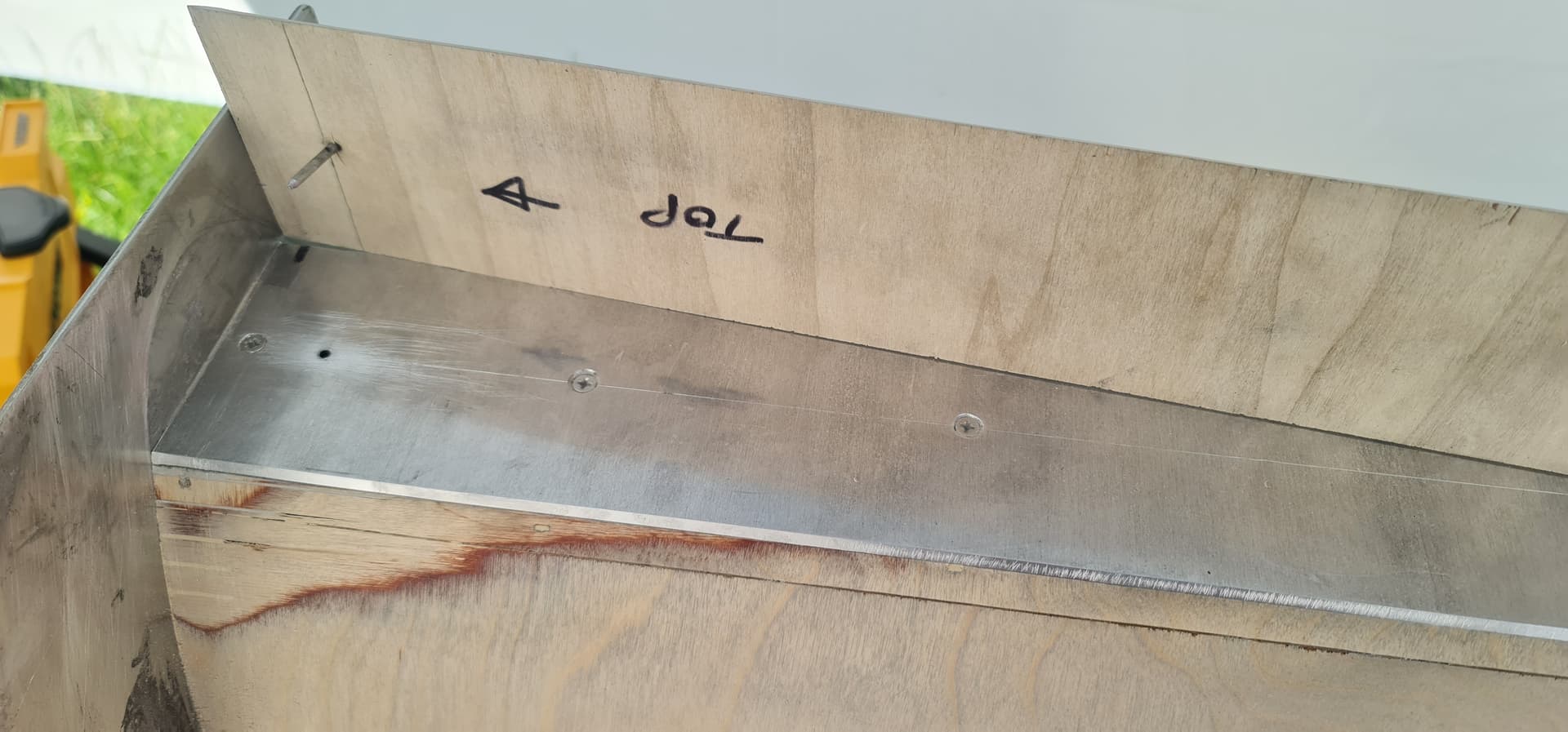

The plywood piece has locating pins to ensure alignment with the aluminium after carbon skinning. Cabinet and end pieces with be skinned separately then glued together with the aluminium sandwich. The aluminium will then be embedded in the intermediate resin coats:

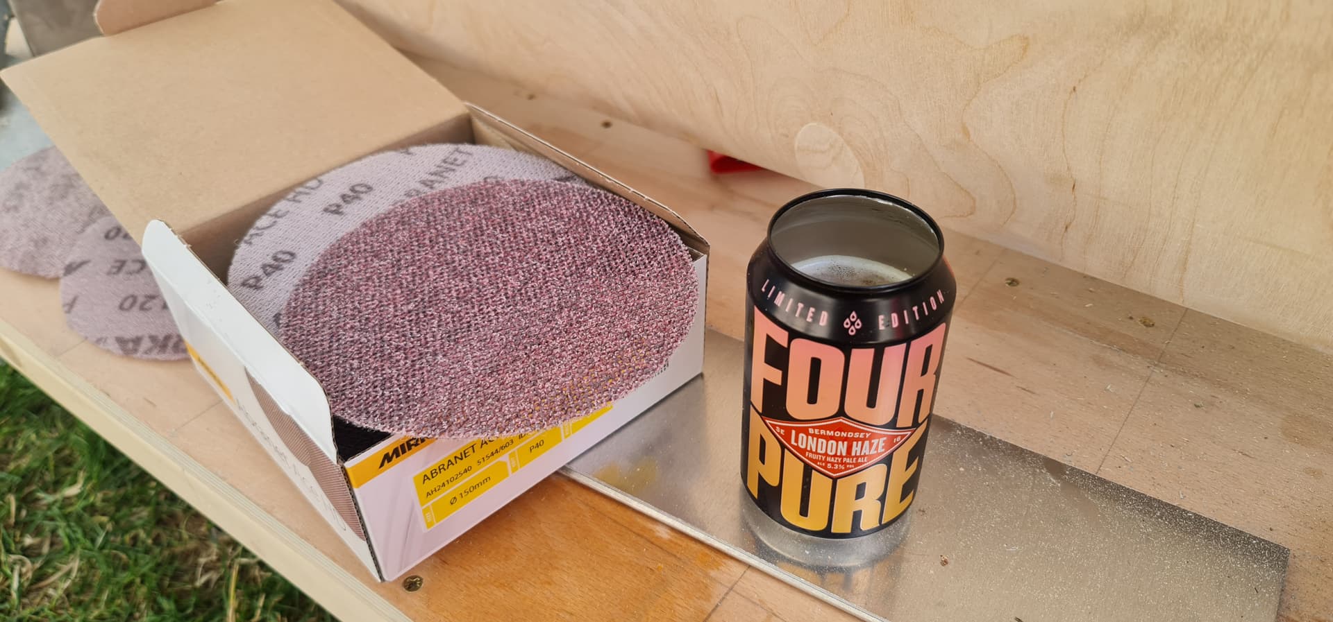

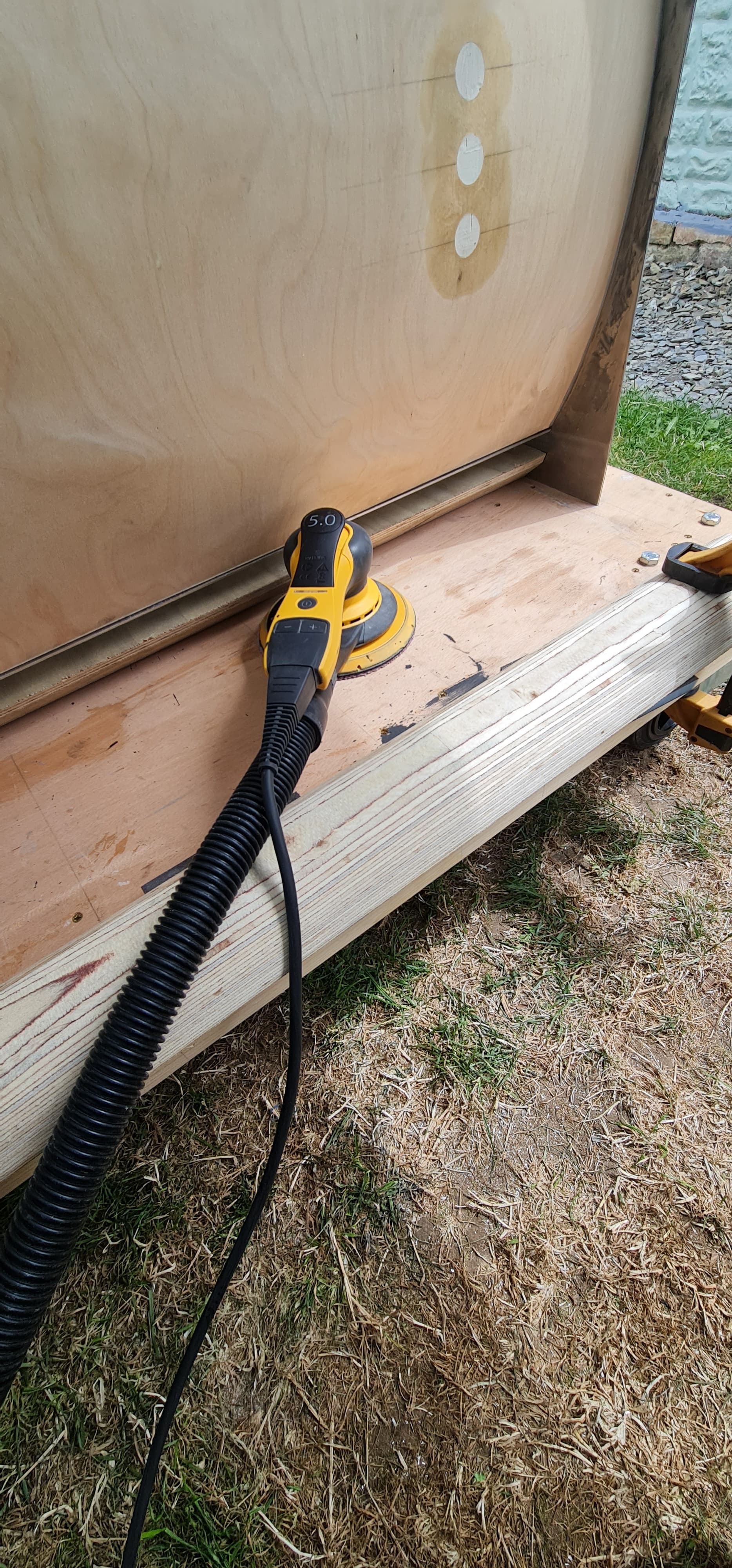

Sanding is much faster now - grabbed some 40 grit Abranet HD sanding discs. Gloves are essential when working with these. The edges are lethal:
Gratuitous inclusion of this afternoon’s ā€œlubricantā€ especially for @Gadnoz_Seek. Cheers Kees!

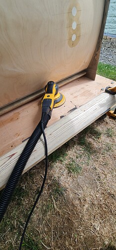

More sanding for the last cabinet end piece. Each piece gets through 2 x 40 grit Mirka Abranet HD sanding pads just to rough out the profile:

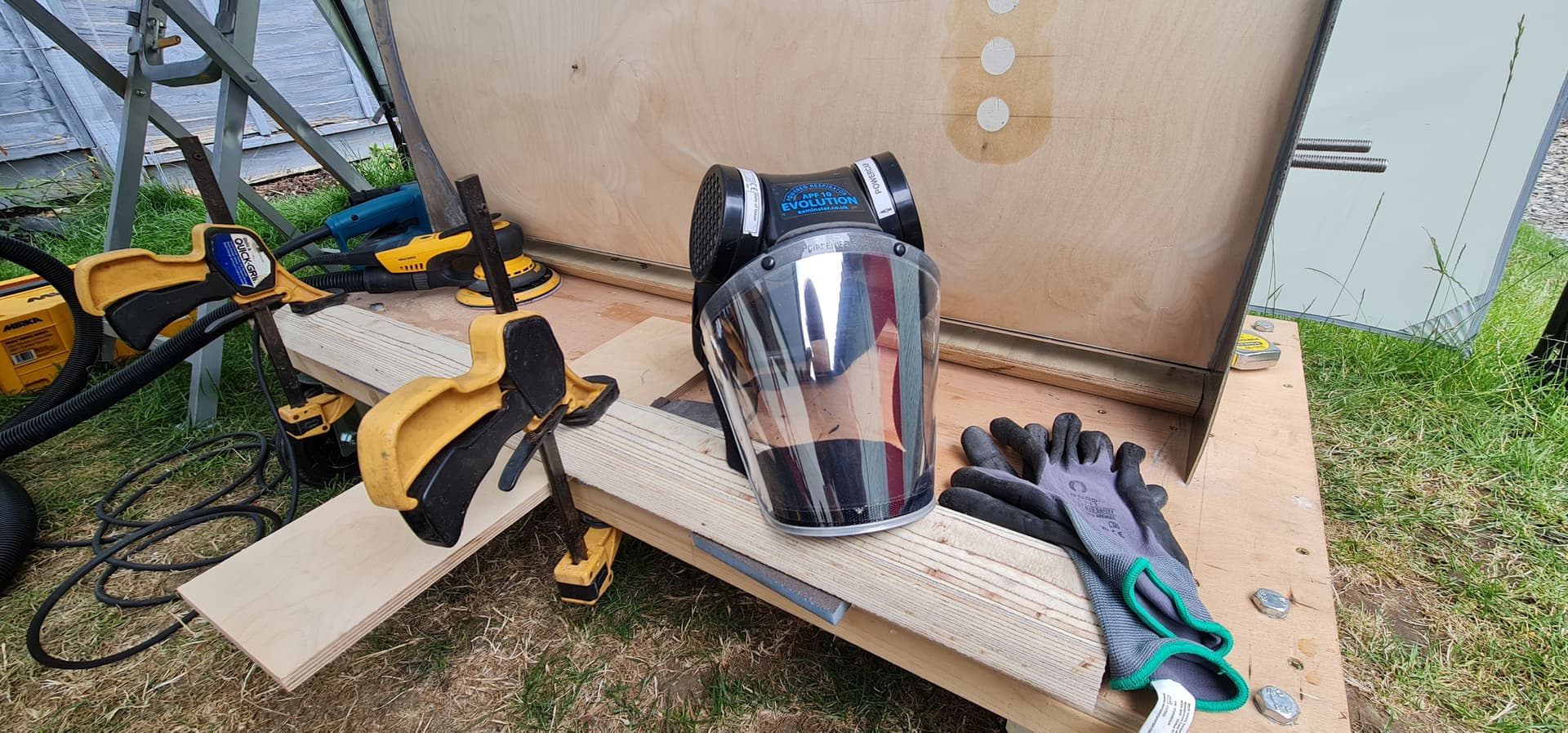

The sander is pretty much dustless on flat surfaces, but on curves, it does throw out a bit of debris, especially with aggressive grits, so I don my trusty powered respirator. Bought this a couple of years ago and it gets used extensively. Rechargeable battery on the back, has replaceable carrtridge filters and disposable visor films.

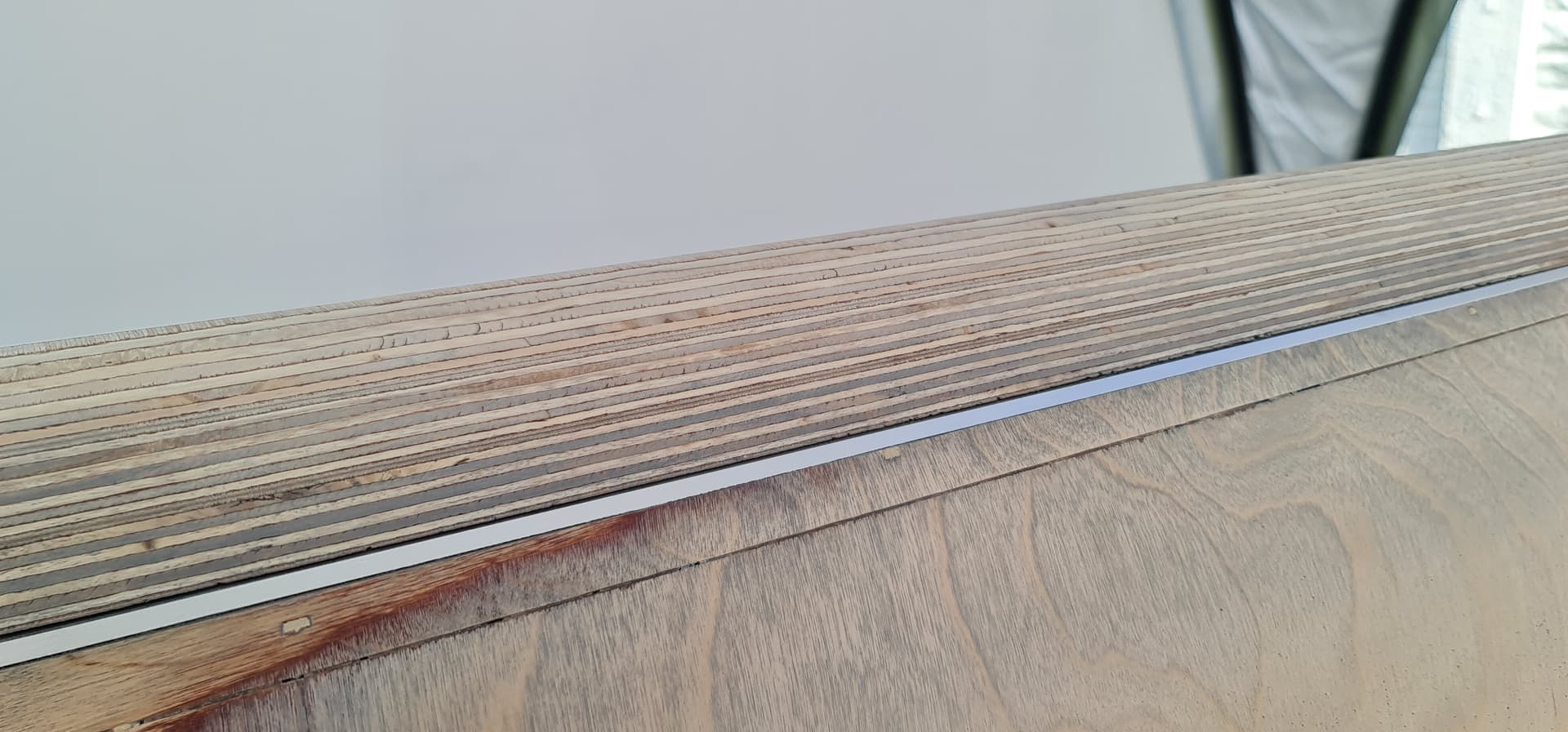

Using plywood for the end pieces has the added bonus of the layers providing a nice contour map to ensure an even curve along the length.

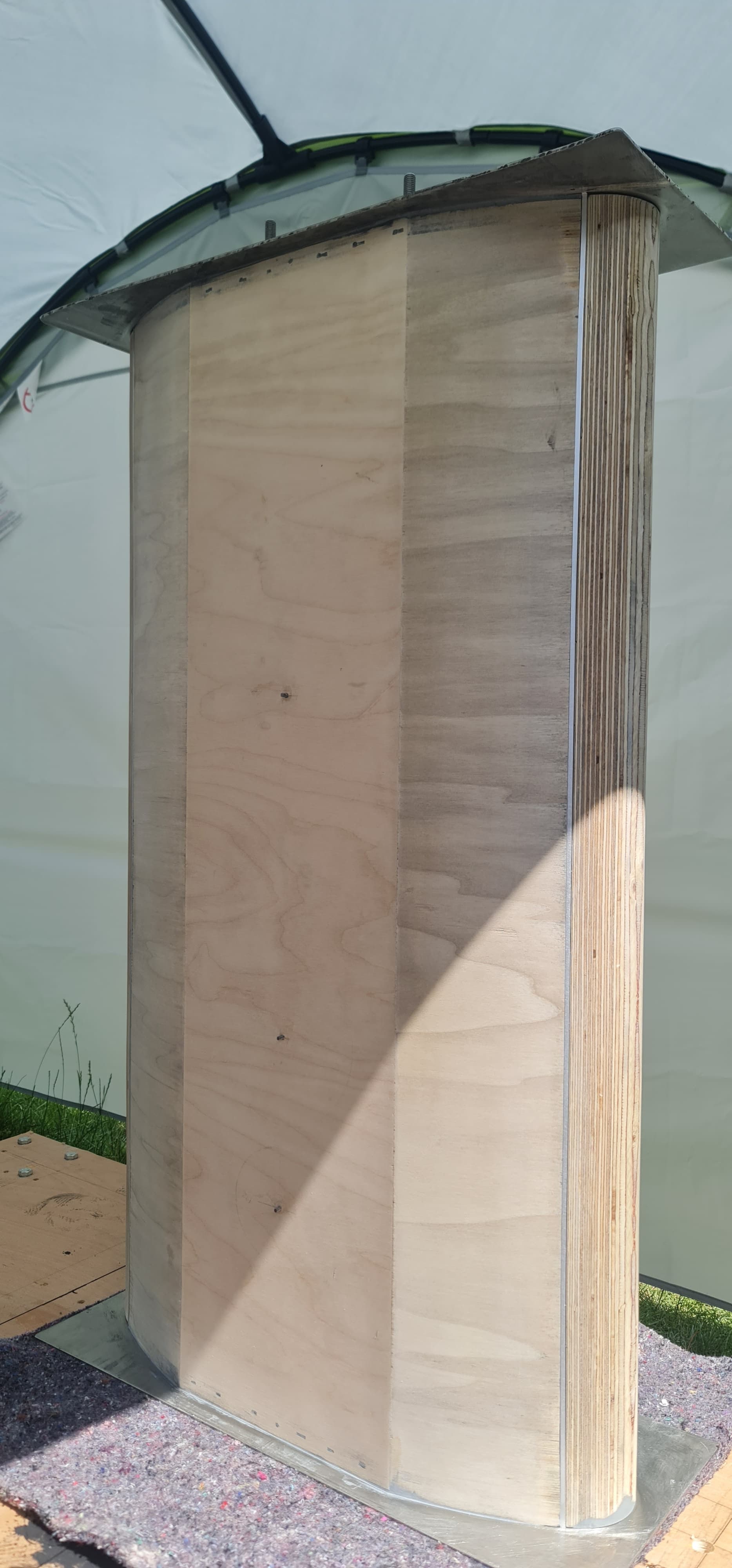

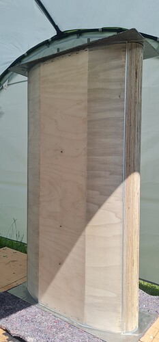

Achieving a seamless blend between the main cabinet, the aluminium fillet and the end cap is a laborious and time-consuming process. 40, 80 and 120 grit, filing of the aluminium and hand sanding the plywood at the ends where the sander can’t reach. Even with a belt sander to rip the excess aluminium back to speed up the process, it was still nearly four hours per edge, ~16 hours for both cabinets.

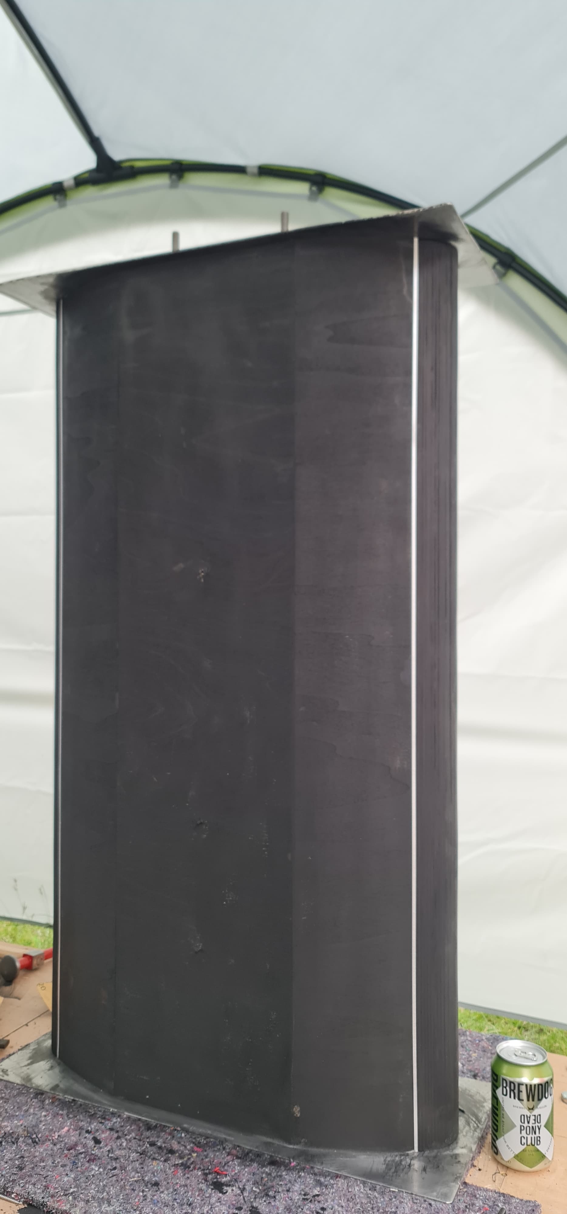

Starting to resemble a speaker cabinet now:

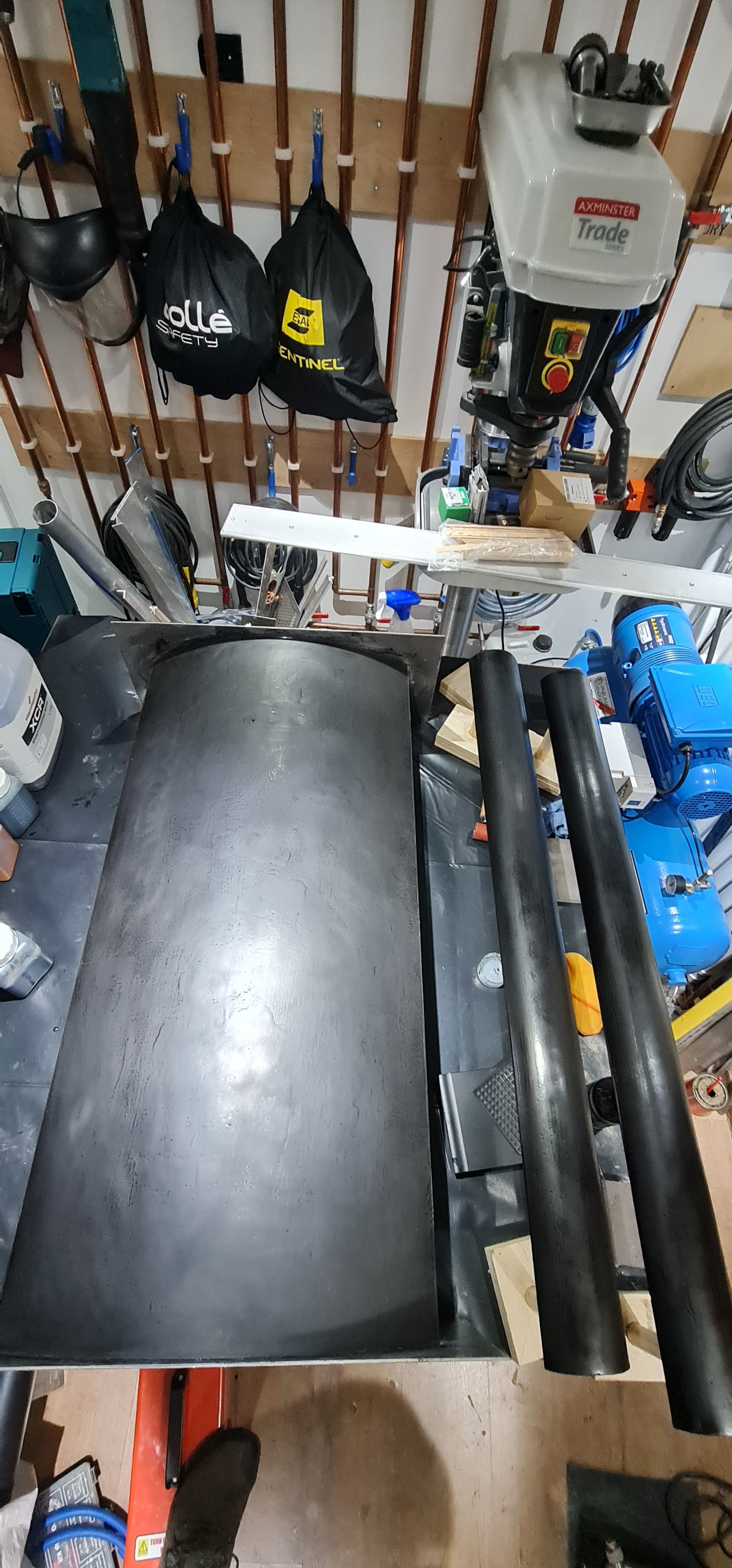

I’m taking a slightly different approach to the cabinets than I did for the xover enclosures. There were a few imperfections due to base layer bleed through and inadequate coverage with the black base coat resin.

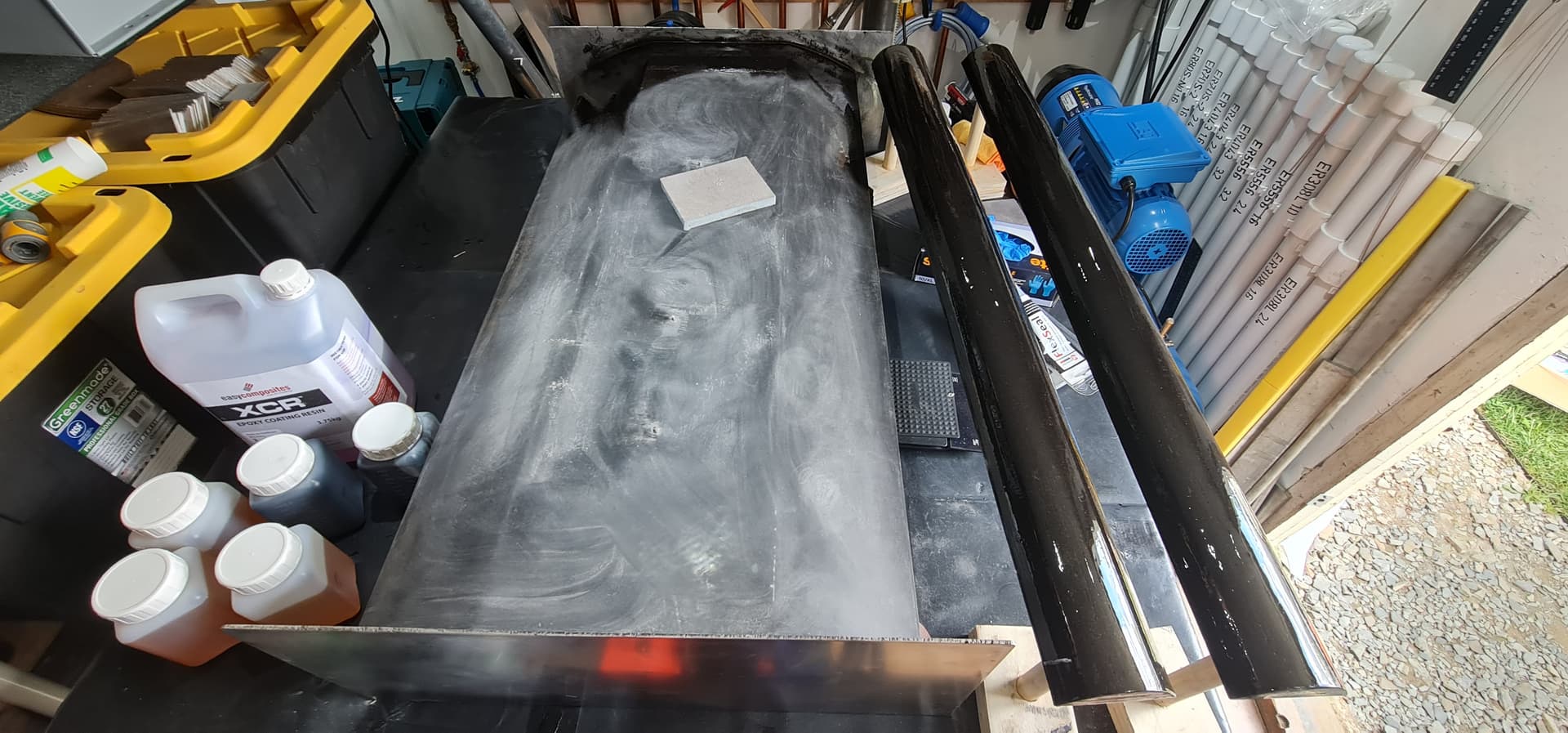

This time, I’m going all out. Black water-based dye coat first:
Next, I’m applying the black base coat, but allowing it to fully cure, followed by keying with 120 grit abrasive:
Cleaned up, ready for a clear ā€œbasecoatā€ to adhere the carbon fibre skin:
This way if there’s any bleed through, it’ll be clear resin and invisible once the wetting out and build coats are applied.

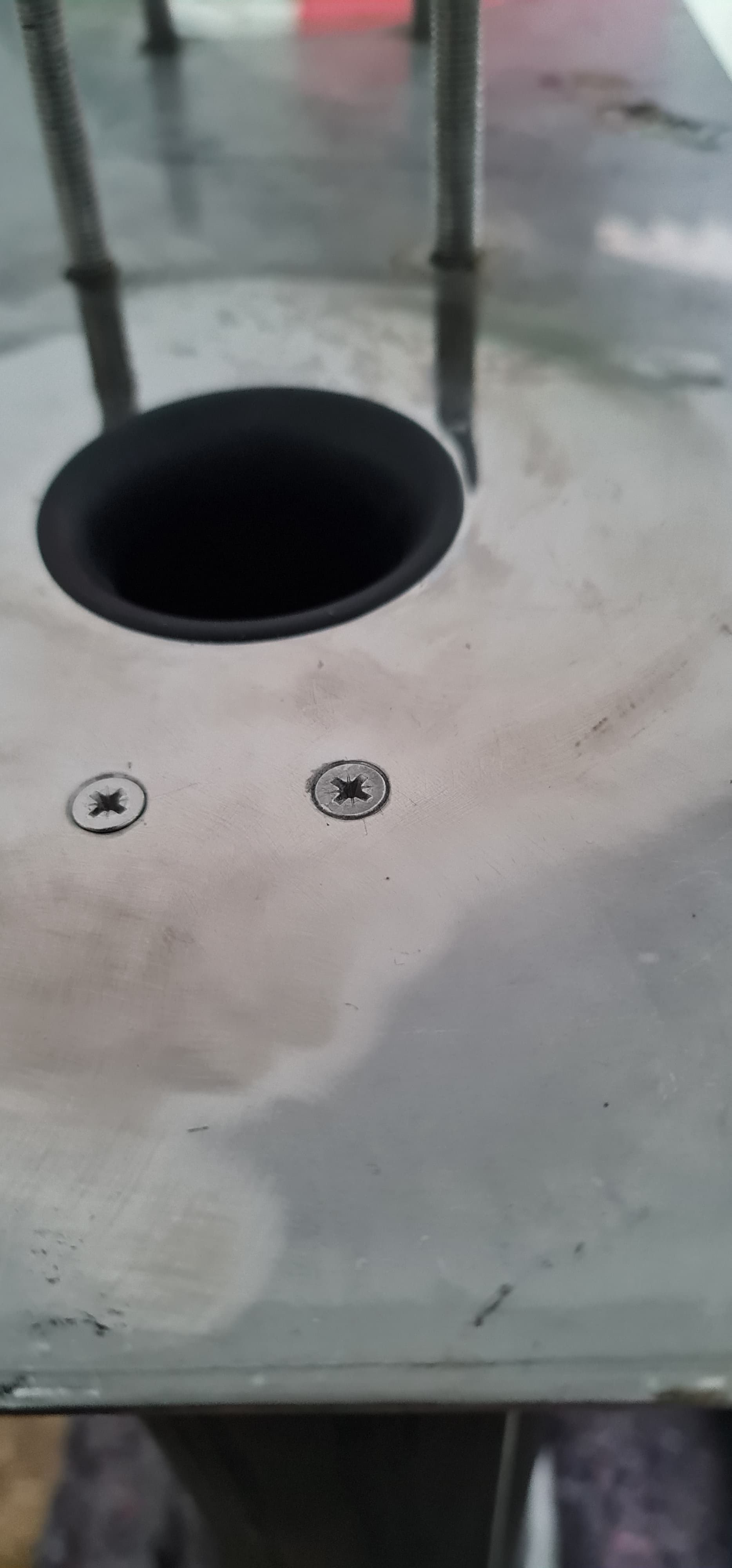

There was a little movement at the edges of the base panels, despite being glued on with polyurethane adhesive, so I’ve added additional stainless screws to tighten everything up:
Drilling stainless and countersinking the holes is easy with a drill press or a suitably anchored mag drill. Drilling it by hand is a whole different ballgame - exerting enough downward pressure on the bit to get it to bite into the stainless is nigh on impossible. Took me 2 hours to drill and countersink 4 holes. :hot_face:
For the second one, I’m breaking out the magdrill! I have a couple of long ratchet straps in the car for the roof bars which should be long enough to tie it down.

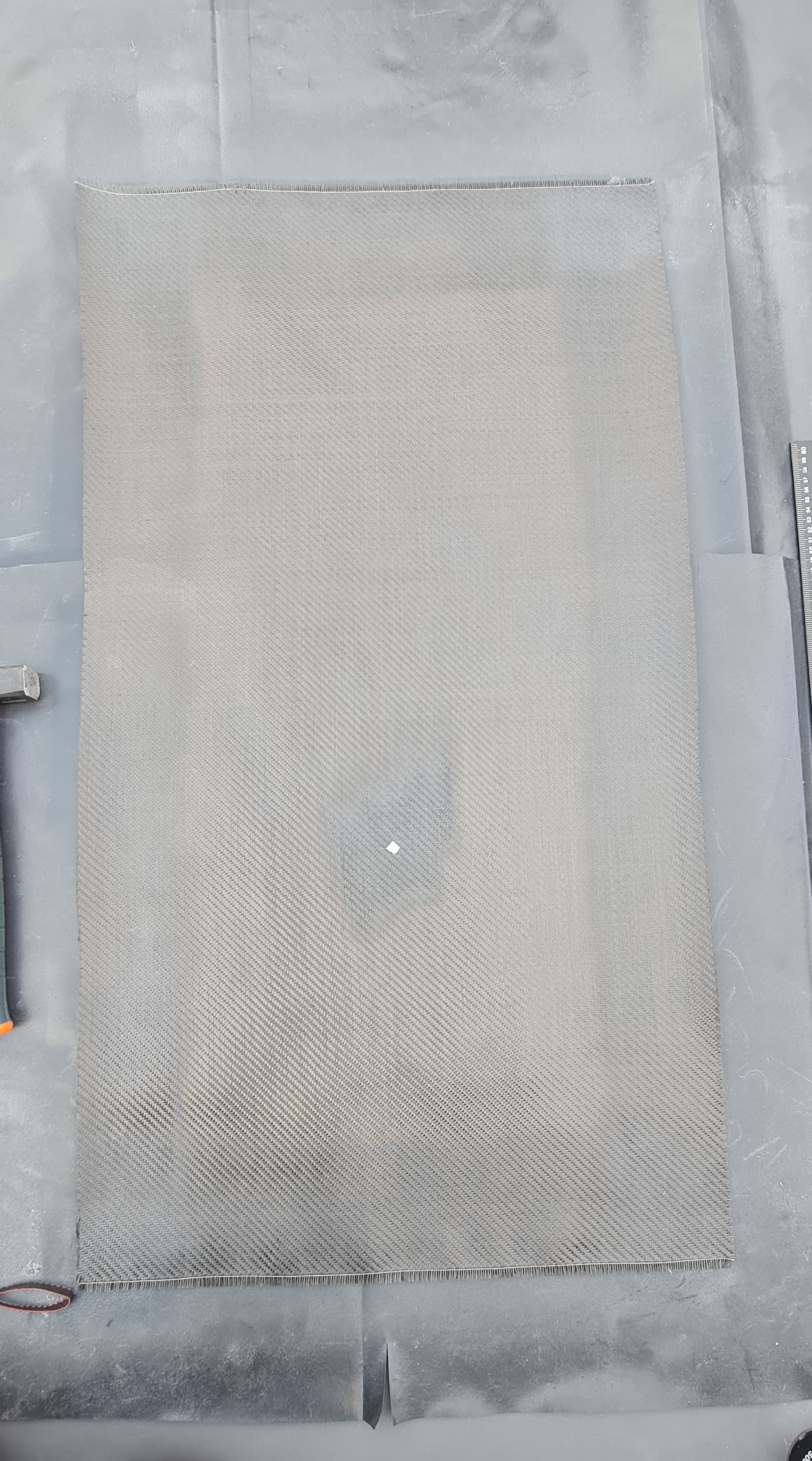

First piece of carbon fibre for the rear of the first cabinet cut, edges bonded ready for final trimming and cutout to fit around the router pin for the midrange port:

Aaaaaand finally…

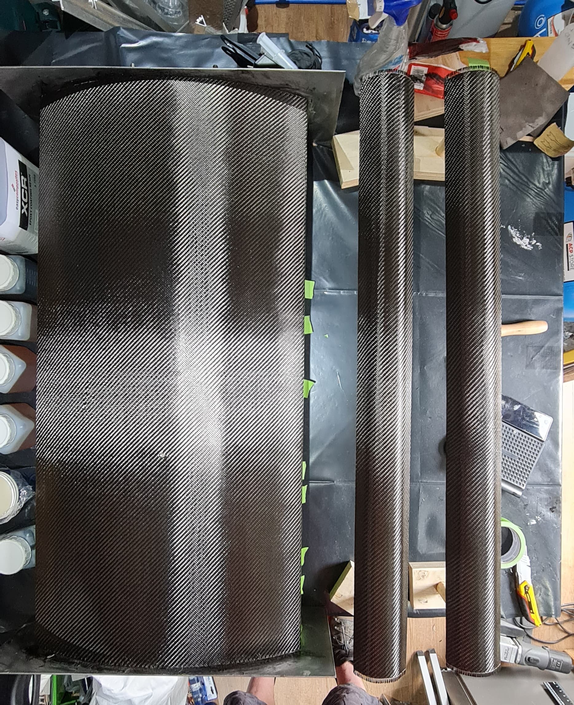

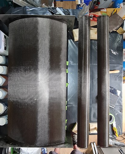

The first pieces of carbon fibre are in place. That was half an hour of intense pressure. Have a very dry mouth from the anxiety of worrying about it all going pear shaped… Need a :beer: now!
