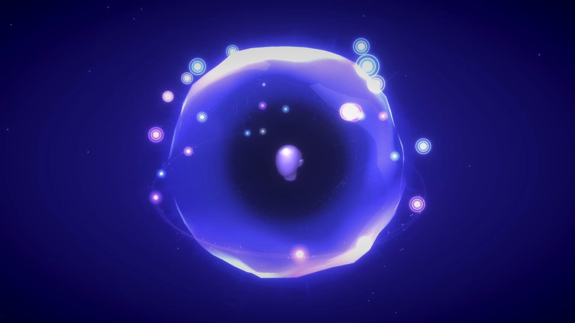

A big feature of Apple’s new HiRes offering is the inclusion of Dolby Atmos. Here is a demonstration of Atmos, designed for headphones, which you can switch between conventional stereo and Atmos. What do you think? Game changer or just some phase manipulation? Can you truly localise sounds in 360 degrees, or is it just a wash of reverb making everything in distinct? Does the visualisation help?
