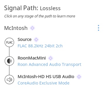

Reviving this thread as I am experiencing dropouts also from 2018 MacMini.
I have purchased a MacMini 2018 with an i7, 32 GB of RAM and 2 TB SSD. All of my music is stored on the Mini. I have the Mini connected to my McIntosh MAC7200 built-in DAC via USB. The Mac is hardwired to my internet router.
It’s worth mentioning that this is my 2nd MacMini. I purchased the stock i5, 8 GB RAM, 256 GB SSD but returned it after deciding to upgrade things a bit. I saw the issue on both Macs.
Everything works very well but I have been experiencing random dropouts. I’ve reduced the MAC to only running ROON core and have removed any upsampling / DSP extras. The dropouts seem to happen randomly but I will get at least one every hour or so. I have experienced dropouts while playing FLAC, DSD files and using Tidal. The capture below shows my path when playing a FLAC file, no upsampling.
Not sure what the next steps should be and would appreciate any advice.
Thank you in advance!
I returned mine and am glad I did (especially after reading your post). Not sure what the problem with the new Mini is; someone mentioned the T2 chip, which seems plausible. I’d be curious to hear from anyone running Roon on a current MacBookPro, which has the same chip.
