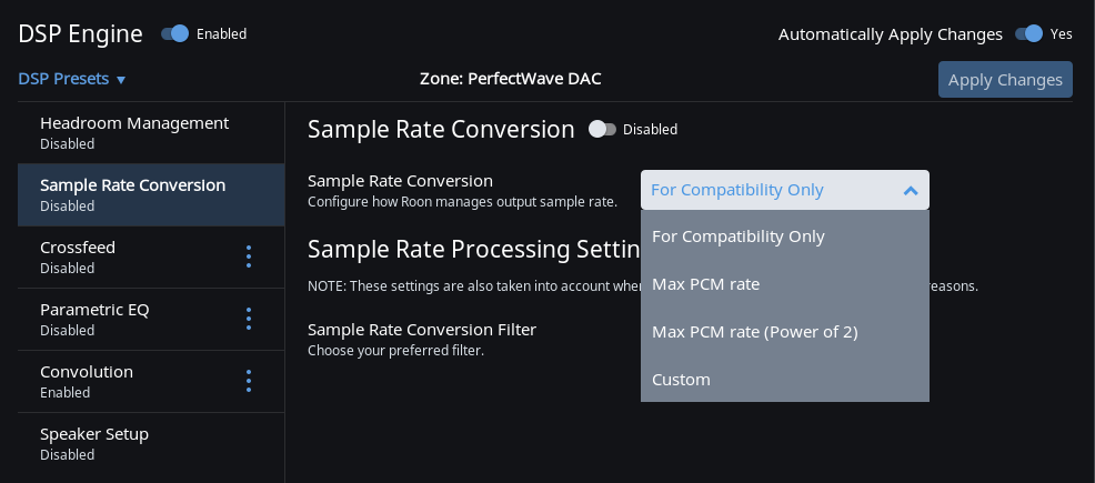

Using a PS Audio PerfectWave DAC:
  1. checking my DSP setup first, you’ll notice that I am seeing the same thing:

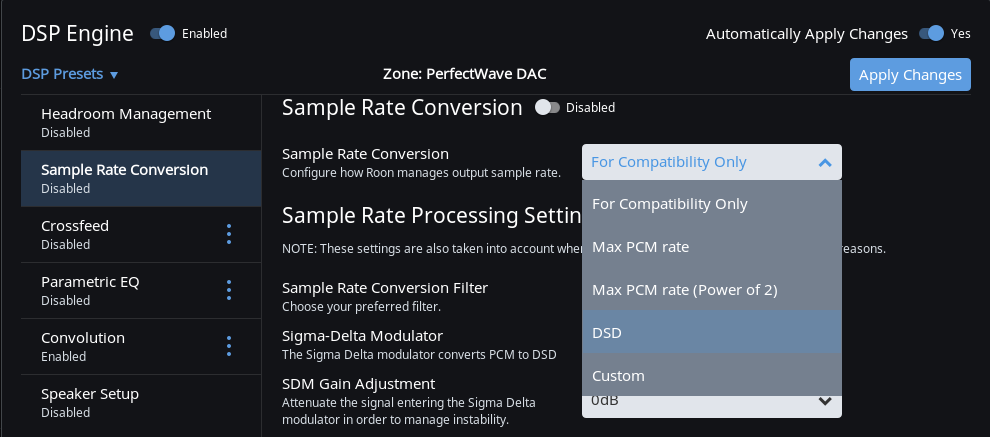

  1. Next, checking my device settings, DSD playback is set to convert to PCM. Which I change to DoP:
  2. Navigating back to my DSP setup, I am given the option for DSD:
