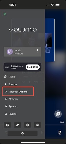

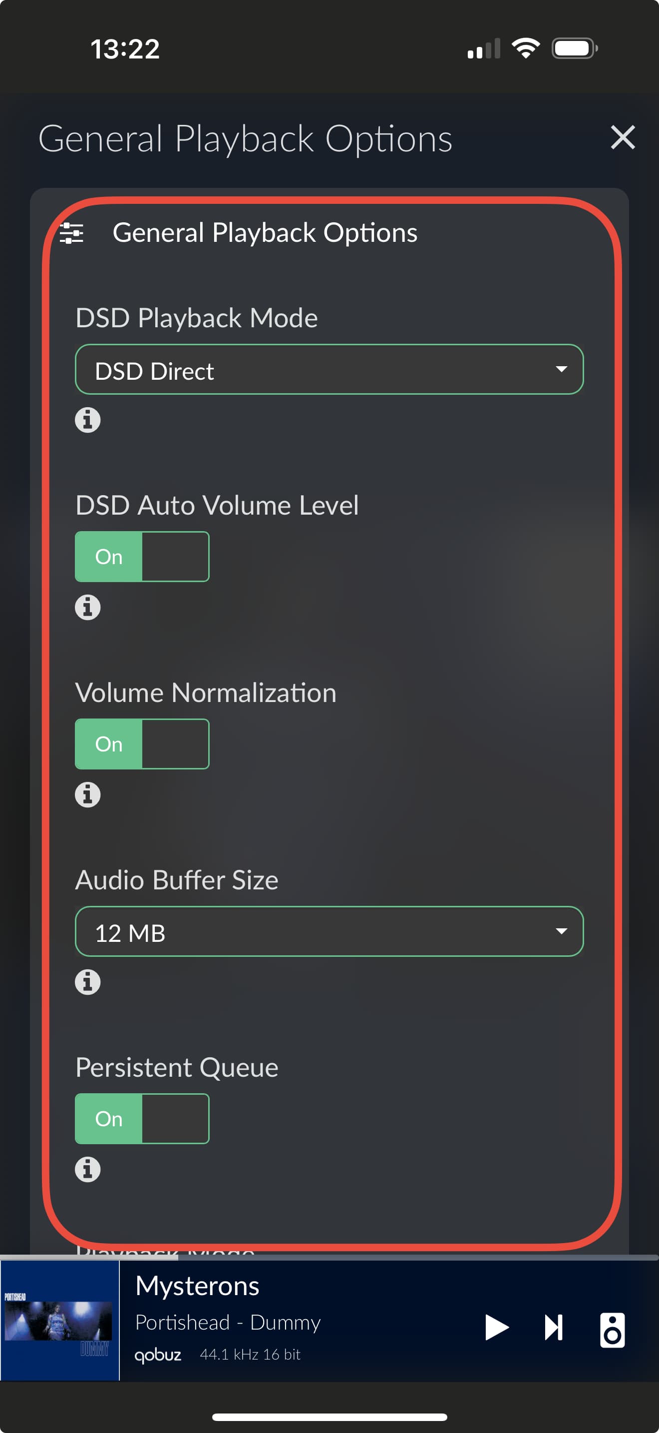

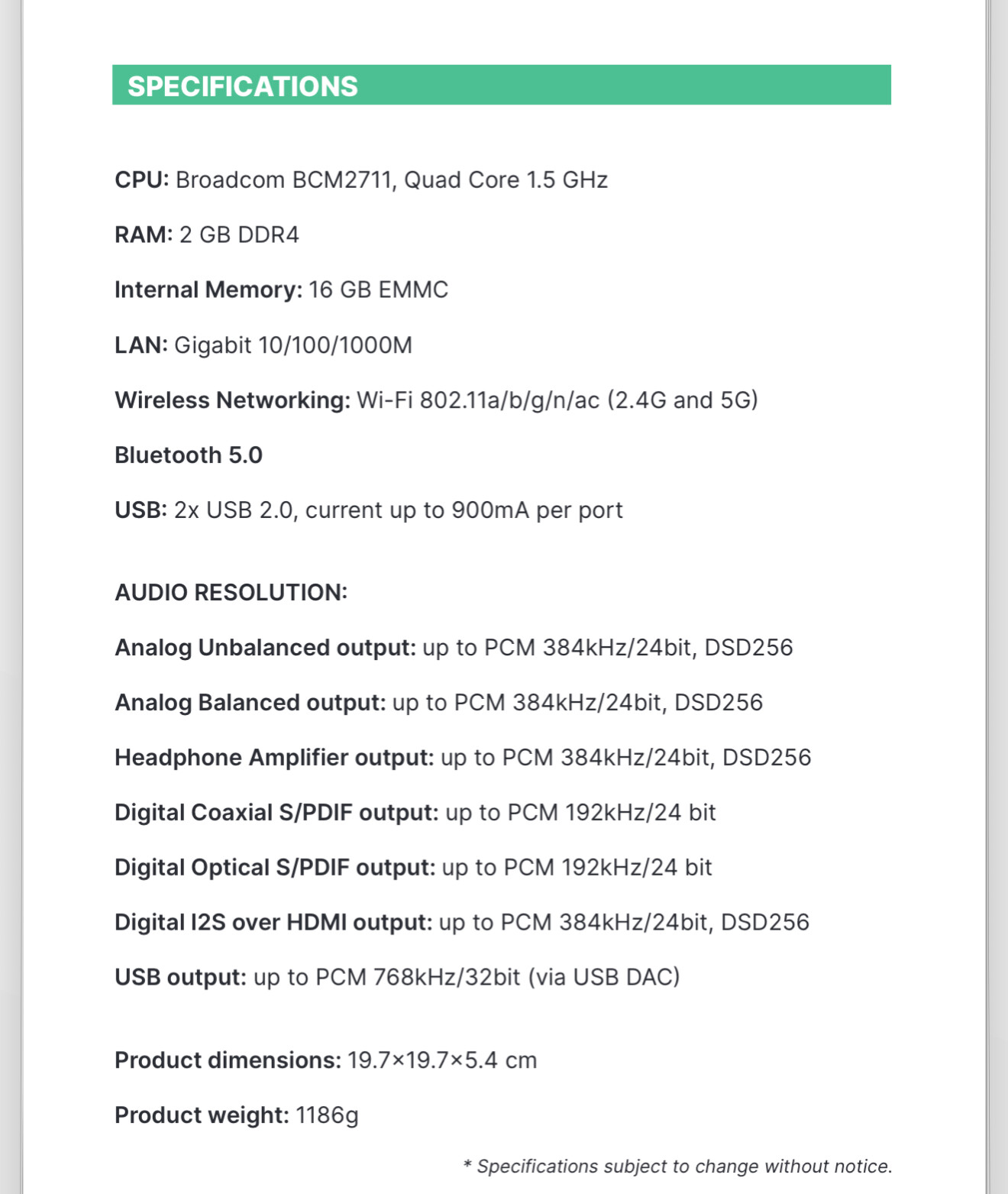

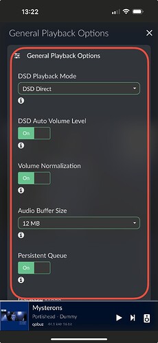

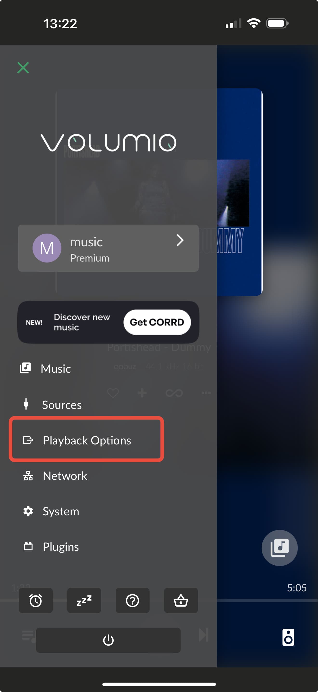

@Alan_Cheung The Motivo supports DSD256 based on Volumio’s data.
Do you have the below settings page?
Note: I’m using a RPi4 with VolumioOS.
The Motivo uses the RPi CM4.
Via the Roon Bridge plugin (acknowledged, not Roon Ready) I achieve Native DSD and DoP.
Via the Squeezelite plugin I achieve DoP. Have you tried this.
Via UPnP with Audirvana I achieve Native DSD and DoP.

The settings on my RPi with VolunioOS by default had Native DSD set, but this is for Volumio’s music player and not Roon Bridge.

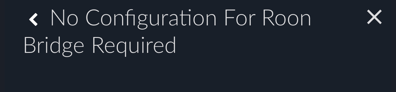

Here is my RPi running Volumio with Roon Bridge enabled.
No settings available for Roon Bridge
By default it’s enabled for Native DSD under the playback strategy options, up to DSD256 based on my DAC.
The Motivo AFAIK, runs the same version of Volumio but with Roon Ready installed.

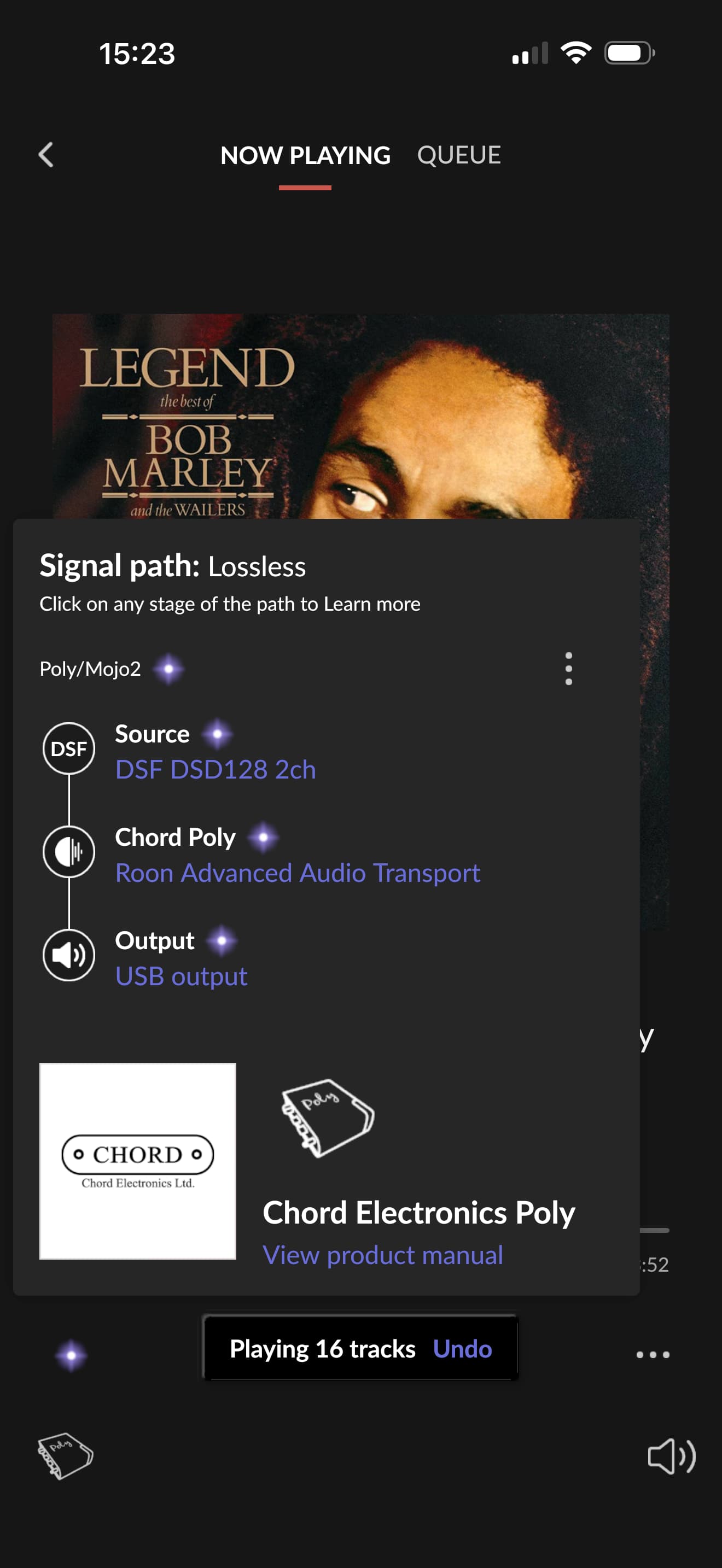

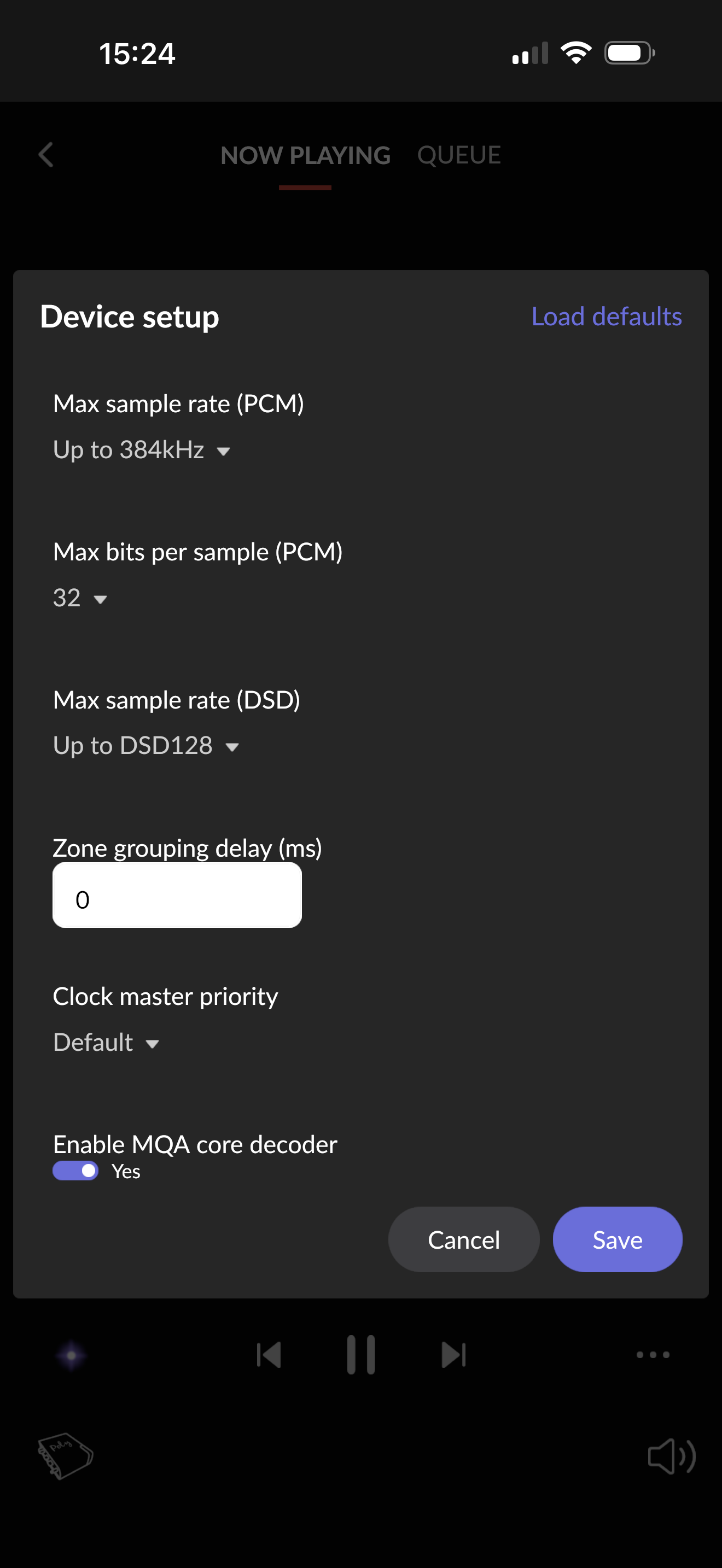

(My Chord Poly/Mojo2 which is Roon Ready supports up to DSD128 but the playback strategy menu is missing :man_shrugging:)
Use GoFigure, check that DSD / bit-perfect playback is active (disables volume control) and then look-up the setting options in Roon again.
Last post from me here as I’ve derailed thread enough.
Thanks @BlackJack I’m aware of this :wink:
I’m saying the options menus for DSD playback strategy are missing. I still have DSD playback.
The point being made is that Roon Ready devices with similar support don’t give the same options within Roon’s endpoint settings.

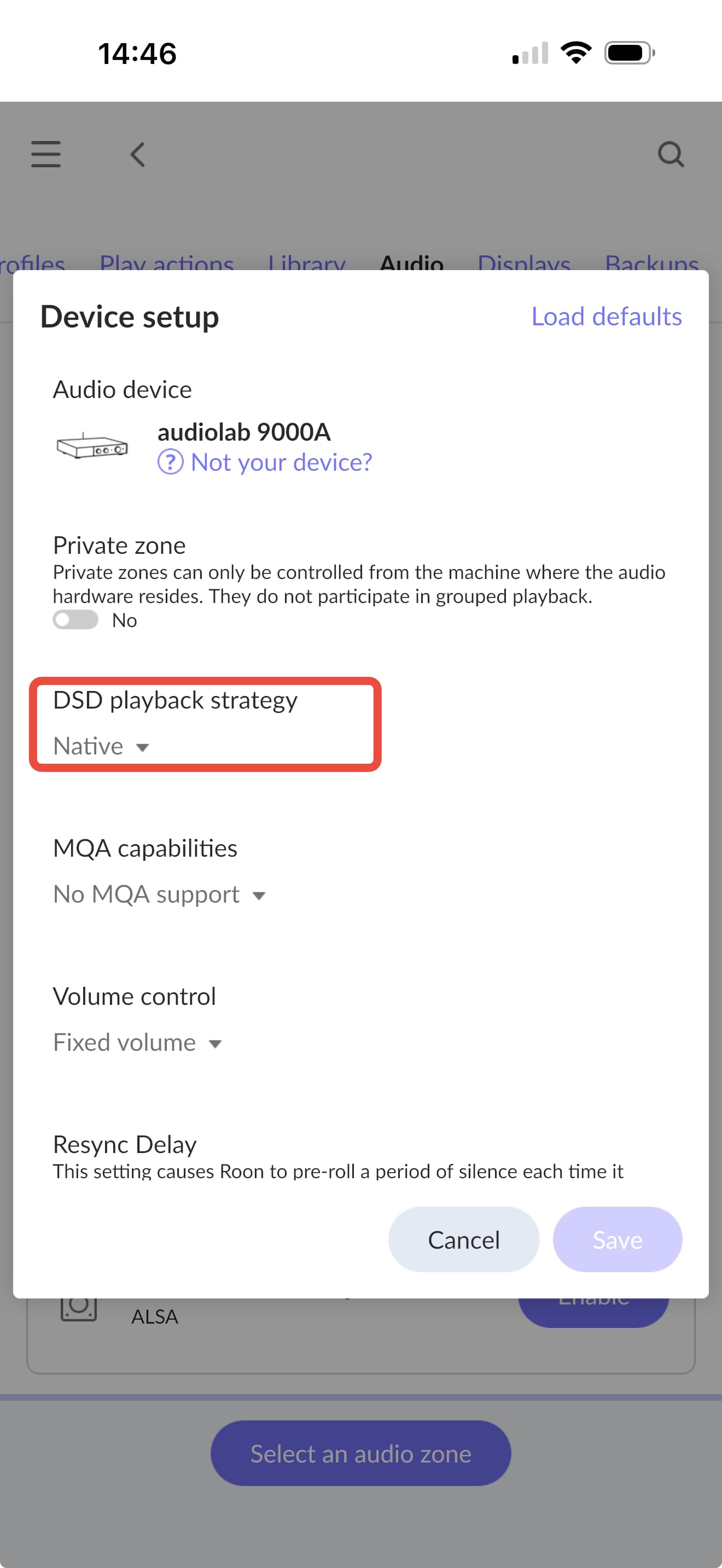

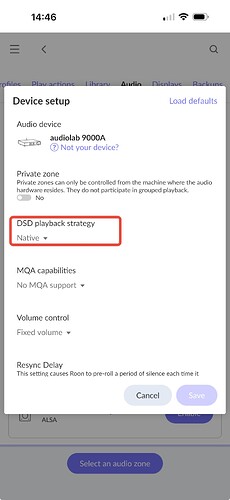

Just checked myself. It is not there. I also remembered why. Roon is not presenting pointless options. You can’t choose DSD Playback strategy because only DoP is supported.
PS: There is also no option (shown) to choose exclusive mode – unless there is actually a choice to make.
Maybe, maybe not? If Roon Support says so, it is likely that way. The Poly example shows on the other hand that settings on an endpoint can very well influence the available options in Roon.
  • You can’t see/choose the max sample rate for DSD in Roon if the option for DSD / bit-perfect playback in Poly is disabled.
  • You can use volume control in Roon if DSD / bit-perfect playback in Poly is disabled.
IDK Volumio though, so I don’t know if there are settings that may influence the reporting of DSD capabilities like the DSD / bit-perfect setting on the Poly does. From other threads here I know that other streamer often have volume control settings that need to be turned off for DSD to work with Roon.

If I set the Volumio to DoP within the VolumioOS settings, Roon still plays Native DSD as it is set to do so Via Roon > Roon Bridge endpoint audio settings.

@Alan_Cheung How is the Motivo connected into your system?
Is it the USB out to an external DAC? This may not actually support DSD based on the manual for the Motivo.
Balanced and unbalanced outputs support DSD output, meaning using the internal DAC.
But if the DAC supports DSD, then DoP should work.
