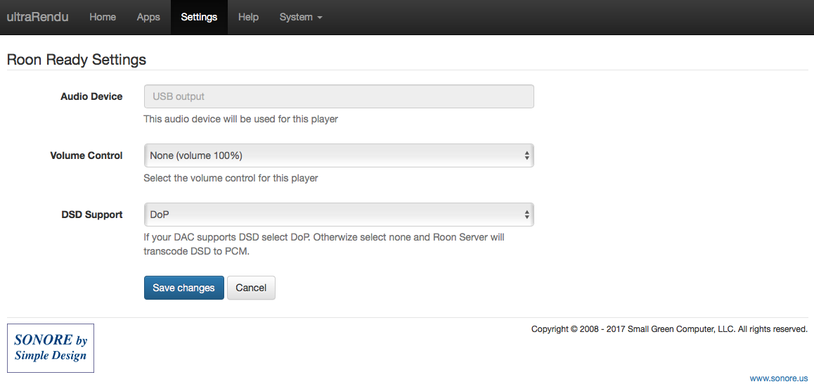

Question, I am taking USB out from my Sonore UltraRendu then to my LKS MH-DA004 DAC. ROON allows me the upsampling choice of DSD64 & DSD 128. If I take the USB out from my UltraRendu and feed it into my Ultradigital, then out i2s to the LKS, Roon offers me the options of DSD64, 128 and 256 upsampling.
My DAC can do DSD512, but no option is shown. Does Roon only allow selections of what the core is safely capable of, or is it picking it up from Rendu/DAC?
Do I need to clear a setting somewhere? My core is a Sonictransporter I5. Just want to know what is ultimately needed if I really wanted to upsample to 512 without filters to a single endpoint
I updated the firmware on the Amanero board, still don’t have the ability to see the option for selecting DSD512. Any suggestions as to what I am missing? Does Roon limit the options to the ability of the Core?
