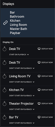

@dylan It just happened again. I think all I did was add a zone to an existing group. Here’s a screenshot.
Hi @darqman,
Does this occur every time that you add a zone to the group?
Do you see these duplicated in Settings > Display now too?
What type of Chromecast device are you using?
@dylan I’m using a mix of gen 2 and gen 3 chromecasts. I’m going to be adding a 3rd gen 4k one to the mix this weekend. I haven’t spotted a pattern but it’s getting worse and is even more annoying than before, view entire screenshot attached and you’ll see what I mean. I have to click “display now” on everyone because I don’t know which dup is the “real” one. It’s a major pain to reboot them because none of my TV’s are easy to access. I’m a bachelor and my home is setup in a sports bar atmosphere with open areas and TVs up high. I wish we could figure this out.
