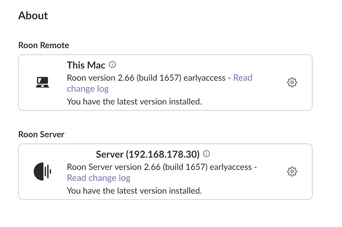

@Stephen give me sign when i can test the hotfix
still standing by on 2.64 ![]()
Update 2.65 –> 2.66 succeeded ![]()
On QNAP I can confirm the update to 2.66 now works from a remote.

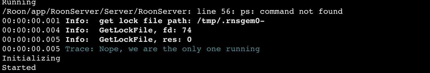

@Stephen there is an error message though. It does not affect the update:
The same error message in my case also.
Yes
Working here as well
Just upgraded automatic from 2.64 on qnap docker to 2.66!

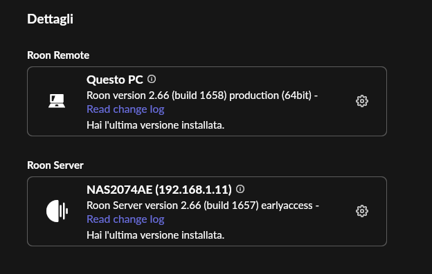

I think I finally understood what was going on with my QNAP Docker installation, so I’m posting this in case it helps someone else.
I’m running Roon Server in Docker on a QNAP TS-453Be. The server was working fine on Roon Server 2.64, but every attempt to update to 2.65 failed. Roon could see the update, download it, start the installation, and then fail.
At first I suspected almost everything: permissions, read-only mounts, Docker Compose, QNAP Container Station, backup paths, etc.
My old /Roon folder was mounted like this:
/share/Multimedia/RoonOnNAS:/Roon
That folder already contained the previous Roon installation, database, settings and application state.
In the end, the fix was not to keep trying to update that existing installation. I created a completely new folder and used it as /Roon:
/share/Multimedia/RoonFresh:/Roon
My compose file is now:
services:
roonserver:
image: ghcr.io/roonlabs/roonserver:latest
container_name: roonserver
network_mode: host
environment:
- ROON_INSTALL_BRANCH=earlyaccess
- TZ=Europe/Rome
volumes:
- /share/Multimedia/RoonFresh:/Roon
- /share/Musica:/Music
- /share/Multimedia/RoonBackups:/RoonBackups
restart: unless-stopped
logging:
driver: local
After starting from the clean /Roon folder, Roon installed correctly. I then restored my library from a valid backup.
The key point for me was this: in Docker, /Roon is not just the database folder. It also contains the Roon installation state. So if something inside that folder becomes inconsistent after a failed update, recreating the container or pulling the image may not be enough, because the problematic state is still inside the mounted /Roon volume.
Once I moved to a fresh /Roon folder, everything behaved normally again.
Interestingly, after that clean installation, even in-app updates started working correctly again. Note the YAML text: I temporarily switched to Early Access and the server updated successfully from within Roon itself.
My practical recommendation for QNAP Docker users with failed updates would be:
Don’t keep retrying the same failed update.
Create a new clean
/Roonfolder. -
Recreate the container using that new folder.
Restore from a proper Roon backup.
Keep backups outside the
/Roonfolder.
This solved the issue completely for me.
