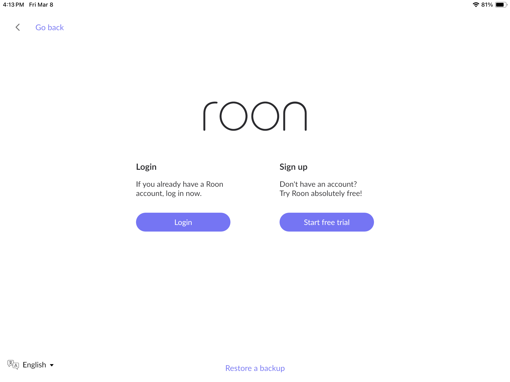

I can't log into the Roon app
I am in an endless loop when I try to log in. A pop up box appears to enter my id and password. Once I enter the correct info, I’m taken back to the log in page. If I press the “go back” arrow at the top of the page, I see my server listed and press “connect” at which time I’m taken back to the login page. Endless loop. This just happened after the last software update. Incredibly frustrating!

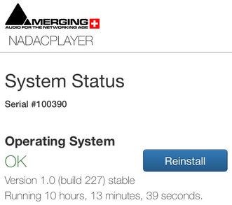

This is an image of the totality of what I can see about my server.
It is best if you wait for a fixed firmware from Merging. That said, its hard to believe you don’t have access as it is supposed to run Roon OS. Did you try:
Important: The fix posted above is meant for unsupported/unmaintained systems running an outdated OS. It will not fix the root cause of the issue. Your Merging product is not unsupported or unmaintained though – please check if there is a firmware update available already and if not, ask Merging about one.
PS: Current upstream Roon OS is on build 259; your Merging supplied Roon OS on your device is build 227 only:
grafik
Blackjack - you are correct, I do have access using the method in the article you attached. Thank you. I will contact Merging and see if they can fix this for me; if not, would it be safe for me to use the methods outlined in fix for unsupported products?
Sadly Roon Labs did not share more information about their fix as are given in the article linked already. Applying the fix may resolve the issue for now but I can’t predict its impact on your system in the future (it may stop working again at some point because of the fix in place). As I already wrote, it’s best to let Merging fix the root cause IMHO.
Sure but this route may take a while. What does the manual to your product say about firmware upgrades? Does your device not have a built-in menu to check/initiate a firmware upgrade? What happens if you click on the “Reinstall” button from the screenshot above?

  1. clicking the reinstall button reinstalls the same version of the OS - build 227
