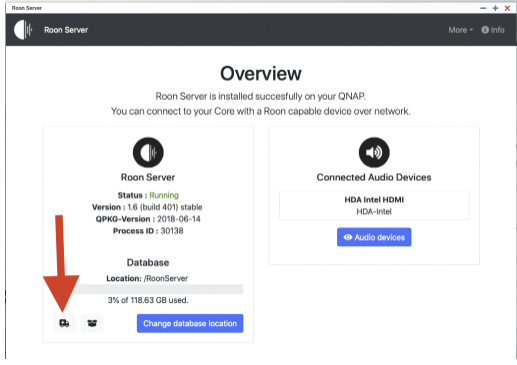

Thanks for the update. For a next step, we’ll need to investigate your NAS logs. Specifically, there is a file included in the Roon log package called RoonOnNAS.log.txt.
You can use the directions found here, or can download your logs by clicking the "Ambulance " button:
Screen Shot 2023-09-13 at 9.13.34 AM
And send over a set of logs to our File Uploader.
Thanks so much!

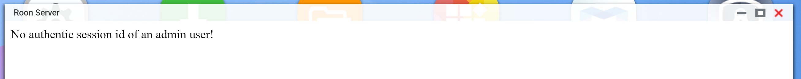

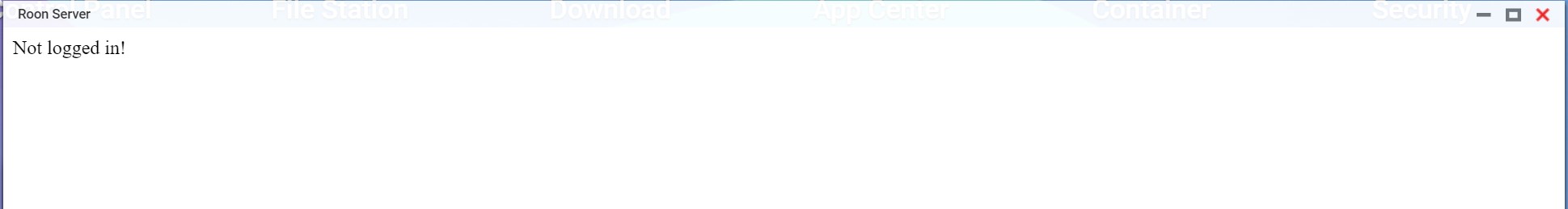

I think that i have found the problem and @BlackJack pointed me in the right direction.
I completely uninstalled Roon on the NAS, I enabled again the “admin” account and then I reinstalled Roon. The core is working and the control panel is opening as expected:
But, If I switch back to the user that I generally use as an admin (and that it is not called “admin” but is included in the administrators group), the control panel does not work:
The core is running properly and I can listen to my music, so only the control panel seems to be broken.
I’m uploading my logs so that @benjamin can check them.
Let me know if I can try anything else, thanks.

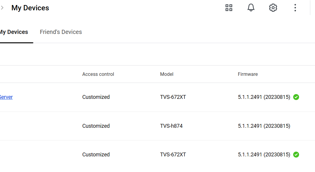

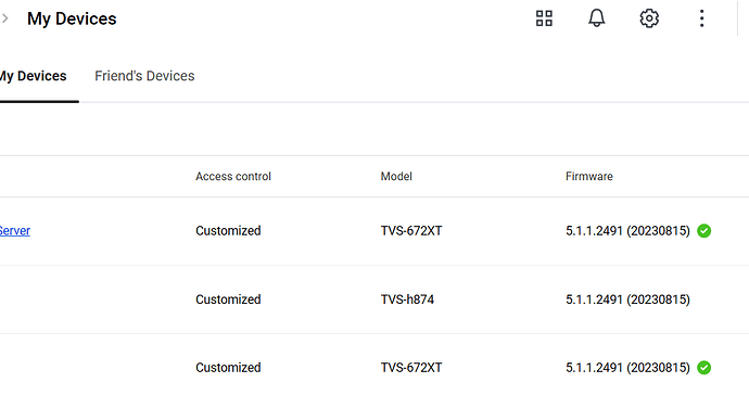

Are yours new installations or old? And have you the latest QNAP firmware installed? QTS or Hero?
My NAS are only a couple of years old. Here is a screenshot of the NAS and firmware.

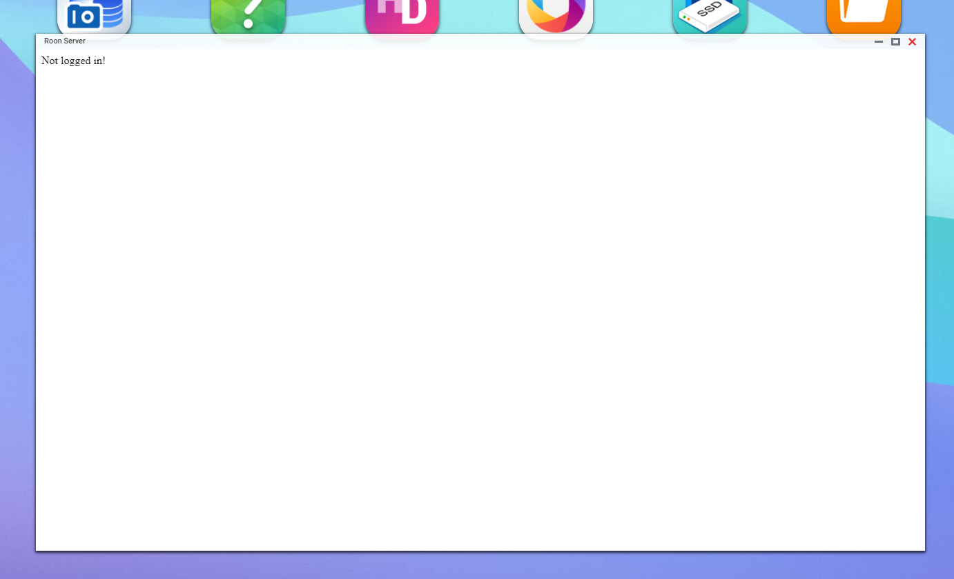

Can you explain what you mean by ‘completely’ uninstall Roon? I am having the same problem since updating to QNAP firmware QTS 5.1.2.2533 a few days ago. I only use the default admin account (no other users - bad practice I know) and have removed and reinstalled Roon but still get the same problem as described at the start of this thread re the Control Panel ‘Not logged in’ message. I did downgrade to an earlier version and the Control Panel re-appeared but I’d rather keep my NAS firmware up to date so have re-installed the latest version noted above.
Both Roon and ARC still seem to continue work fine and I almost never enter the Control Panel anyway, so I’m just going to live with it. However, there does seem to be a conflict somewhere with the latest QTS firmware and hopefully it can be resolved in case Control Panel access is required in future.
That said, if there are some specific steps to ‘completely’ uninstall Roon that I am missing then please advise. Apologies if these steps are buried somewhere in this thread and I’ve missed it.
