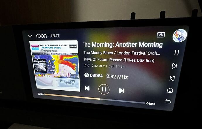

Just to confirm, after the 1.1.75 firmware update the A6 is Roon ready and feeds multichannel DSD via HDMI.

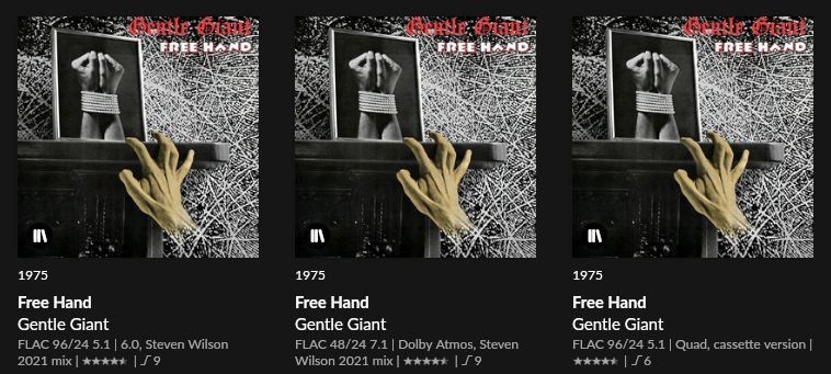

I have a few Dolby Atmos albums - converted to 7.1 flac files for streaming only. But even then it can be quite fun to listen to them, especially when there is another version of it in different channel-layout.
For instance this one:
There are tow reasons for converting:
First I still don’t have an Atmos Set-up (though looking into it), so my set-up right now is 6.0 all full-range, no sub woofer and no center. That will change (at some point :slight_smile:)
The other reason is that Roon does not support Atmos until now .
However – even with only the extra Surround-back it is already fun to listen and Steven Wilson does Surround mixes very nicely. So yes, there is certainly a difference in the mixes. I like the Atmos to 7.1 the most. If I listen to the 7.1 in 5.1 Downmix you surely miss the depth and of course also the separation between the Surround and Surround back channels. But that is just one example.

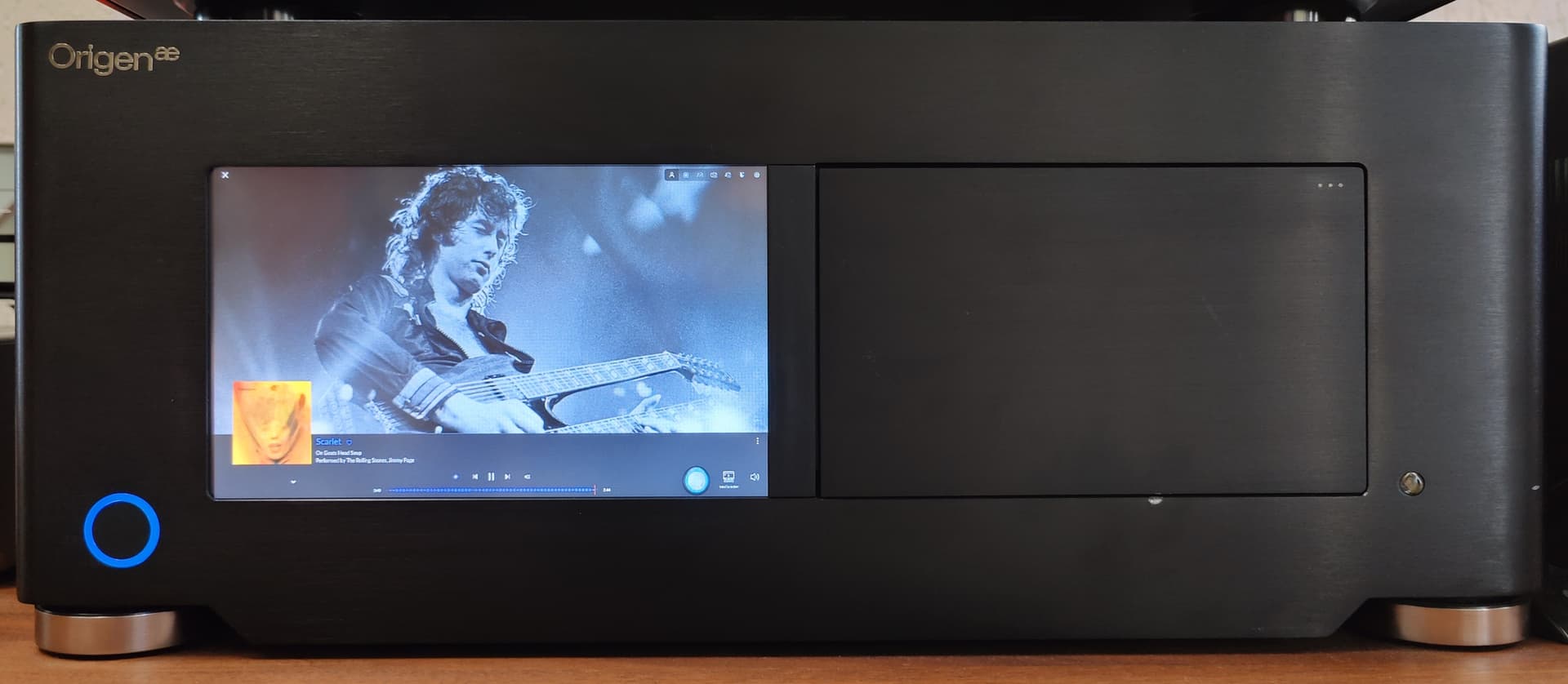

What really puzzles me is that only 5.1 via HMDI is supported. I have an Origen media PC as streamer in my main set-up which is 13 years old and even that one is capable of 7.1.
