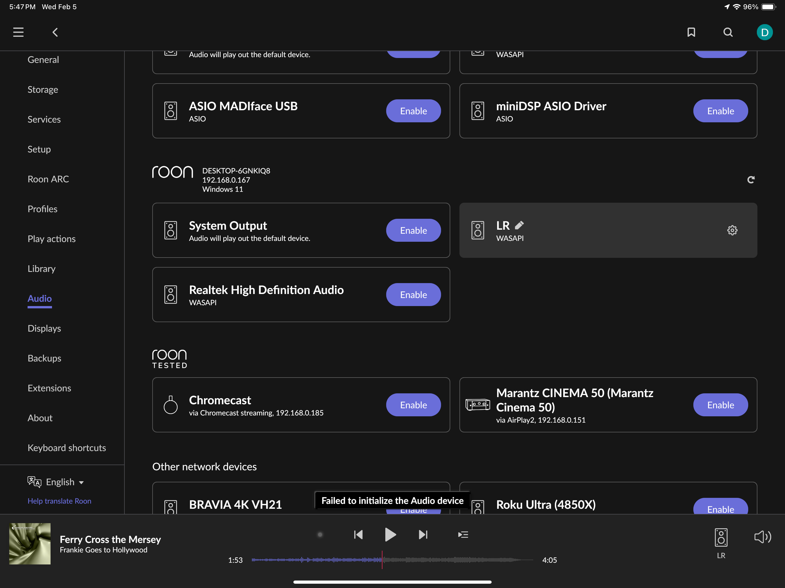

· Windows 11 PC HDMI to Marantz Cinema 50 receiver.
"Failed to initialize the Audio device" multichannel DSD
Music files stored on Synology NAS, Roon server on ROCK, Roon Bridge on Windows 11, all hardwired Ethernet

If you try to enable System Output and have the system route the audio to the Marantz, does that work as expected? For the LR zone, did you by any chance have Exclusive Mode set up for it, and have something else controlling it on the desktop when attempting to play to it? Also, yes as @Mike_LC mentioned, seeing the Signal Path for the zone when it is working can help clarify the audio output chain.

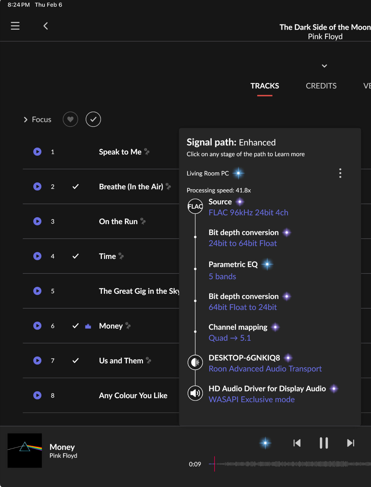

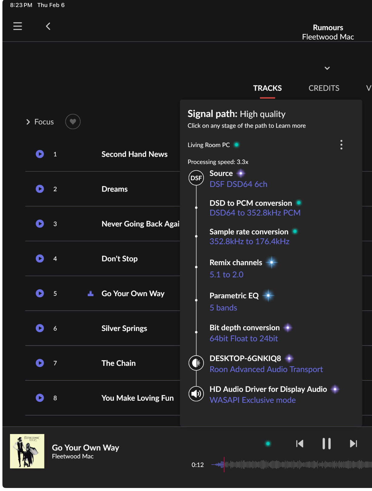

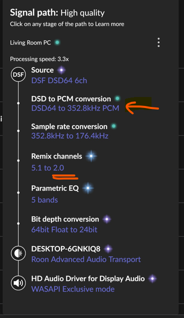

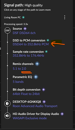

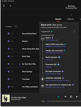

Yes, DSD works as expected, converting to PCM, when the bridge is set to 2 channel.
Here it is working with the bridge set to 5.1 playing multichannel flac.

Yes, as shown above I have DSD working when the roonbridge is in 2 channel mode, the issue is DSD when the roonbridge is in multichannel (5.1 or 7.1). flac is working with the roonbridge in multichannel, but the only test file I had was a quad 4.0 file, not a 5.1 file. So, I’ve converted a 5.1 channel .dsf to a 5.1 channel .flac to test.

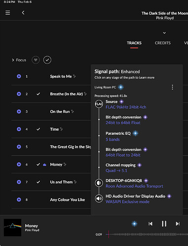

Tested with 5.1 flac vs 5.1 dsf.
Flac works as expected playing 5.1 channels
dsf still fails with the “Failed to initialize the Audio device”
