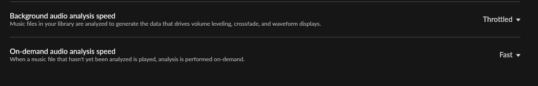

@MrDenis I’ve consulted with the rest of the team and what’s happening is that there are some albums attributed to various artists in your library. The analyzer is having trouble identifying these tracks. Because of this Roon is also creating new album objects for each subfolder in various artists. We also noticed there is a lot of scanning happening in your Roon library, you can turn off background and on-demand audio analysis in Roon Settings → Library to prevent additional background activity from occurring.

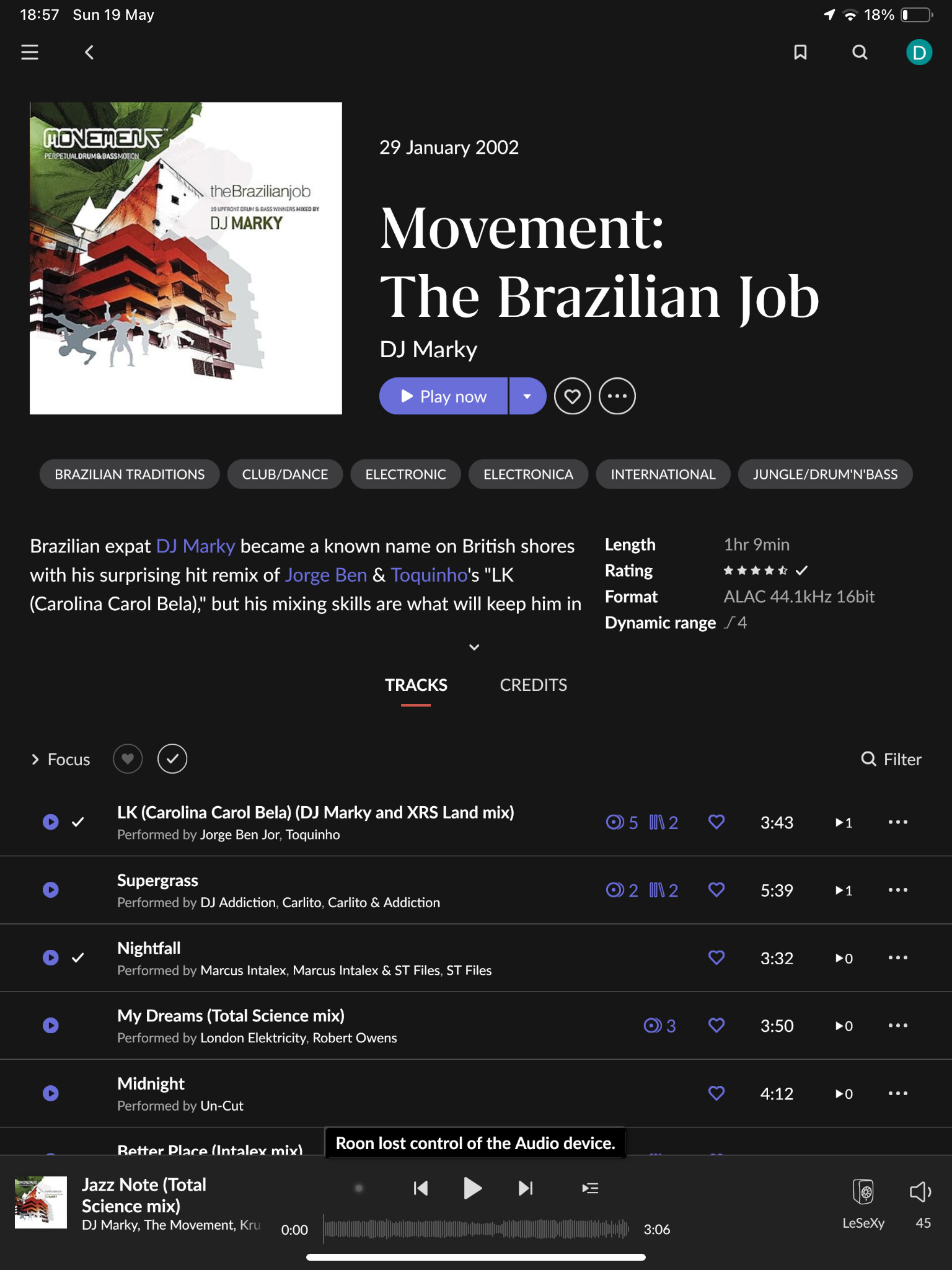

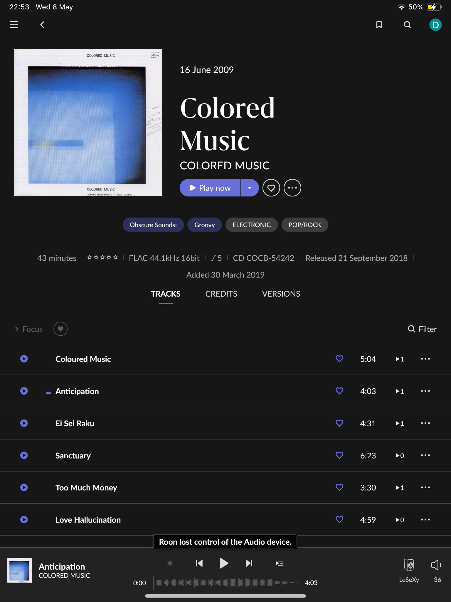

This tends to only happen when streaming to my Kef LSX (wired, on same switch) after I scrub through a track or skip a few tracks or change albums quickly. Sometimes resolved by playing a track from another album but usually I need to use Spotify to play something on the Kefs after which point Roon will reconnect.
Please try to reproduce the KEF disconnecting then let us know the date, time, and track playing when it happens so we can find it in the logs.
Also you could investigate whether a firmware update is needed. Are there any pending updates for your device?
The pic above has all those details - do you need again?
All firmware up to date
There’s no need to post again since the image has an accurate timestamp. I believe I’ve found one of the dropouts in your logs. I will bring this to the rest of the team and get back to you when I know more.

If you needed another example - here it is happening again
Hi @MrDenis,
I’ve talked to the rest of the team about this issue. It looks like we currently have an issue related to this that is being worked on. I can’t give any definite time frame. But I will let you know when I have more for you.
