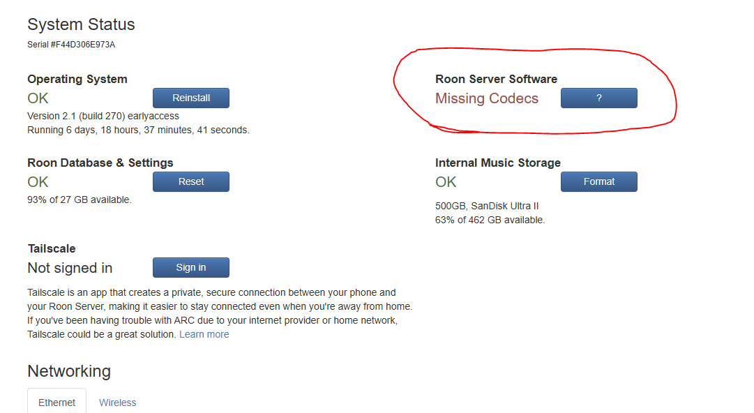

If you look at the webui for the Nucleus do you see any issue with missing codec?
It might looks something like this:

In the meantime, for due diligence, do you notice any missing codecs in the RoonOS Web Admin page per @bearFNF’s comment above?
Hi Connor and everyone else weighing in here, it’s appreciated.
First the meantime questions: no, the RoonOS web admin page reports no errors or missing codecs. And yes, other local FLACs play just fine.
