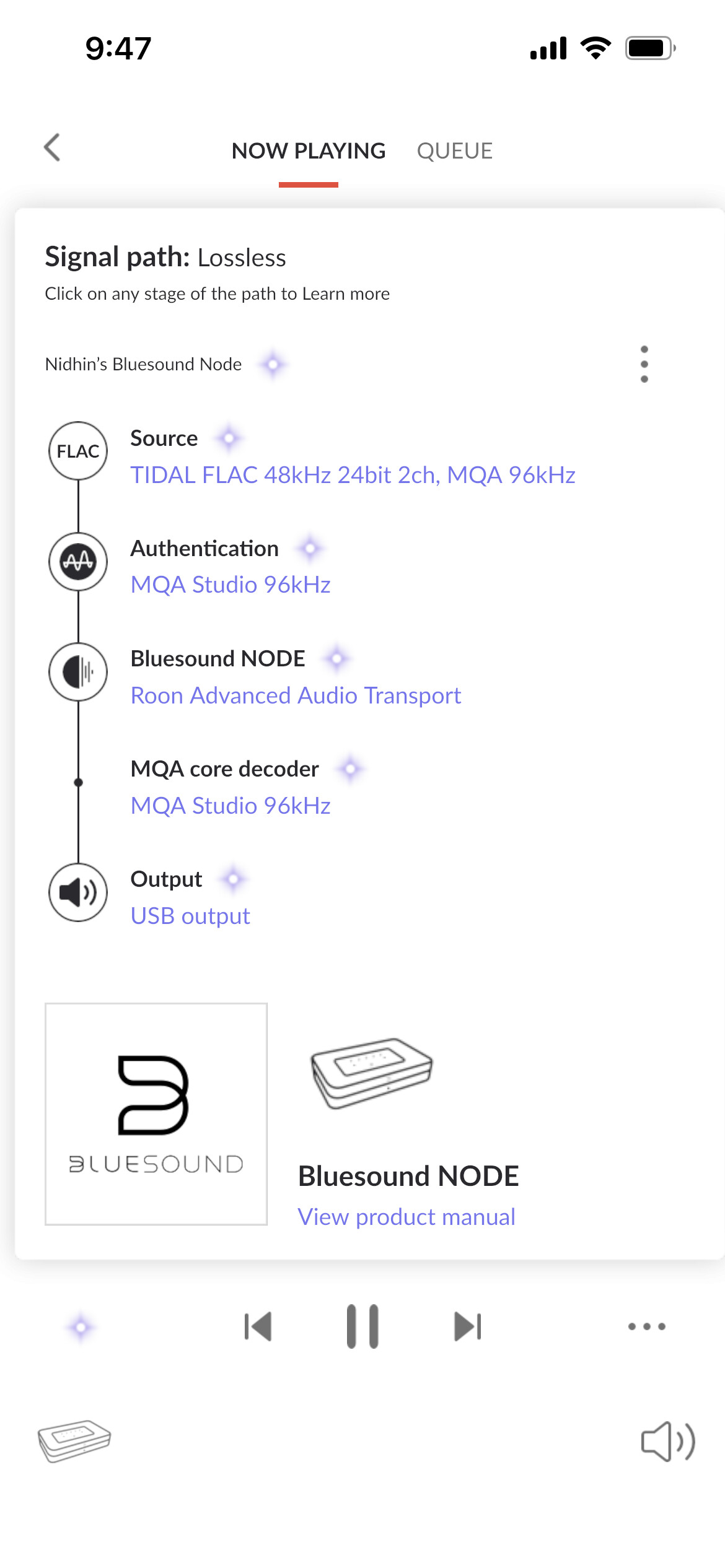

Maybe show us a screenshot of your signal path, please.

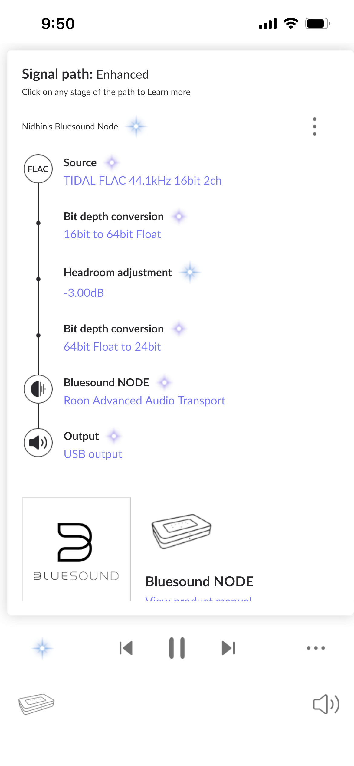

It seems likely, that you’re using a Roon-DSP function that needs headroom adjustment due to causing clipping.
To remedy, enable and adjust headroom as described in Roon’s helpcenter, see screenshot …

Hi Marin, I tried doing this after your suggestion. The static sounds have reduced. But it is still there. The problem is there only with Roon. Using tidal connect, it is perfect.
Do you see red clipping indications, still?
If so, keep substracting gain in the headroom adjustment field, until clipping is gone!
I’d still like to see screenshots of your signal path and DSP dialogue, also show your device setup selections, please!

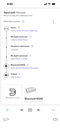

I have attached the screenshots. Have tried enabling headroom management. But still the static sound is there. The problem is only with Roon. There is no clipping happening. It works really well with Tidal Connect.
