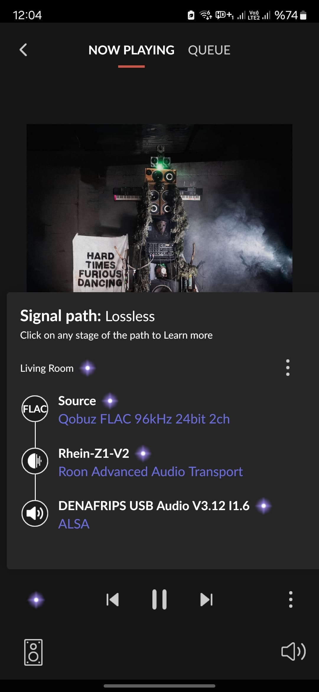

I am using qobuz and one hour ago there was no problem.It is weird now track above 44.1khz do not play.
Qobuz
Silent angel Z1 plus
Samsung s24 ultra
Denafrips pontus2 12th dac

Please share a screenshot of the Signal Path when this occurs.
Roon is clearly playing the 96 kHz 24-bit recording, and this is sent to the Rhein Z1. What happens after this is not shown in the signal path, but you can see clearly what Roon is doing (or not doing in this instance.)

Roon is already sending 96 kHz to the streamer, so this isn’t going to help, unless you mean to downsample everything to 44.1 kHz.

Thank you for your post. According to your screenshot, Roon is delivering 96KHz audio to ALSA successfully - do you see any error messages presented by Roon? RAAT has no control over how the DAC will handle audio once it’s been passed off in the chain.
The failures in this case appear to be downstream of Roon and within the endpoint firmware. Verify your firmware/drivers are up to date. Please also review the steps suggested just above by @mjw.

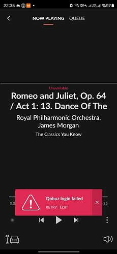

But now I saw red alert on roon; qobuz login failed retry or edit

I’d check out your Roon Settings>Services>Qobuz and attempt to re-login. If that doesn’t help, rebooting your server device and router may help.

Regarding the login issue, I suggest using a mobile device to perform the login, making sure that the OS default browser is used. A common reason OAuth fails is that the token isn’t shared between the app and web browser
I’ ll try it, thx a lot
