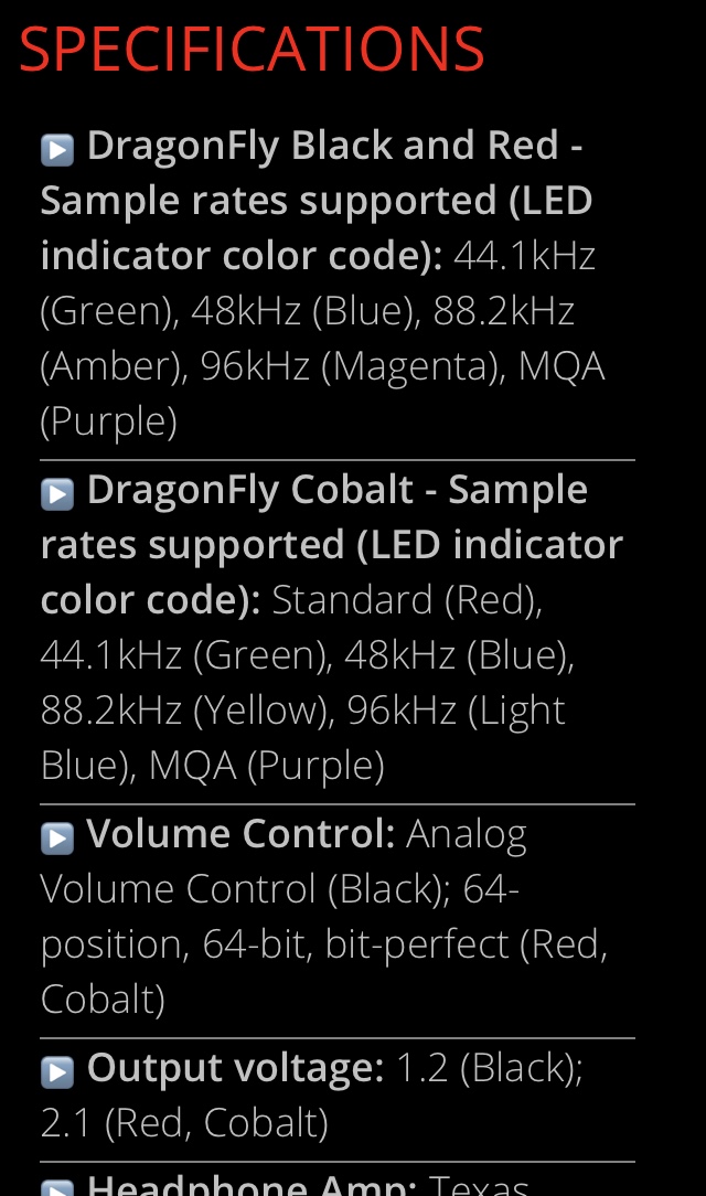

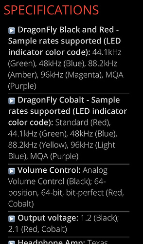

Incoming rate is not limited to 24/96. I stream 24/192 to the Dragonfly. I think you have it backwards, but I could be wrong. Do you own one? I do.
From the Cobalt spec page on Audioquest site…
Do you have an LED that indicates incoming PCM 192kHz @Jim_F ?
As I mentioned earlier, you might have a very special unit in your hands…
You must have a special limited edition unit that isn’t spec’ed anywhere on the Audioquest site.
And you must the only person on the planet playing Amazon Music HD bit pefectly on iOS at all supported rates.
I’m playing everthing on Amazon including 44.1, 96, 192. I can’t guarantee 44.1 is not getting upsampled to 96. 192 is restricted (downgraded) to 96 by my Dragonfly and Bose, both.

Out of interest, what is the LED colour for incoming PCM192kHz (that you are seeing) that Audioquest forget to leave off their site and user manual?
Light blue, because it is being downsampled to 96.
And what is the Cobalt’s LED colour if you play PCM44.1 in Amazon Music HD’s iOS app?
Do you really mean jitter or do you mean stuttering and dropouts? These are very different things.
Light blue also. Must be getting upsampled to 24/96.
