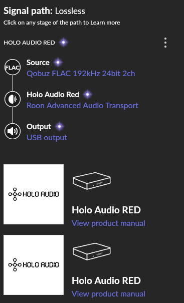

I have the streamer DAC and pramp , but not able to hear sound. I was able to upload Roon and it can play on other devices here is the sound path any suggestions. Previously it only showed Holo Audio one time not twice as shown here

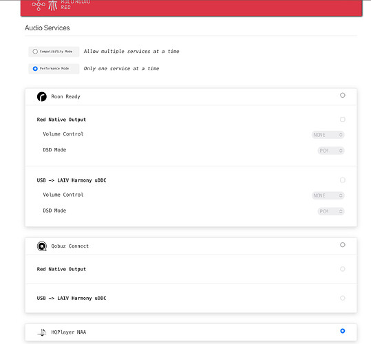

Here is the Red Configuration
I have tried the different modes and I don’t get any sound. Everything is connected correctly

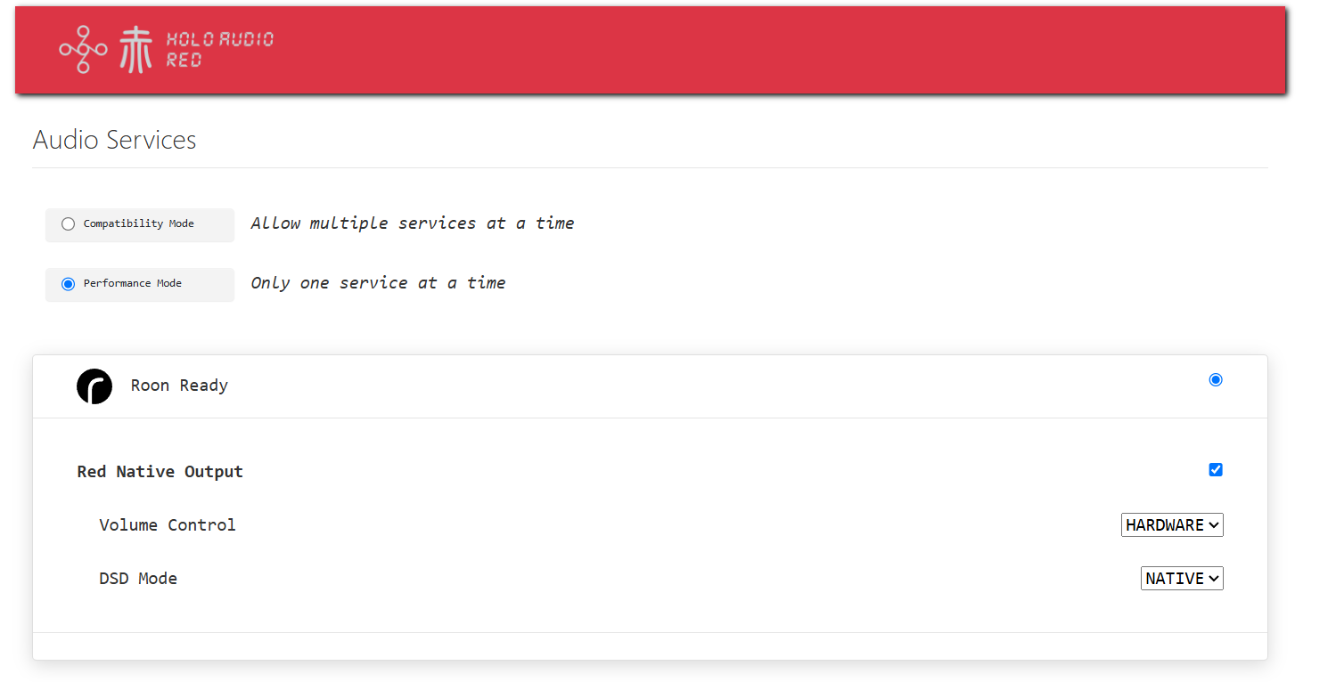

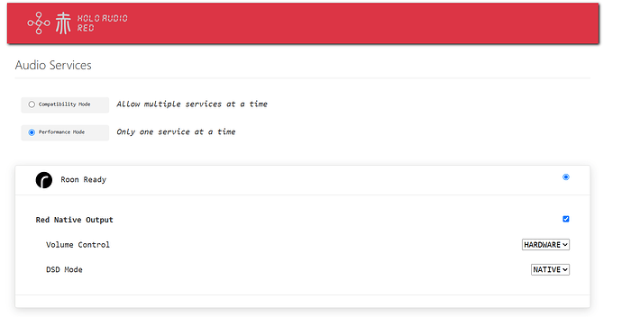

I have two options when selecting Roon playback. The Native Output is for I2S, The USB output is self explanatory. do you have two options? What is your DAC?
The two options should present as two different end points. One will show the Red. If USB is set correct you should see your DAC as the endpoint. I’m not sure why anyone would see the Red presented twice. Are you using the correct USB output or is it behaving like a DDC?

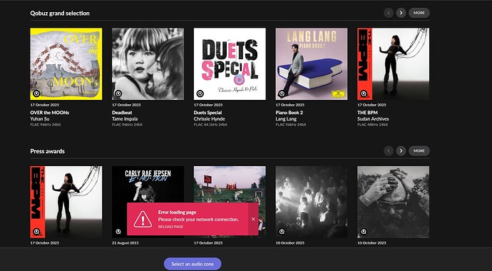

Not sure if USB is it behaving like a DDC . what I am seeing is
an error trying to connect . I am hard wired and using I2s into my Holo Dac
There is no audio zone selected in that image. Is it dropping out when you press play?

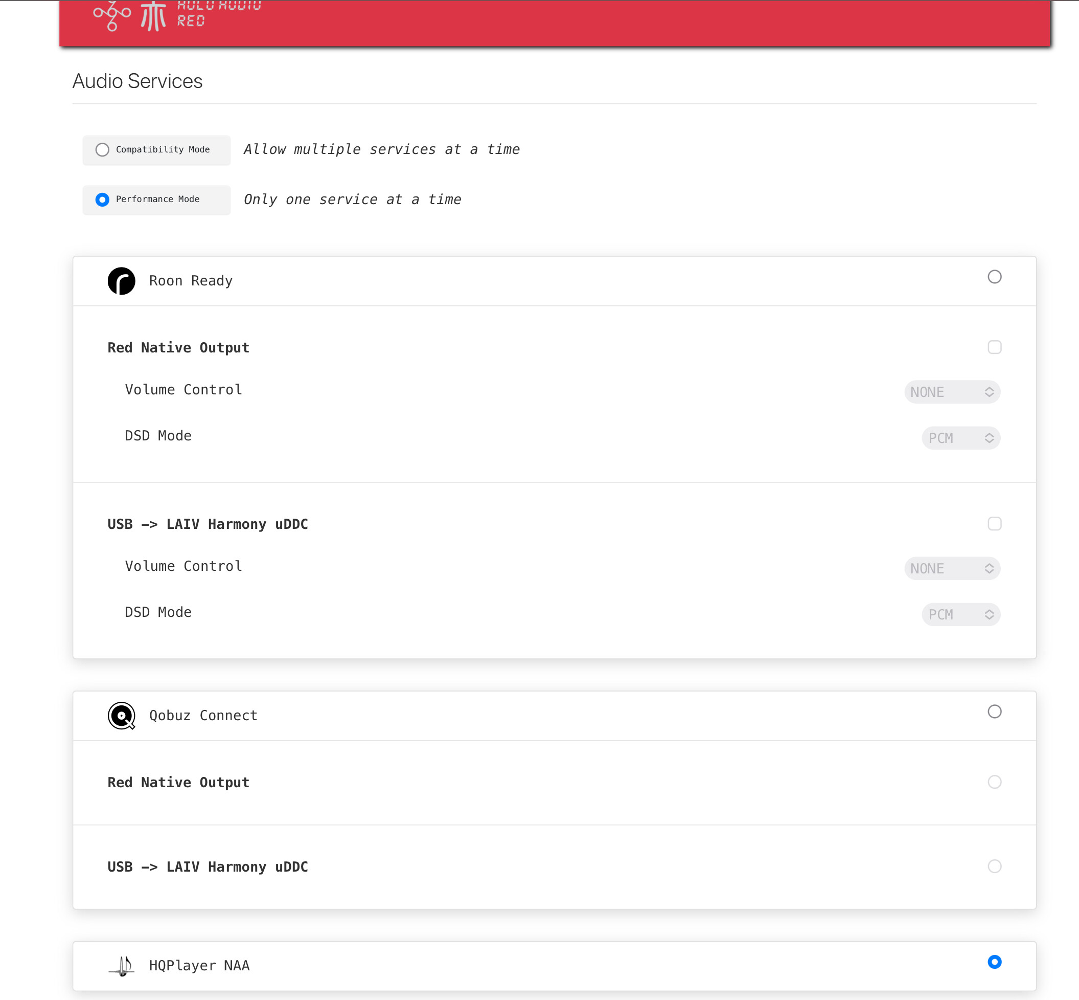

Would you please take a screen shot of the Settings / Audio page in Roon and show the Holo Red as well as the Device Settings.
It seems to be playing - I switched out the I2s cable
