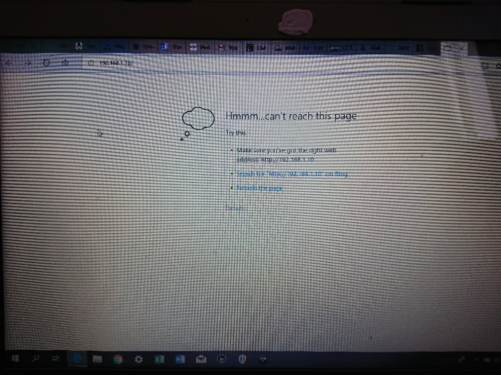

Hmm. Go back to the web administration page on your laptop - and refresh the page. What do you see? Is the Roon Server software shown as running?
It’s been showing this page since the reboot:
I’ve tried refreshing it a couple of times.
Bit blurry but hope you can make it out.
Right, I was afraid of this. I suspect your router (or whatever is handing out IP addresses in your network) has given your Nucleus a new IP address. Are you able to see what addresses are being used in your network? (usually a router that does this will have an administration page listing the addresses)
You could also try restarting Roon on your laptop, to see if it will now find your Nucleus Core at the new address…
