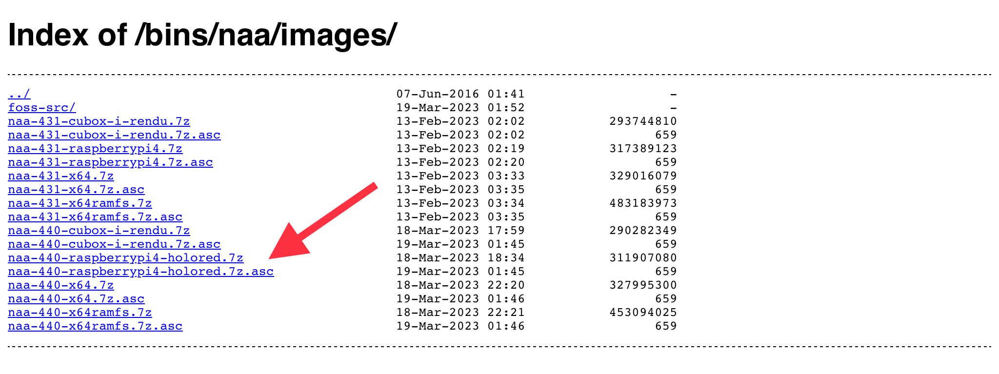

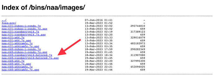

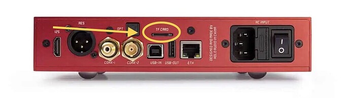

@Stefano_Antonelli How do I run jassi naa os on the holo red, per the comment above?
You need to burn the specific NAA OS image on a microSD card and boot the Holo Red from it
Yikes - have No idea how to do that…:frowning:
Install Balena Etcher on your pc (Windows or macOS) then download the NAA OS image and burn it to the microSD card using Balena Etcher, then remove the original microSD card from Holo Red and put the new microSD card in the Holo Red and power it on
Brilliant. Grazie Mille!
