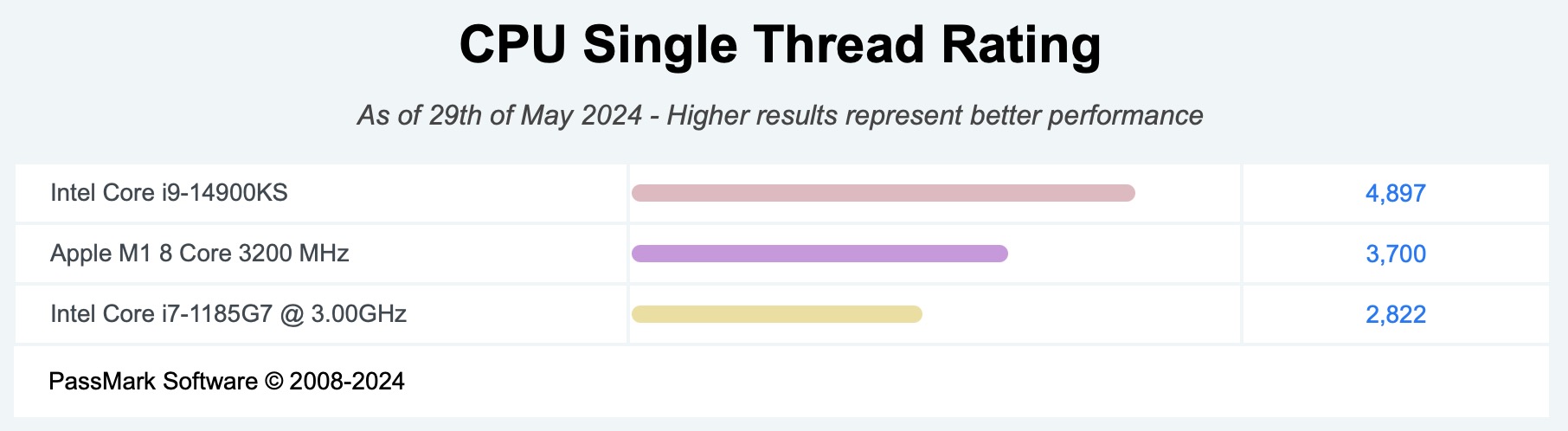

Xeons are still not good Roon CPUs unless you want to run 24 parallel zones. Single core comparison to the i7-1185G7 in the NUC11TNHi7 which Roon currently recommends for 12K+ albums with ROCK:
https://www.cpubenchmark.net/compare/3524vs3793/Intel-Xeon-Silver-4210-vs-Intel-i7-1185G7
Yes, this, it can’t be stressed enough. Roon, for the most part and for majority of use cases is a single core constrained thing. You want really fast single core performance. The nice thing about Xenon though, and there are a couple fast single core Xenon’s, is the ECC memory.
Otherwise, nice system indeed. With 128GB of memory I’d imagine most DBs would sit completely in memory nicely :slight_smile: Should be ultra quick.
Well, if I switch to a W361 with an Intel i9-14200 KS 3.2 GHz processor, I can get the cost down a bit, which means I can upgrade the video card to an A2000 and add a liquid cooler for the CPU. Still only $3804.
Video cards should not be considered if you are truly trying to spec a high end PC as a RoonServer. Now, if this machine is doing double duty as a RoonServer and HQPlayer PC, then go ahead, but, you need to use an NVidia Cuda capable graphics card (and not a Quadro). A high end CPU wiht something like a 4090ti GPU, should be able to crush 1024 DSD with heavy modulators and filters.

I don’t think I really understand graphics cards. Don’t the Quadro cards have Cuda cores? Well, I can’t do a 4090Ti and still stay under $4K, but I can do a 4070Ti Super 16 GB card for $3974.

Alternatively, split the difference between the i7 and i9 and get a second hand Mac mini M1. That would definitely be way cheaper :slight_smile:
