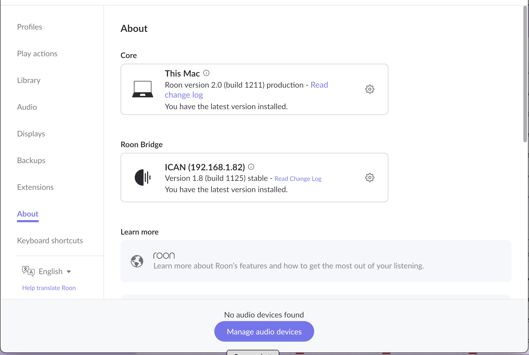

I have reinstalled everything and now something different happens!
I have set hifiberry Digi+ Pro in RoPieee but now there is no way to reach the device from Roon.
I see the correct name I gave to the transport in the “About” tab of Roon but if I try to manage audio devices in Roon it won’t show up.

That looks like it is recognised but won’t be seen until a DAC is plugged into USB. That is what you would expect, but it also means that for what ever reason (possibly the isolation between the Pi and the HAT) Roon cannot see it as an endpoint in its own right. It might be time to call in Harry @spockfish to see if he can help.

Here are the screenshots so to better explain what’s happening. “ICAN” is the spdf HAT I’d like to use but NOT seen in the Roon audio devices list. Thanks!
