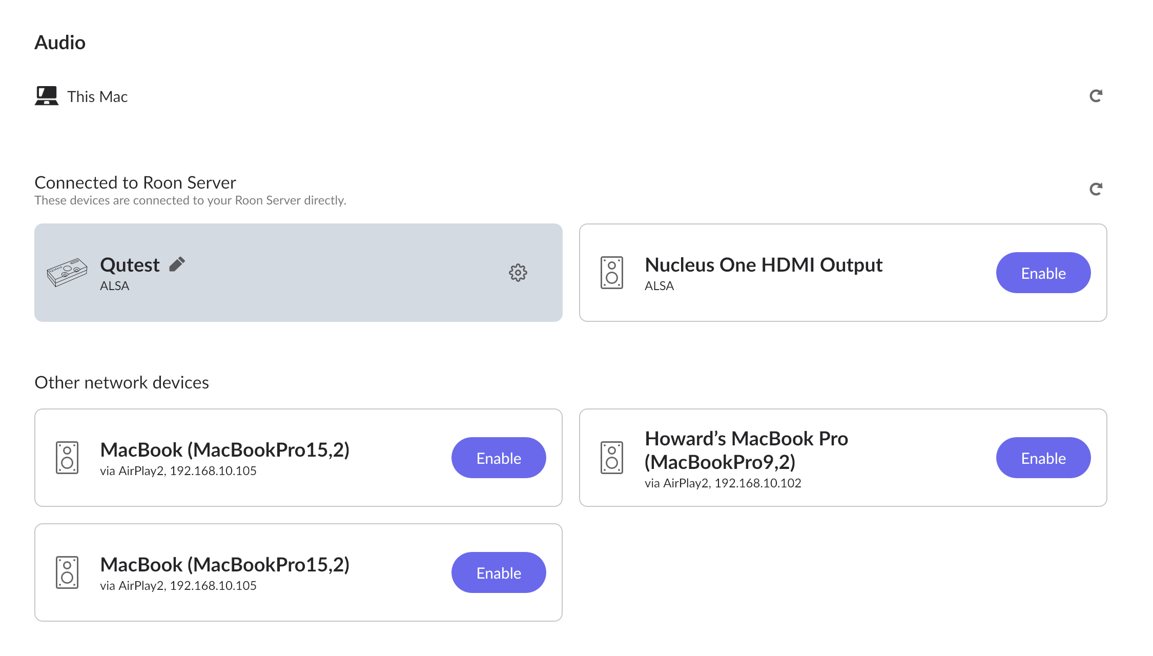

The display on the audio tab has settled down now and not jumping but there is still no option for audio out on my existing mac. You can see this in my attached pic.
Hi @Howard_Sambol,
Thanks for the additional information and troubleshooting done so far.
If you could, please use the directions found here and send over a set of Roon logs from the issue Mac to our File Uploader?
With that, could you also share a screenshot of your Audio/MIDI settings on the Mac?
