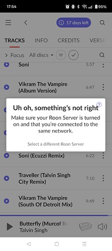

Intermittent connection issue between Nucleus One and phone (ref#KXKFTM)
Is Roon Server running?
· "Waiting for your Roon Server"
What happens if you press the "Select a different Roon Server" button?
· I don't see Roon Server.
Please try to restart your Roon Server by closing the Roon app in the taskbar or rebooting your Roon Server machine.
· *Nucleus*
I have set up my Roon Nucleus One and successfully connected it to my windows laptop and there are no issues with that. However, I can't keep the connection to the server on my phone.
I first thought it had to do with my laptop still having a server on it but after deleting that the issue remained.
It will connect after turning the Nucleus on and off, and same for the router but after a few minutes it can't find it. I will add that the RoonArc app does a have a stable connection on my phone. Any assistance with this would be greatly appreciated.
The Nucleus is connected via ethernet to my router, the model is Eir fiber box 1A 1.0
![1000008569|223x500](upload://foORIkTElgp68pF1FTRlLUcPSNA.jpeg) ![1000008569|223x500](upload://foORIkTElgp68pF1FTRlLUcPSNA.jpeg)

Hi Daniel, I actually did have battery optimisation on however, after turning it off the issue still remains. It loses connection when I exit the app and open it again. I will add that the colour of the lan port on the Nucleus is orange, maybe signalling low connection? I wouldn’t have thought so though as my Internet is good in all other uses.

I have now deleted the RoonServer folder and have confirmed the subnet is the same for the Nucleus and phone. However the phone is still not keeping connection. I have an old phone that connects easier and for longer but will also lose connection. I will add that the app on the old phone displays the number of Artists, albums, tracks and composers in my collection just below the Hi, Mark on the home screen. The app on my current phone doesn’t show that.

Thanks for your response. The first screenshot (17:47) is when I connected after rebooting the N1. I then just closed my phone and didn’t play anything. The second screenshot (17:54) is when I opened my phone after closing it at 17:47. Date is 27/02/25. Hopefully this helps.
