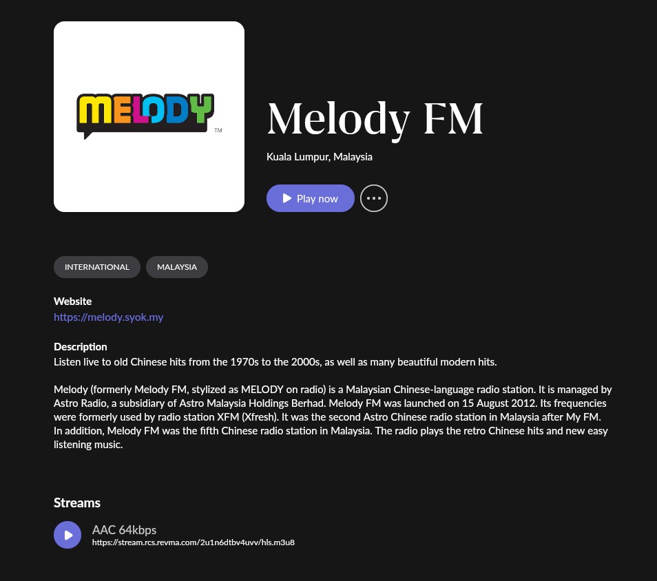

i find it quite strange - i use the same url that you have found and create a new station with it, error message appear that roon is unable to find a station for that url.
got some good news
found this url which works and play more than 10s.
at first, roon recognize the url when i create in the “new station”. initially, it could not play, but after a few tries, stop play stop play. it worked! have a look at the url
https://stream.rcs.revma.com/2u1n6dtbv4uvv/9_11l86ncot7z1w02/playlist.m3u8
it is different from the one that you have input.

The link used in the database can point to different URLs each time because of load distributing re-directions. You have used one of these.
There is no guarantee that such URLs will always be online and thus it’s better to use the original as is the case here.
What is interesting is that removing a level of re-direction has helped in your case, whereas other users see no issues.
