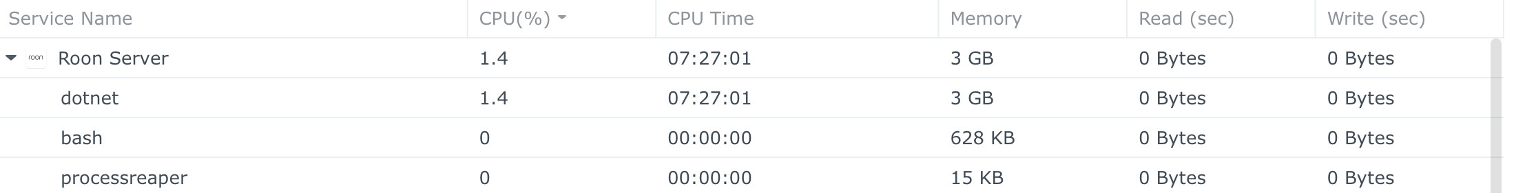

Interesting thought. I appreciate the idea. CPU usage is really low from Roon. Note the Sonos products work fine all the time. It’s just the wiim, Bluesound and NAD that randomly vanish, even when hard wired.
Current CPU usage is 1.3% while playing in 2 rooms. 1 tidal, 1 local dsd. Even if I reindex it’s barely changes.
Ram usage always seems bloated which I understand is a common issue. Units currently using 3gigs of 32gb available.
