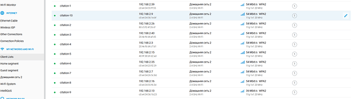

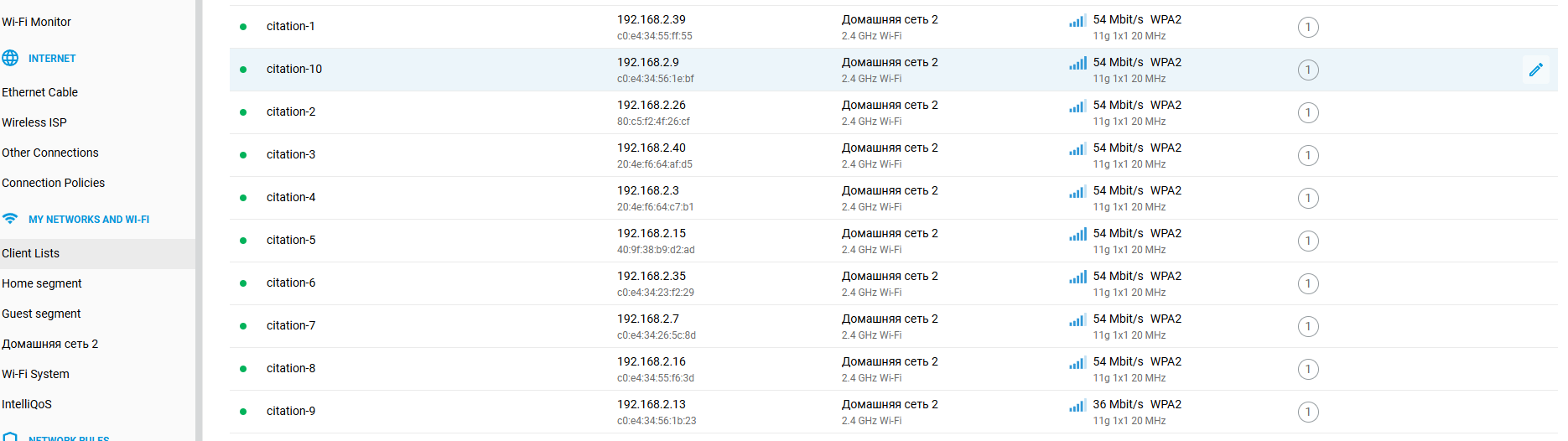

The playback devices (10 Harman Kardon Citation One and Belkin Soundform) receive a signal over 2.4 GHz Wi-Fi and, judging by the green signal indicator, as well as information from the router, have a high signal strength.

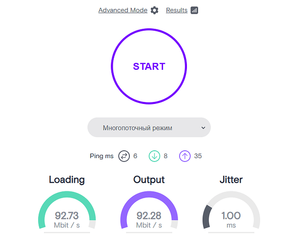

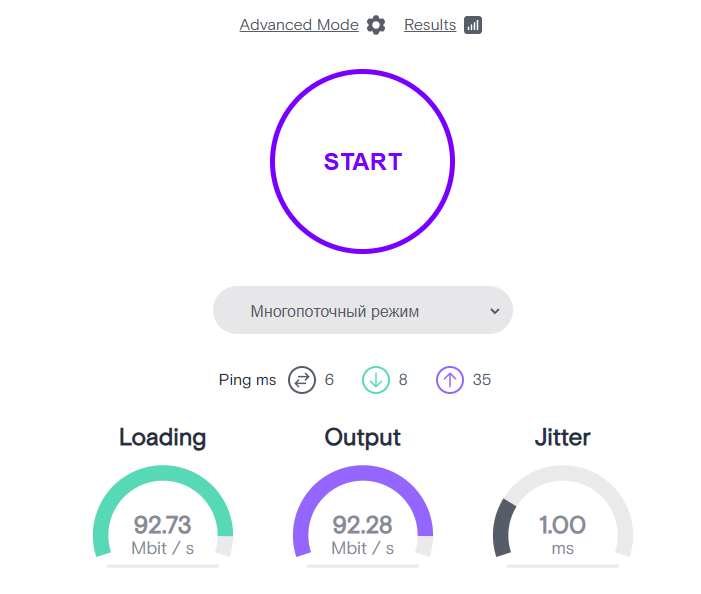

I am sending the results of measuring the speed of the Ethernet connection of the computer-server for Roon.
