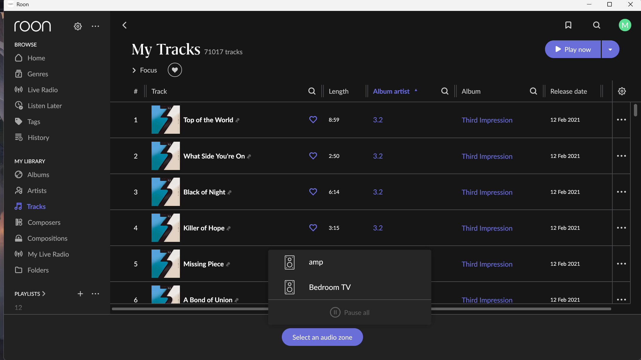

· PC Roon is running on
Pushing play multiple times eventually gets "choose a zone" to appear, where only two zones show up (out of 13)

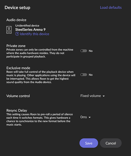

I checked in the Roon Audio device setup and there are no file format playback settings available to me

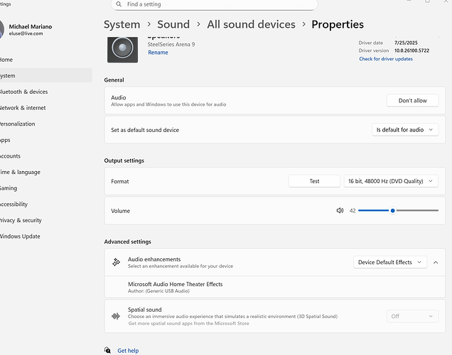

Ans I checked my PC Sound settings and they are set to 16 bit, 48000 HZ
Am I looking in the wrong places??

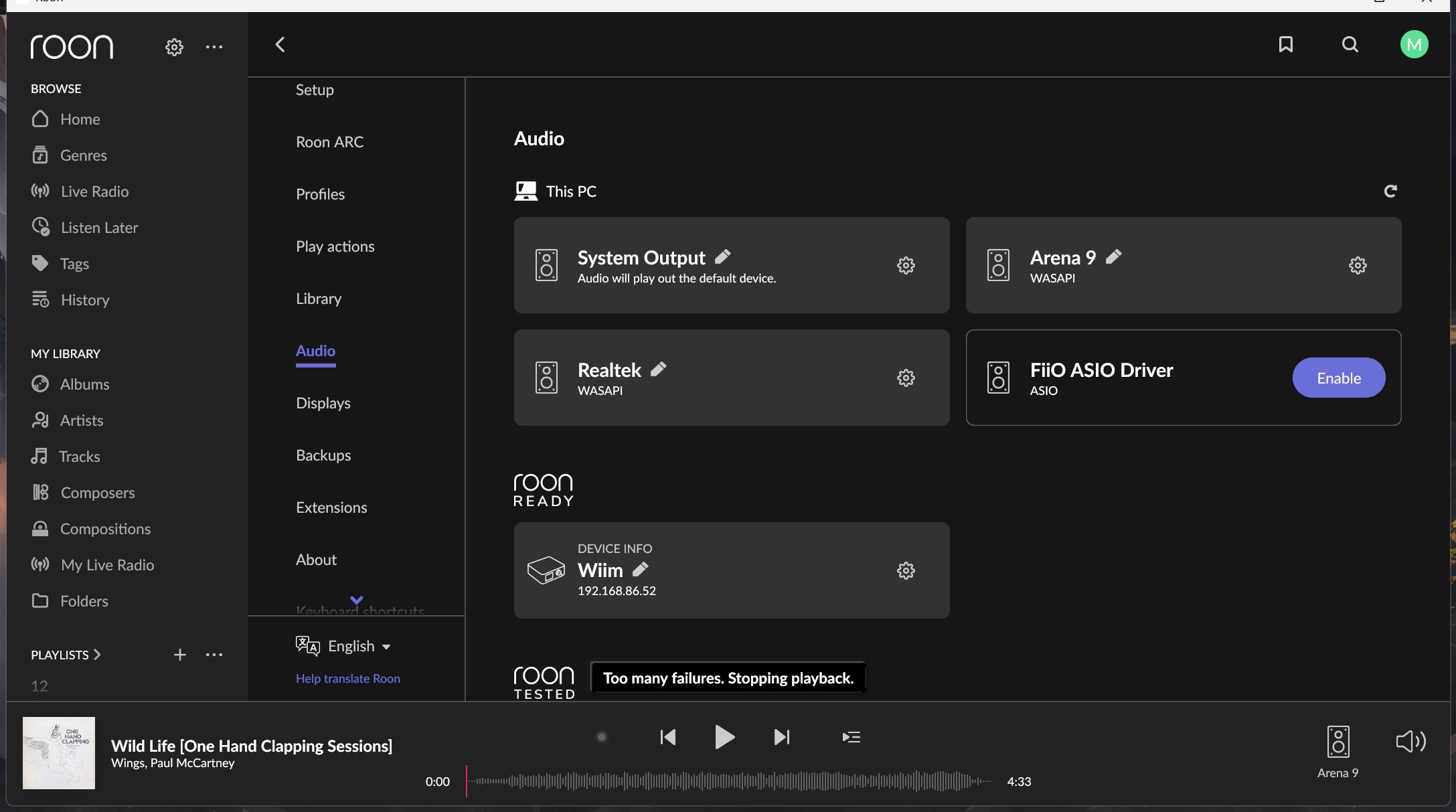

Ha. That’s funny. I was fast asleep, I didn’t do anything. The Audio page of Roon settings cycles on a regular basis though, so the program is doing stuff on it’s own. I didn’t play that song - but I guess it tried again and got a too many failures error because is got a Chris de Burgh song queued up now.

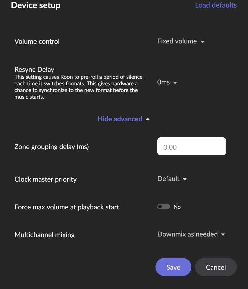

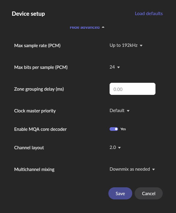

The pattern that we see in the diagnostics is that when trying to play stereo content, the playback fails, but the 6ch content worked in the past as expected. This means that the device is likely requiring multichannel content to work properly. I noticed in your earlier screenshot that you didn’t have multichannel options, but I wonder if the device was not reporting the capabilities properly. You still don’t see a way to set the channel layout to 6ch in Device Setup → Advanced by any chance?
I do not see a way to set it to 6 channel. the only other option is channel mapping and that makes no difference.
Just as an FYI as the app cycles I often get limited zone options
