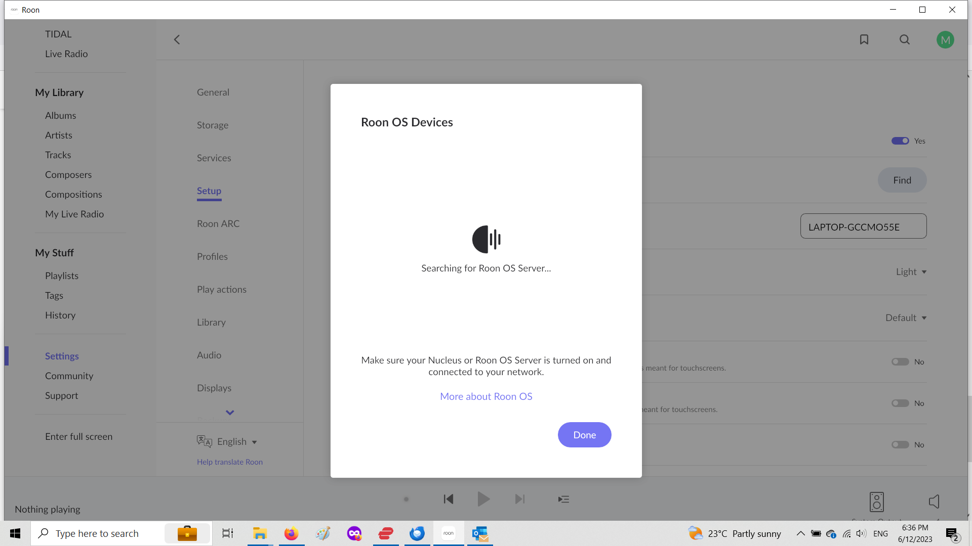

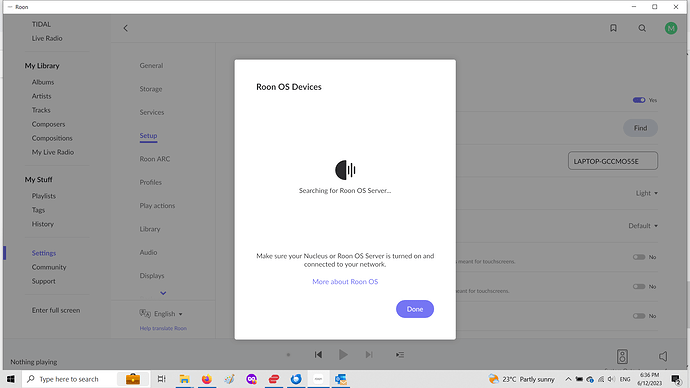

Here is the screen on the main core computer and even it can’t find the core and it spins like this interminably until I just exit the screen in frustration. So far none of the suggestions have made any impact at all with my problem.
That screen tells you it is looking for a Roon OS device - and of course it can’t find one, because you don’t have one in your network. Roon OS is used in the Nucleus and ROCK/NUC systems.

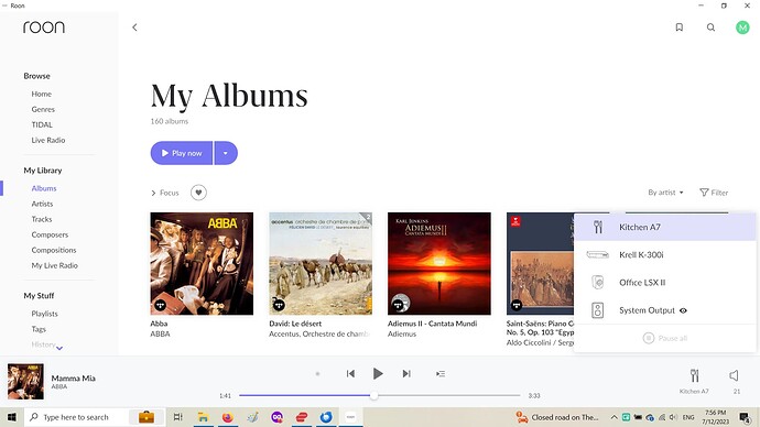

Yes it runs normally on the computer. The iPads just does not connect to it. Also, since I changed from the ORBI router that was struck by lightening to the DECO_318C it won’t talk to the B&W A7 speaker that it used to talk to easily. It shows up on the menu, it plays the music but no music comes out of the speaker system. If I play to the speaker using Youtube on the iPad, it plays perfectly.

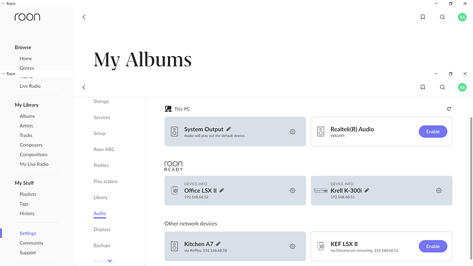

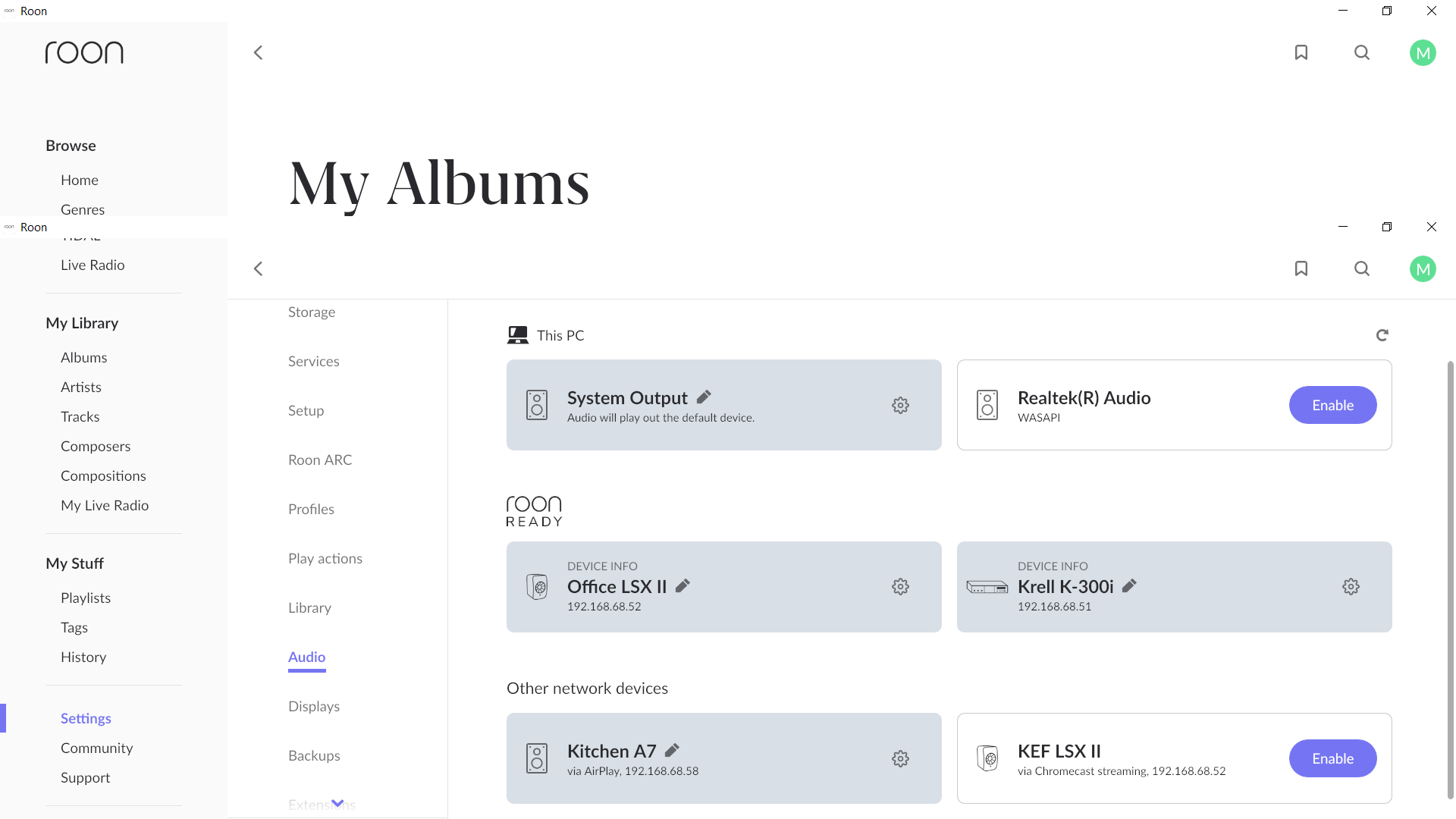

Can you post a screenshot of Roon’s Settings > Audio screen showing the B&W A7 device?
Here it is
@michaelwalsh3, this isn’t the settings screen. Go to Roon Settings > Audio, using the sidebar menu.
Is this what you are after?
