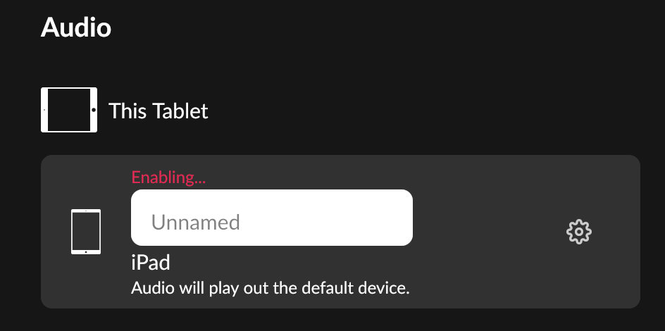

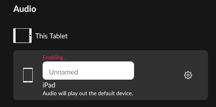

Edit: another oddity has arisen now: my local zone on my iPad cannot be enabled anymore (it was enabled just before I did the restart). My Samsung phone has no issues as a local zone.
Again, not a problem for me (I never play music on my iPad), and I don’t want to hijack this thread…

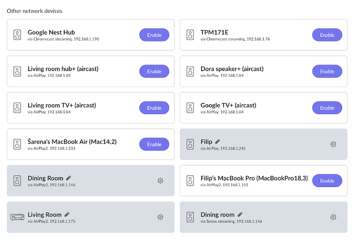

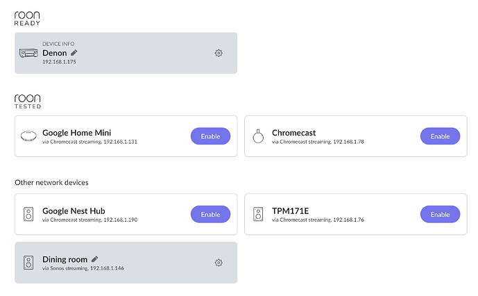

I am facing same issues. Airplay endpoints randomly disappear. In particular, I use Airplay on Sonos Move and Roam devices, as well as Denon AVC-3800H.
I can still see Sonos endpoints and Roon Ready on Denon, but Airplay options disappear. You can see this screenshot where Denon via Roon Ready and Dining room (Sonos Move) via Sonos are available, but no airplay options.
These issues seems to have started since the last update - 2.54 (Build 1554)
And they appear again after I restart roon service (sudo systemctl restart roonserver.service):
I am running Roon server on a NUC under Ubuntu 24.04.3 LTS. Rebooting or restarting Roon service fixes it, but after some time Airplay endpoints disappear. They appear again randomly, then disappear again, etc.
