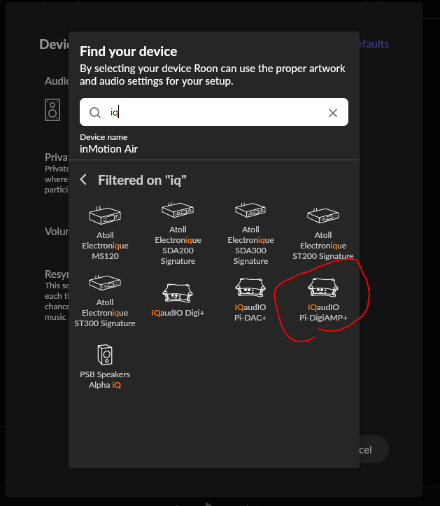

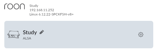

But, (you may have already done this?) you can select it from the device settings to make sure the artwork and audio settings are appropriate for it:

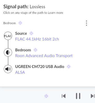

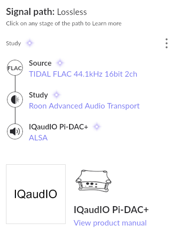

Erm - it’s showing up in the “Roon” section of the audio devices - so therefore it is “Roon Ready”. If you want to set your mind at rest, look at the Signal path - I think you’ll see that it is using RAAT, and therefore is a Roon Ready device.

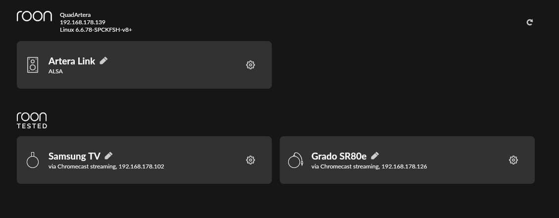

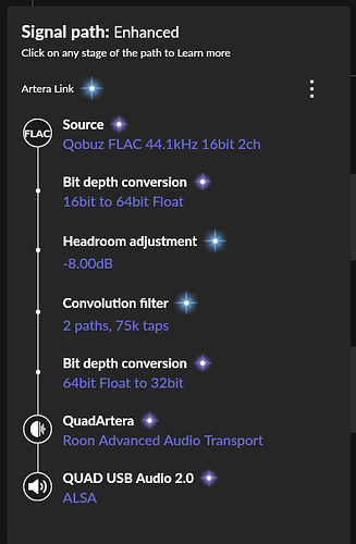

As a comparison, here’s my Artera Link endpoint, which is a RPi4 running RoPieee (also Roon Ready, since it uses Roon Bridge):
And here’s the signal path:

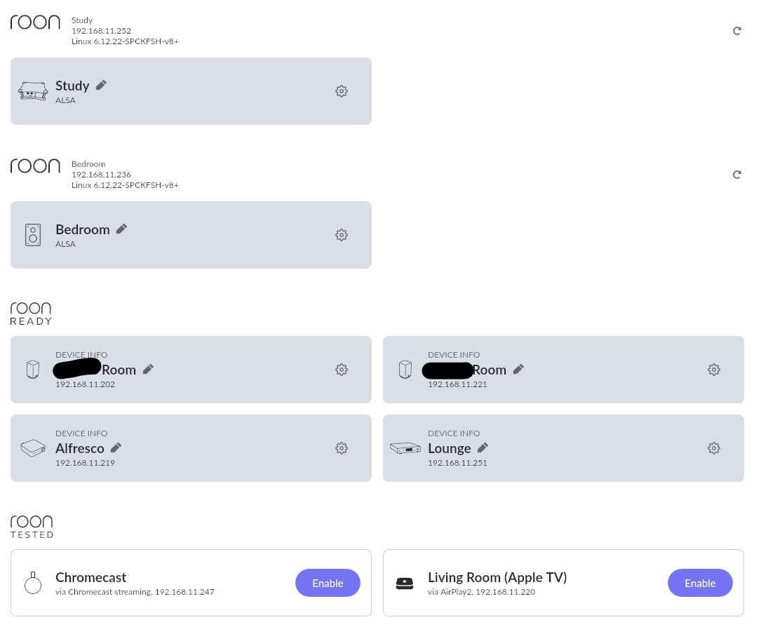

Maybe it’s purely a presentation thing. However all of my Roon Ready devices show in a different spot to all my Ropieee endpoints (and some of my Ropieee endpoints do not have “Roon Ready” DACs). E.g. you can see below two of my Ropieee endpoints showing separately (including the relevant IQ Audio DigiAMP+) and below that are all my Roon Ready devices (3 different brands, 4 different devices) and below that are the Roon Tested devices.
In terms of the signal path, everything going through Ropieee uses RAAT, but that doesn’t mean the DAC is Roon Ready. (e.g. the two below examples)
It’s a presentation thing - so long as RAAT is being used, then you’re OK. Roon Labs Roon Ready program " combines our RAAT technology with a comprehensive certification program, support infrastructure, and co-branding between Roon and device vendors in order to create the best experience possible for our users."

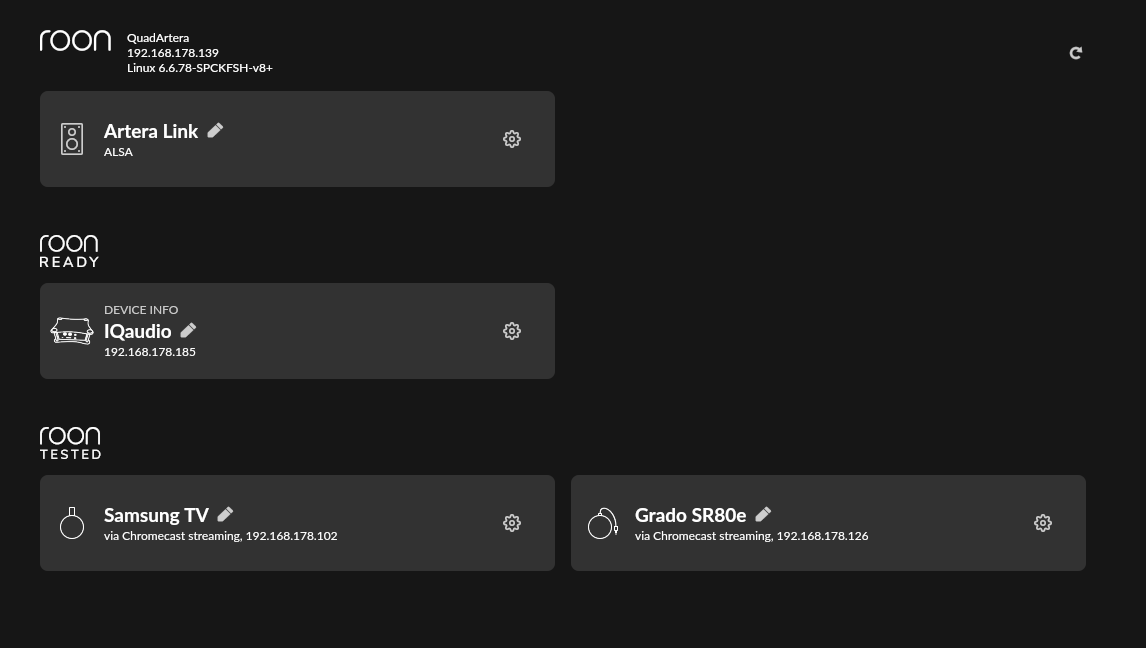

Just for giggles, I’ve dug out my old RPi3 with the IQaudio PiDAC+ and installed the RC3 candidate of the Roon Ready build (from the Internet Wayback machine).
It works…
