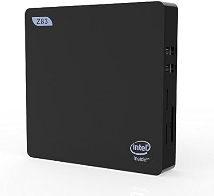

@nate_c Can you comment on whether this box would work for a multichannel Roon endpoint into an Anthem AV receiver? Like you originally, I am trying to find the least expensive, small fanless device that can take ethernet input streamed from Roon Core and act as a Roon endpoint for sending multichannel audio to my surround system.
-michael
Give it a try. Since it has Windows 10, it might work. Depends on what the HDMI output supports. Most will do 1.3 or better standard and that should cover HDMI. Itās inexpensive, anyway! JCR
I agree with Jeffrey. The 32 GB of storage might make Windows updates more difficult, but I donāt see why it couldnāt work as a Roon endpoint. You would just need to install RoonBridge since it has Windows 10 and then connect a HDMI cable to your Anthem receiver.
Thanks to you both @nate_c. After doing more research there seems to be some thinking that Roon Rock running as a bridge would work perfectly well on these lower specād mini pcs. I REALLY would prefer to not run Windows for this one use case. The other option appears to just install Ubuntu Server and then run the Roon Bridge install script. Again, this config can run on lower spec hardware than Roon Rock. Either of these options is more appealing than a Windows 10 install with all that baggage and update hell. I was just hoping that someone who had actually done what I am trying to do would have posted. But this is the closest Iāve found. Any comments?
At the time I was researching endpoints, it seemed there were some concerns about multi-channel audio via Linux. I could never find out anything definitive other than multi-channel didnāt work with the Raspberry Piās version of Linux. Hopefully somebody more knowledgeable on this topic than me can chime in and help answer this question.
Well Roon Rock is linux and my understanding is that you if you can run Rock on your hardware, you get multi-channel as part of the deal since Rock can act as a Roon Bridge using the HDMI for MC. However, the claim of some is that Rock is nothing special on the OS front, and that just installing Ubuntu with a separate install of Bridge gives you same benefits of MC but on an OS that is supported on lower specād hardware. Iām close to just picking up a NUC with a Celeron processor and giving it a go. I can get the NUC + 4gb of RAM + a small SSD for about $180. Thatās about as cheap as I can find for getting something Roon can talk to for MC output.
Yep, Rock will work. I just didnāt go that route because a full-scale NUC seemed like overkill (in both performance and cost) for an endpoint. Thatās why I ended up with a Windows-based mini-PC. (I got a 64 GB model to help with upgrade headaches.) I will be very interested to learn if you can find a cheaper option for a multi-channel Linux endpoint than a NUC.
If you donāt mind, what did you pay for your mini-pc running Windows? I found a Celeron NUC for $117. Add 4gb of RAM for another $30. And a 32gb 2.5 inch SSD for another $19. NUC has everything else including gbit ethernet and HDMI 2.0 output. I think I stand a better shot of gettin ROCK to just work on any NUC vs other hardware. But Ubuntu install should be good fallback with the Roon Bridge install. I wish the raspPI HDMI could do the trick but apparently not.
My mini PC (with a Atom processor, 4 GB of RAM, and 64gb of storage) cost around $150.
