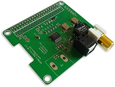

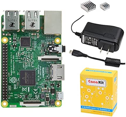

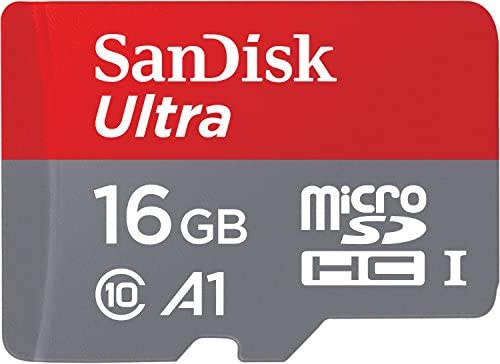

Or do I need Roon bridge too? Thinking of building a Rpi with a hifiberry digiplus pro, and a rpi 3 board
this includes a power supply. I would also buy a 16gb sd card.
Would this do it?
Thanks from the noob!

Yes, this plus the SD card is all you need. Don’t forget you’ll need a couple of RCA cables too.

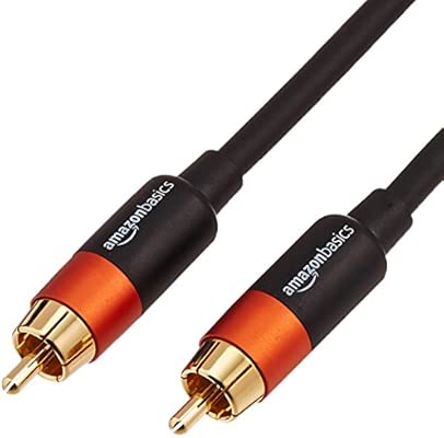

Thanks @mjw! I was planning to use digital coax, to go straight into my Yamaha AVR, which has a nice ESS Sabre DAC. So, a good coax cable will be all I need, right? Mostly concerned with whether I need to install any software than the hifiberry download. The hifiberry site link suggests that Roon will find the endpoint with their software installed. Right?

You need a digital, not analogue out board then.
Also ropieee is the easiest software to run for a roon pi end point.
https://www.hifiberry.com/products/digiplus/
@ged_hickman1 Right, the digiplus pro is on the list. Do you suggest Ropieee INSTEAD of the hifiberry OS?

If you’re going for the Digi+ then you’ll need a coax cable not RCA. I agree with @ged_hickman1 that Ropieee is the best option for the majority of Roon users.
@mjw Yes, agreed. I was going to get the amazon one:

I have done 3 similar builds over the last year. I installed Ropieee on all 3 and found it to be fairly straightforward. You will need a program such as etcher to flash the micro SDHC card with the ropieee software. If all you are using is roon, the RoPieee will be sufficient but if you occasionally stream spotify or others, the XL version is best. both are similar setup. Good Luck.

Just make sure you have an SD card reader at hand to or you won’t be able to flash the card with the OS.
@Simon_Arnold3 Yup, have one for my mac
I used the same kit except mine was a Pi 3 B+. the only difference I can see between the two is a slightly more powerful processor. The case makes things look tidy. But yeah, I think you have everything covered.
