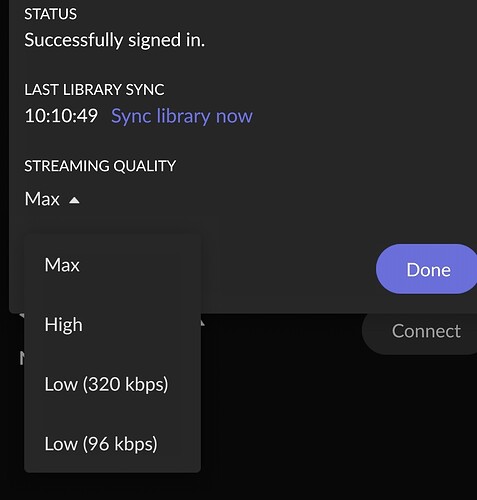

Have you adjusted your Roon Tidal setting to Max?
Do you have a Max setting, apparently some aren’t seeing it.

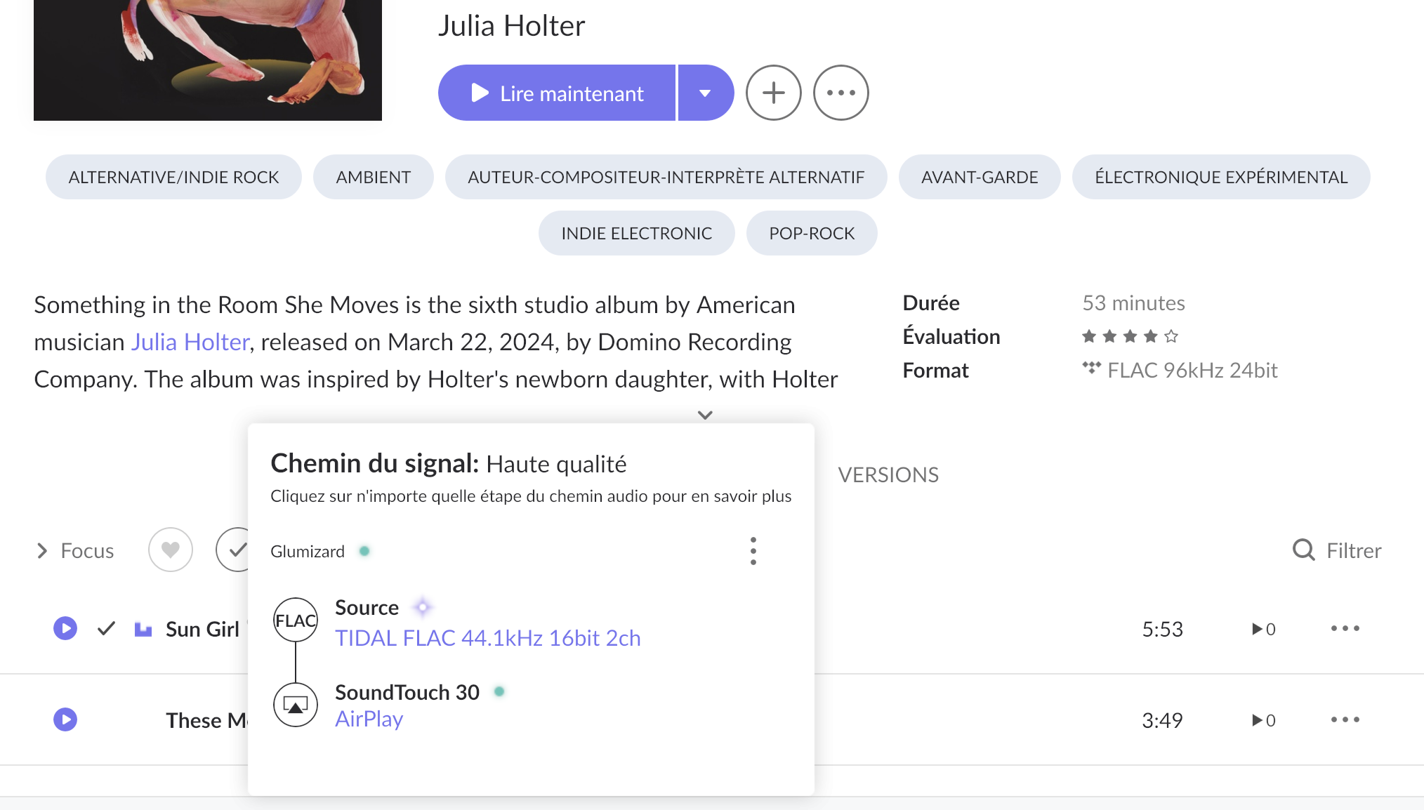

New TIDAL subscription is not on ROON yet
Tidal has changed its subscription model today (041024). Previously, I had a HiFi subscription (44khz/16bit). Now, I want to hear HiRes music from Tidal and it is always the HiFi standard music that is played through Roon (even if the music is shown as HiRes such as 96khz/24bit). I have modified directly on my Tidal account so I can have access to it on all my devices, but I want it also on Roon (as I love Roon ;-).
How can I have access to the Tidal HiRes music on Roon?

The new setting is MAX. Seems a lot of users don’t have access to the settings.

Same problem for me. Max setting doesnt show up in roon settings so cant get high res
Roon need to set something in their infrastructure. If you look at the forum you will see there are a few users in the same situation.
Does seem to be linked to your previous Tidal subscription. I’m coming from Tidal HiFi Plus and max setting is default here. And hi-res in Roon works. Just like it does with Qobuz.
Yeah Roon hasn’t updated to support Max on non HiFi Plus plans. I let Tidal lapse for a few days and just reactivated on the new price and just have high.
