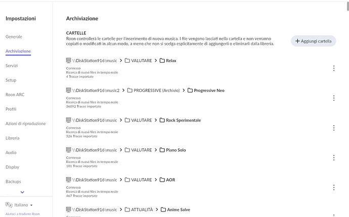

Can you post a screenshot of your Roon’s :gear: > Storage screen so that we can see what your Watched Folders are?

Is there some reason why you are adding the subfolders under music separately?
If all the subfolders just contain music files, it would be simpler to just add \\DiskStation916\music and that would then automatically include all the subfolders in the single Watched Folder…

because I want to keep the real folder structure under Roon, in case Roon goes down one day…
Well, you can keep your folder structure as it is on the NAS and still just add the top-level folder as a single Watched Folder entry in Roon…
Yes that would be nice, but do I lose the original file tracking and tags?
