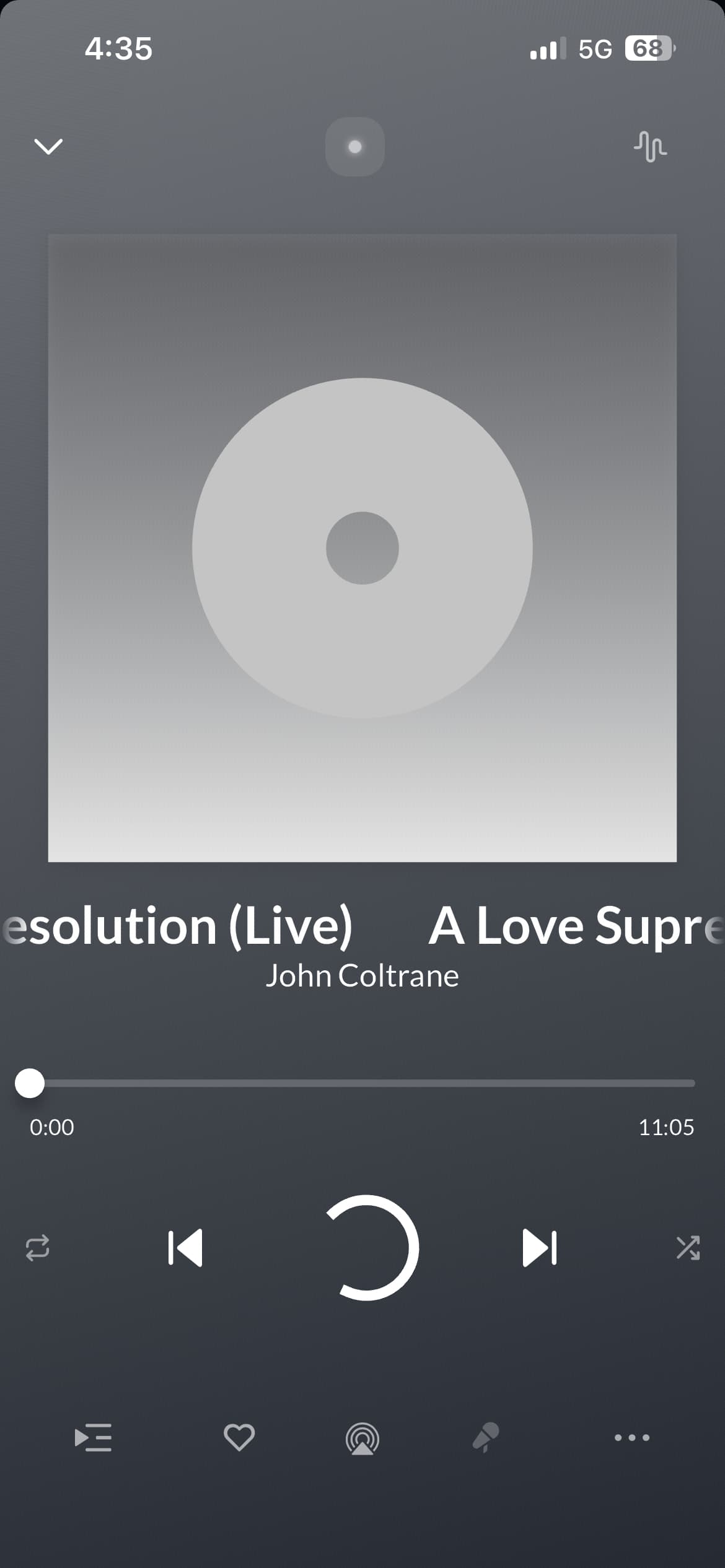

I'm not able to stream anything using ARC on my iPhone. The Roon app on my MacBook says that Roon ARC is ready, and I can stream to ARC on my iPhone when I'm home and on the same Wifi or on cellular. And it works fine when I've picked "original format" or "balanced" But as soon as I'm out of the house, I can't stream over cellular, even with a strong 5G signal, even with "balanced" playback selected. I'm pretty sure I've set everything up correctly.

I uninstalled the ARC app and reinstalled. I did a bit more experimenting and found that I could sometimes get ARC to connect when I’m on my home wifi (the same network as my Roon server.) However, on cellular (even at home) it will not connect.

I tried uninstalling ARC from my iPhone and restarting RoonServer, then reinstalling ARC and onboarding again. It seems to work better than before, but still hangs and then gives me a “poor connection” warning after a few tracks are played. But I can sometimes get a track to play if I try it again.
