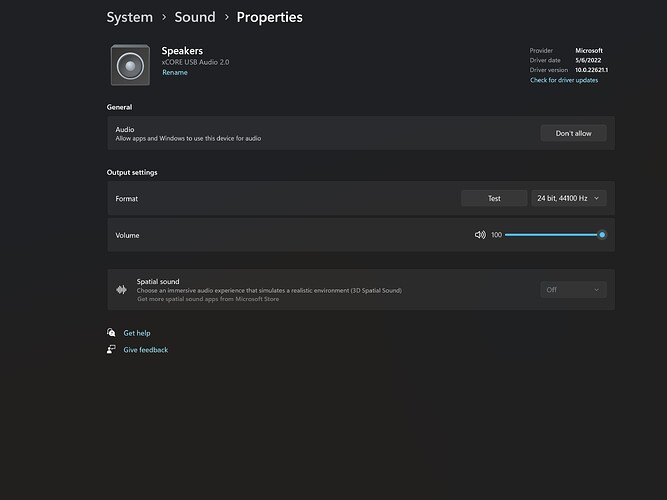

Thanks for getting back to me with this information! Since you are using System Output there are no advanced setup options as you noted. So we need to look at either device properties for the driver or the volume mixer. Something isn’t properly mapping channels here from Roon to the OS and on to the driver, and it looks like Roon isn’t getting that level of control from the OS. Can you provide a screenshot of the driver device properties from Windows settings? I’m hoping there will be an option to downmix there.
Hi, here is a screenshot of the windows sound settings for the xcore driver.
The DAC allows for all input resolutions up to 192kz input. Thank you
If you turn on spatial sound does it give you options to use 5.1 or 4 channel output?
Turning on spatial sound in sound properties didn’t reveal any further options such as 5.1 sound.
