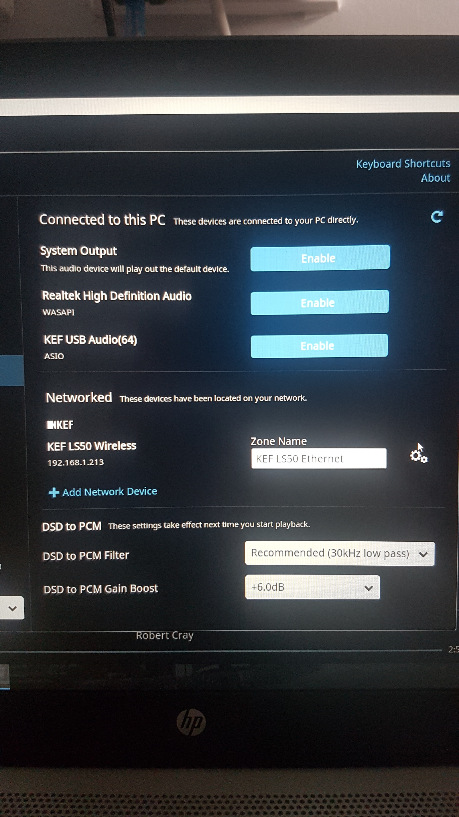

A couple of pictures to get an idea of how I’m setup…
For the 1st picture, when the problem occurs, the KEFs disappear from the ‘Networked’ section and only appears when i turn roon off and on again.

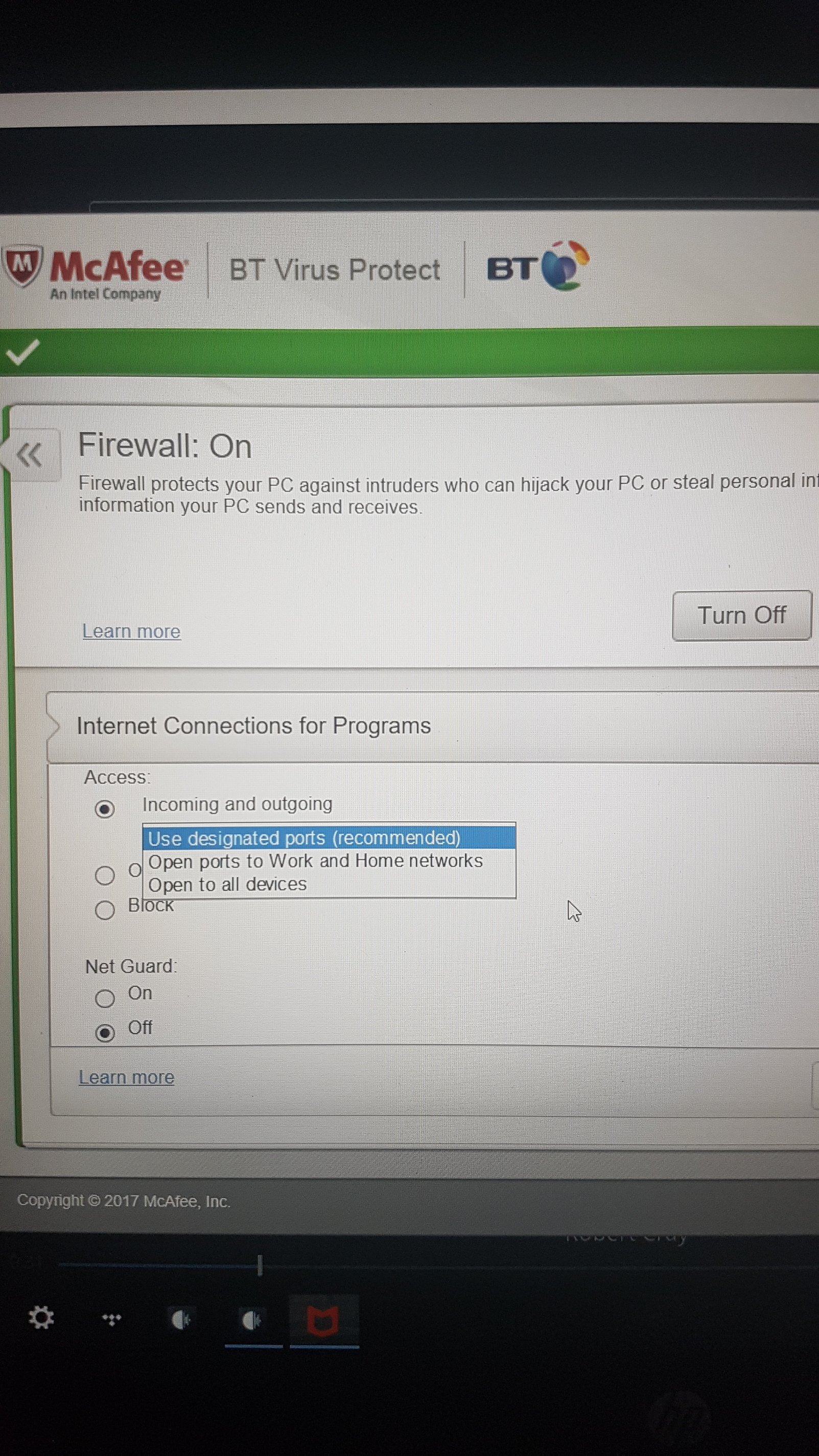

For the 2nd picture. These are the settings I’m using for both Roon and Roon Server. I’ve tried using designated ports and open to all devices but still the problem persists.
