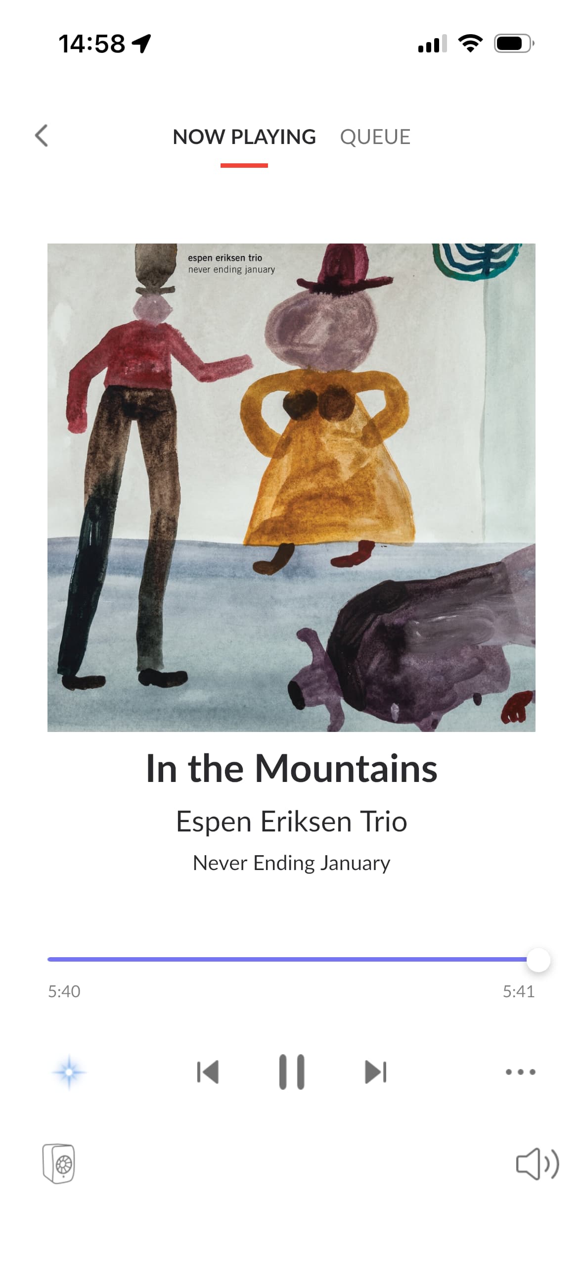

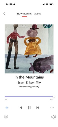

On this photo you see the behavior - music stops at the last second and stays quiet.
Setup: Macbook Pro M4 Pro via WIFI at a FritzBox 4040 (Zyxel same behavior) to KEF LSX 1 via Ethernet.

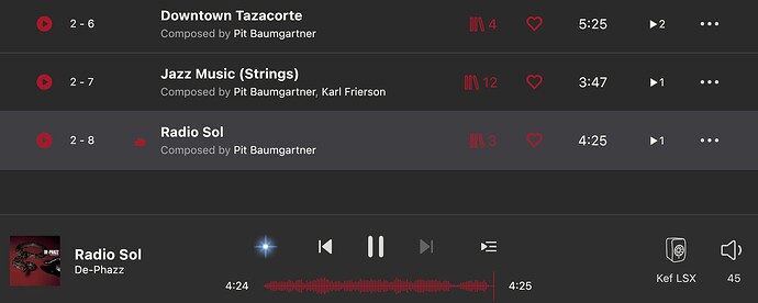

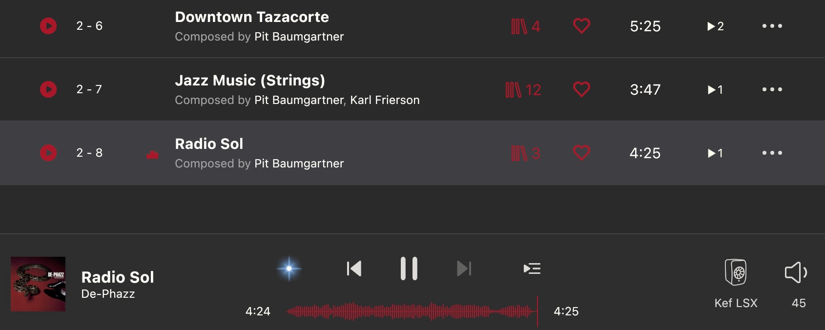

In my case, as I mentioned, it’s the last track that seems to get stuck:
The coressponding log entries do seem to indicate that this is an issue with how Roon is talking to the LSX:
01/01 17:03:40 Trace: [Broker:Transport] [Kef LSX] [zoneplayer/kef] position timer, not triggering 0 position stream ended for KEF speaker
01/01 17:03:41 Trace: [Broker:Transport] [Kef LSX] [zoneplayer/kef] position timer, not triggering 0 position stream ended for KEF speaker
01/01 17:03:42 Trace: [Broker:Transport] [Kef LSX] [zoneplayer/kef] position timer, not triggering 0 position stream ended for KEF speaker
01/01 17:03:42 Trace: [Broker:Transport] [zone Kef LSX] PlayPause
The “position timer, not triggering” message repeats until the track is manually stopped.
It’s perhaps also worth noting, that in both our cases, the position indicator seems to have extended one second beyond the end of the track and then got stuck.
