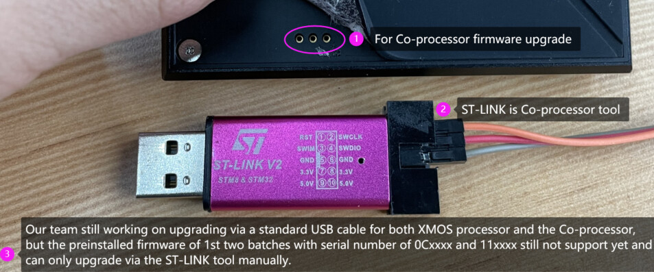

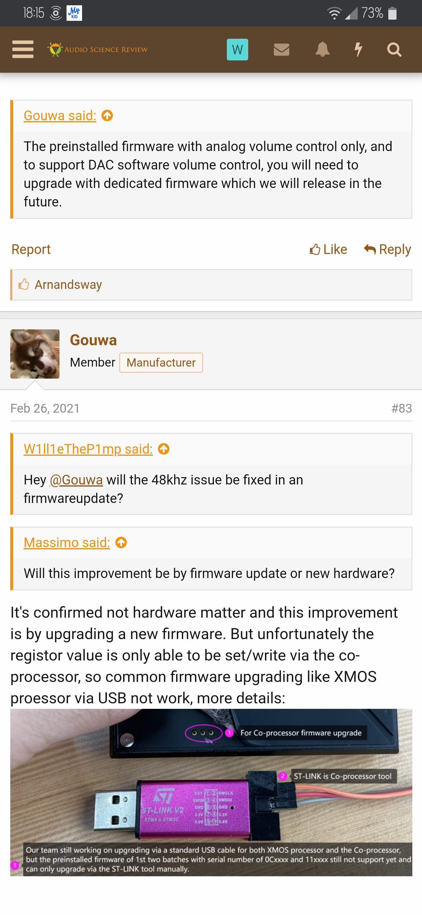

No, i probably used wrong words. I was mening the updated version where the “issues” that ASR found+polarity and most importantly a fix so that the Khadas Tone 2Pro can be firmware updated via PC without using ST-Link.
I’m not sure what “ST-Link” is, but I’ve been able to successfully re-install the firmware from a PC using a normal USB A to C cable.
You can reinstall, but not upgrade without ST-LINK due to Guowa at Khadas. This issue is on both the first two batches. So you need to buy an ST-Link to upgrade yours to the new firmware that has the fixes for phase, 48khz issue etc…
The new batch has none of these issues and will be fully upgradeable through USB without ST-Link.

Have you ordered an ST-Link? I could not find this part or instructions on how to use it on the Khadas website. Please provide a few links if you have some handy.
I just ordered one through Amazon going by the screenshot shared here. Next step will be browsing through Audiosciencereview. We will figure it out.
However! I have not found any manual to actually upgrade it this way. There’s hardly anything to find about it apart from that one short mention at ASR.
I dont know what the process is, but heard its easy. Gouwa, the guy on Audio science review works for Khadas will tell you how. My Khadas T2P will ship on tuesday(if its not furter delayed) and that doesnt need an st link.

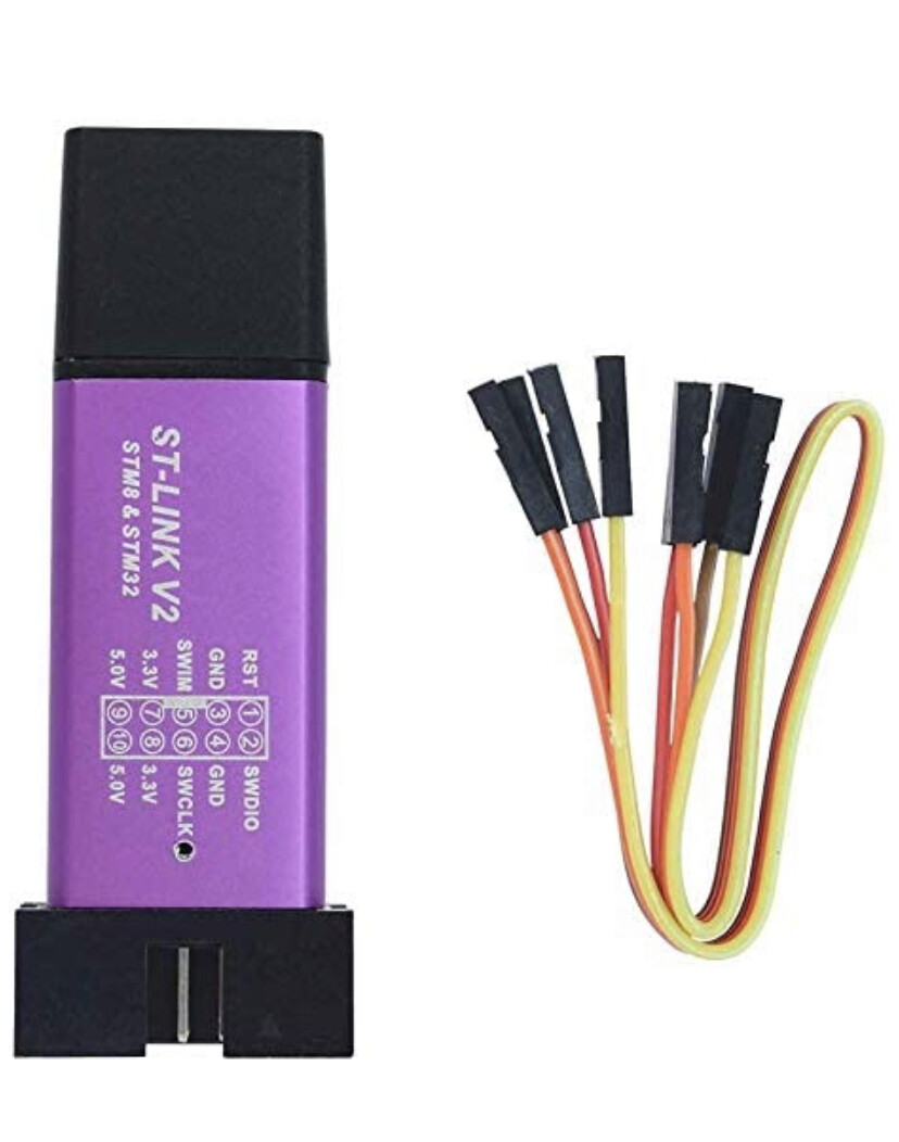

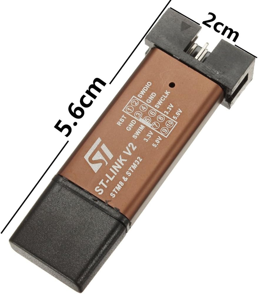

I found this one on Amazon, which seems to match the photo on ASR a little more closely (apart from color), but not sure that it matters:
https://www.amazon.com/gp/product/B01EE4WAC8/
vs.
It’s the same thing.

For one I see pinholes on the Tone2, so I assume we need some sort of pins as well.
The pin outs don’t match.
