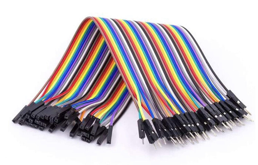

@David_Snyder did your ST-LINK tool come with the proper connector for the Tone2 Pro?
From watching the video and looking at the links to the Amazon tools, I don’t see the piece that connects to the three holes on the Tone2.
Check online at Amazon or another shop for “jumper wire male female” and you’ll have your answer.

Nope. I had to order some. Should arrive this afternoon.
https://www.amazon.com/gp/product/B08M3QLL3Q/
