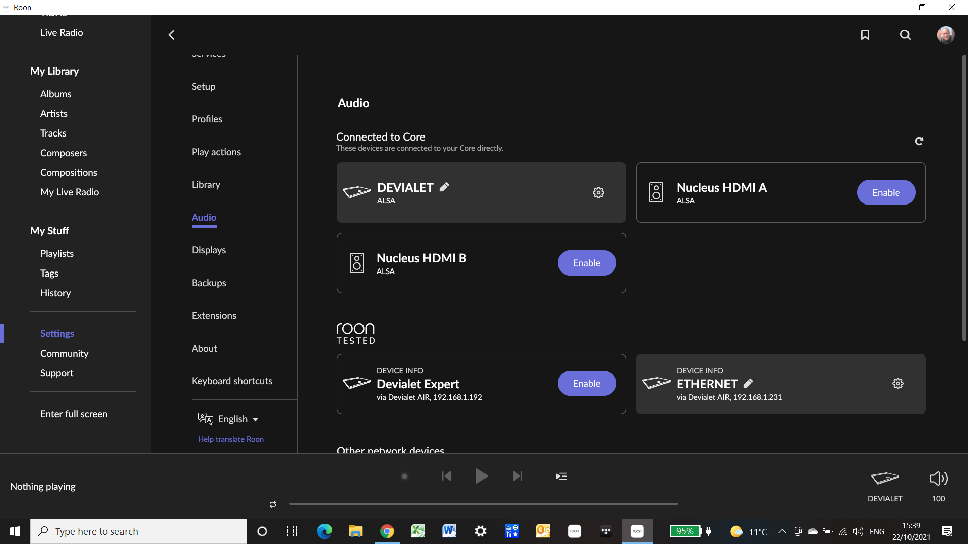

I have looked in the setting - audio , and the lap top is not available to set up as a playback device.

No, you do not need to deauthorize the Nucleus, you need to just make sure roon is running on the laptop. It should find the core server (if it is on the same network). You then “connect” to the core. You then go into settings audio and enable whatever output you are using on the laptop (should only have to do this once). If you are using a the Burson via USB make sure it is on and recognized by the laptop. You may see multiple entries for the laptop (see below screen shot of what mine looks like). Just pick the output you want, make sure the laptop is set to use that output (this may vary depending on how and what is connected).
When looking at settings audio on the laptop running roon as a remote it should show up under “this PC” and show all the possible endpoints. like this:
In my case, I pick either “engineering” which is my system output or “HD3” which is my speakers hooked up to my computer via USB.

When you go to settings → audio
is your laptop’s soundcard listed? I do not see it in your screenshots.
is it enabled?
is it configured correctly?
Have you changed the laptop from being a server to a client? (deauthorized)
Have you logged into the real core?
You can then use the laptop to be a “remote” to play to the laptop.
Remembering anything not to be local to your core is “remote”.
I have this on my system. I note it is entirely missing in your screenshots. I think your laptop is still thinking it is the core.
First point .
No as per the screenshot there is nothing at all to do with my lap top listed in my settings - audio

That is strange. It says right there that under connected to core is the “nucleus HDMI”. I assume the devialet is connected to the Nucleus?
That being said even when I set my laptop as the core is still has a section for “this PC”.
Is the screen shot you showed from the laptop running roon? just to be clear. :slight_smile:
On the laptop what does it say under “settings\about” in Roon?
Yes the Devialet is connected to the Nucleus by USB
Yes the screen shot is from the lap top.
