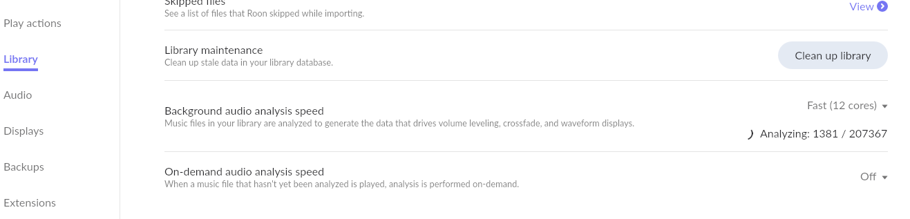

The suggestion was meant to be either/or. Not both. That is switch audio analysis off entirely whilst importing and then rely on audio analysis on demand whilst playing. This could be complimented by temporarily switching on audio analysis (12 core) overnight whilst sleeping or otherwise not listening to roon.
OK. I’m not really listening to Roon much at all. I’ve previously had things on ā€œthrottledā€ (not completely off) - would that cause this slowness…? I’ll turn the ā€œon demandā€ analysis ā€œoffā€ now (since I’m not listening anyway), and leave background on 12 cores. I’ll report back tomorrow.
The difference between one thread and 50 threads was night and day for me.
No. That’s the opposite of what you should be doing.
  1. Turn audio analysis off completely. No audio analysis will then be slowing down the importation process. Throttling is also good but you may as well just turn it off completely.
  2. You can keep audio analysis on demand switched on as it will have no effect until you are playing something after the importation process is completed.

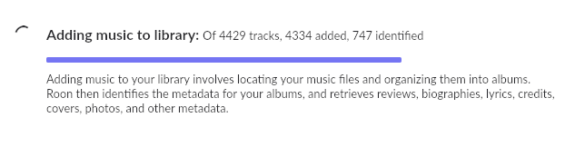

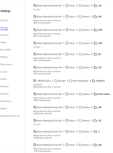

Another bit of confusion is with the numbers related to ā€œAdding Music to Libraryā€ (tracks / added / and identified change when you restart the Roon server), Background analysis speed (with the number of tracks being analyzed not synching with any other number that I can see), and the actual number of tracks in play (I’ve not yet started the scans for various artists albums starting with U, V, W, X, Y, or Z). Here are the screenshots (as of a minute or two ago):
Adding
(This following one is a bit truncated, but you get the idea):
