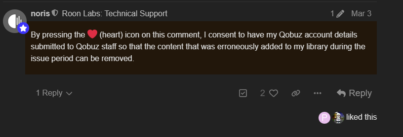

@Dennis_Dort - If you go to the thread linked in @Suedkiez 's post immediately above yours, you will see a message from Support offering to fix your issue by providing your details to Qobuz staff directly - they can then fix your account personally.
Thanks. I did that about two weeks ago and have not heard, or gotten a result. I’ve started removing them manually — doing about twenty or so each time until I get tired of it. Kind of like weeding the garden. I hadn’t known that Celine Dion and Chris Botti had made so many albums.
I stumbled upon a way to delete albums in large batches. Took out more than a thousand and am still not done. Still, any help anyone can provide will be helpful
There’s no post of you in the linked thread. It’s auto-closed, though, so maybe @Geoff_Coupe can reopen it?
Thanks. I didn’t post, but took the invitation to hit the like button — Figures that if the thread was closed, nobody’s going to be paying a lot of attention. As you’ve seen above, I used the self-help option, highlighted the albums in groups of fifty and hit delete. There were a LOT of them, and I’m afraid, not wanting to speak ill of someone who is almost certainly not here, almost none of them were any good at all.
I suspect you clicked “like” on the wrong post - you didn’t do it on Noris’s post…
