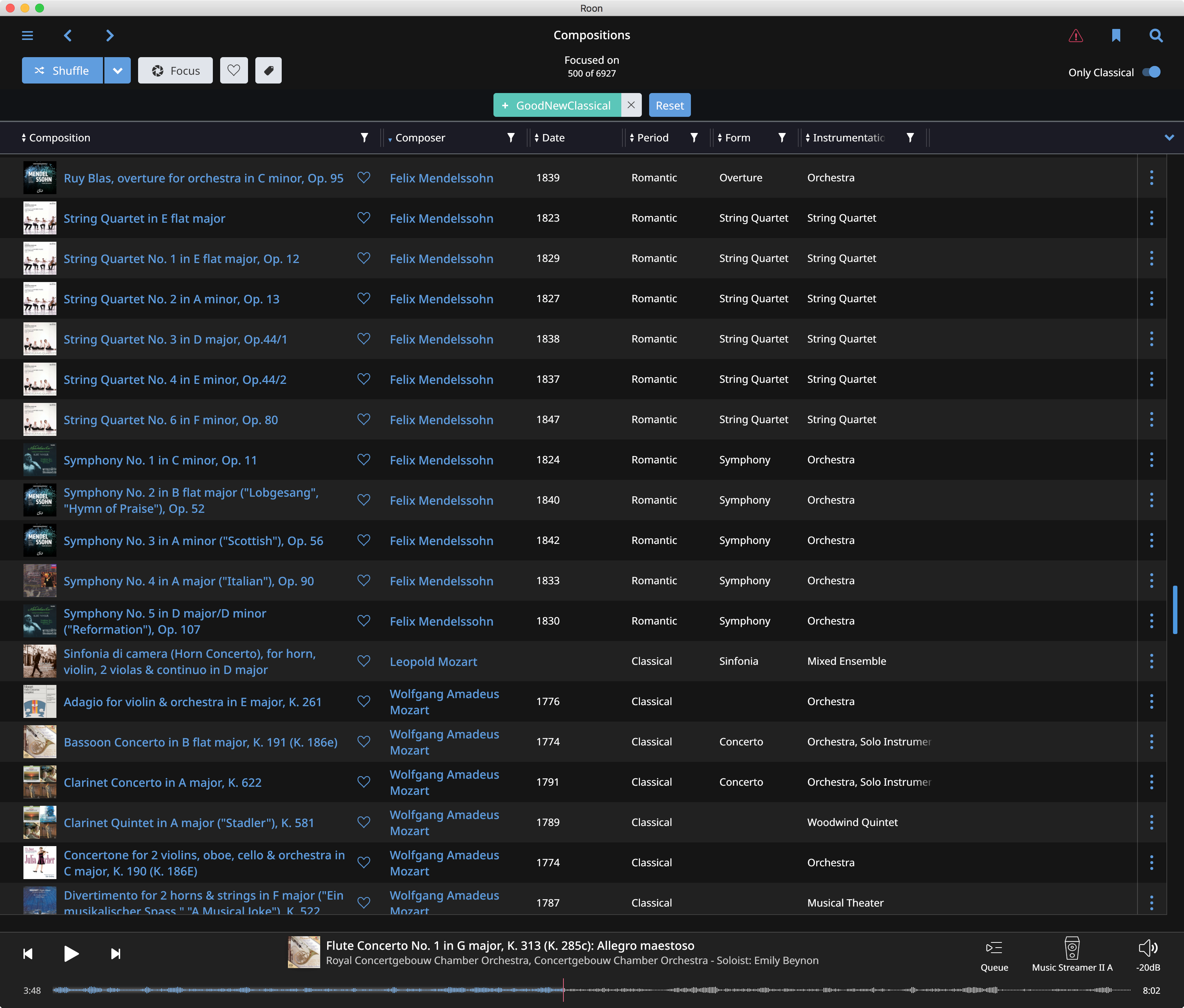

Wow – I never knew about this view! I just happened to glance at this thread, and learned something incredibly useful. (And, very impressive about Roon). Thanks, @antonmb
And @Mark_Sealey – I did very little to get my library into a state where this would work – I unfortunately have little patience for metadata editing. The one thing I did do was make sure that each album of mine is identified by Roon. (Perhaps easier to do with a classical library of a few hundred like mine – not sure how large your classical library is).
I have the same Mandelring set BTW, and it shows up organized in this view. (All I did was make sure those albums were identified by Roon when I added them).
Haven’t read all of this thread, so not sure if that helps at all…
Thanks @otinkyad; it does help. I am getting an overwhelming sense that ‘all’ (!) one has to do is respect the form and format - and the arrangement of files - which come with each download and Roon does the rest.
