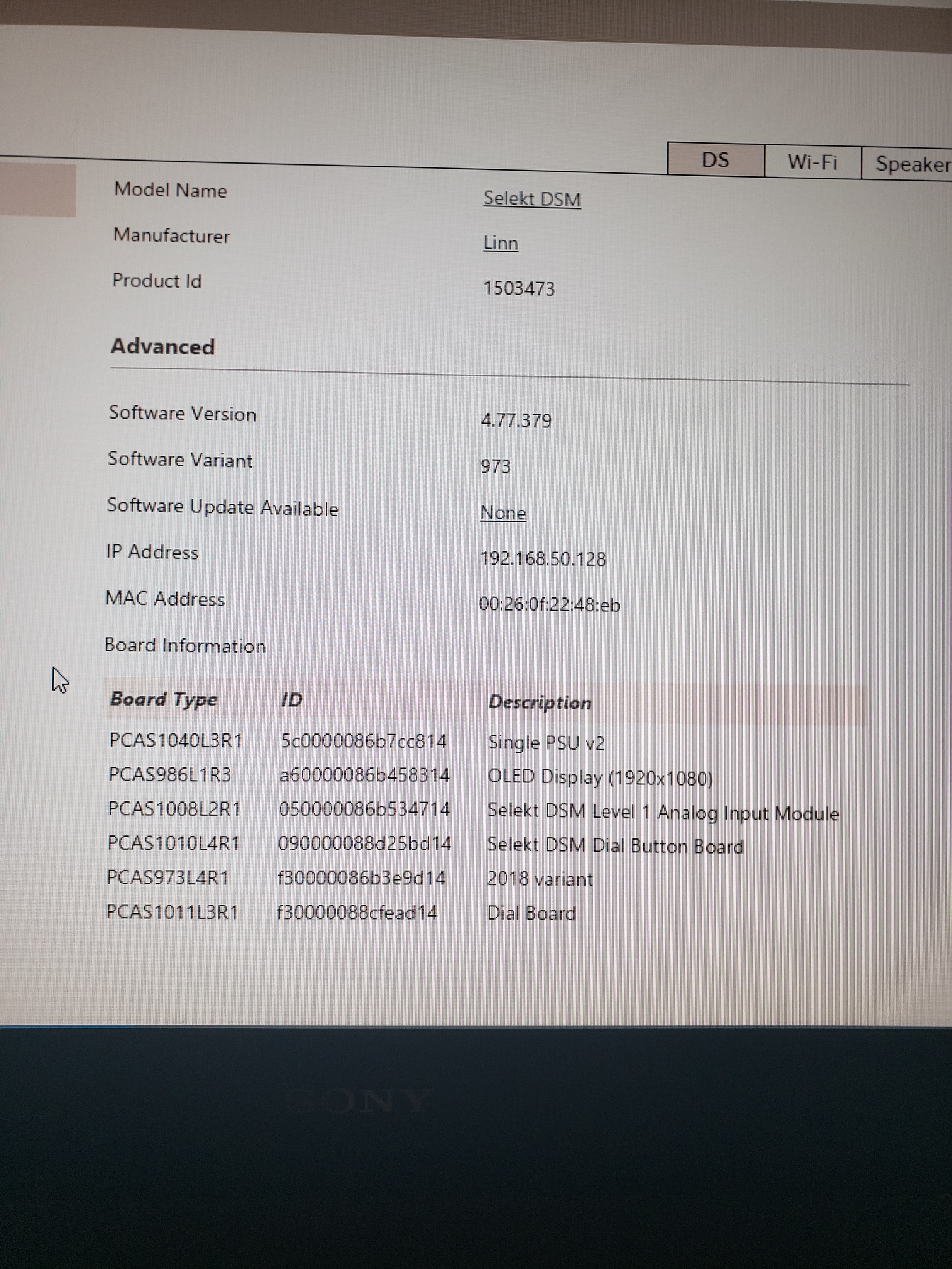

I’m using 5ghz, Qnap NAS connected via Ethernet connected to an Asus GTS 11000 router. My core is a Lenovo Z50 PC as my core and iPad 7th gen as remote. My DSM is connected via Ethernet through a Netgear power line 1200.
Also using windows 10
Core
Lenovo Z50 PC running win10
Netgear modem, Asus GTX 11000 router
LINN SELEKT DSM with KATALYST connected via Ethernet through Netgear power line 1200 150mbps measured at power line with an abundance of bandwidth.
