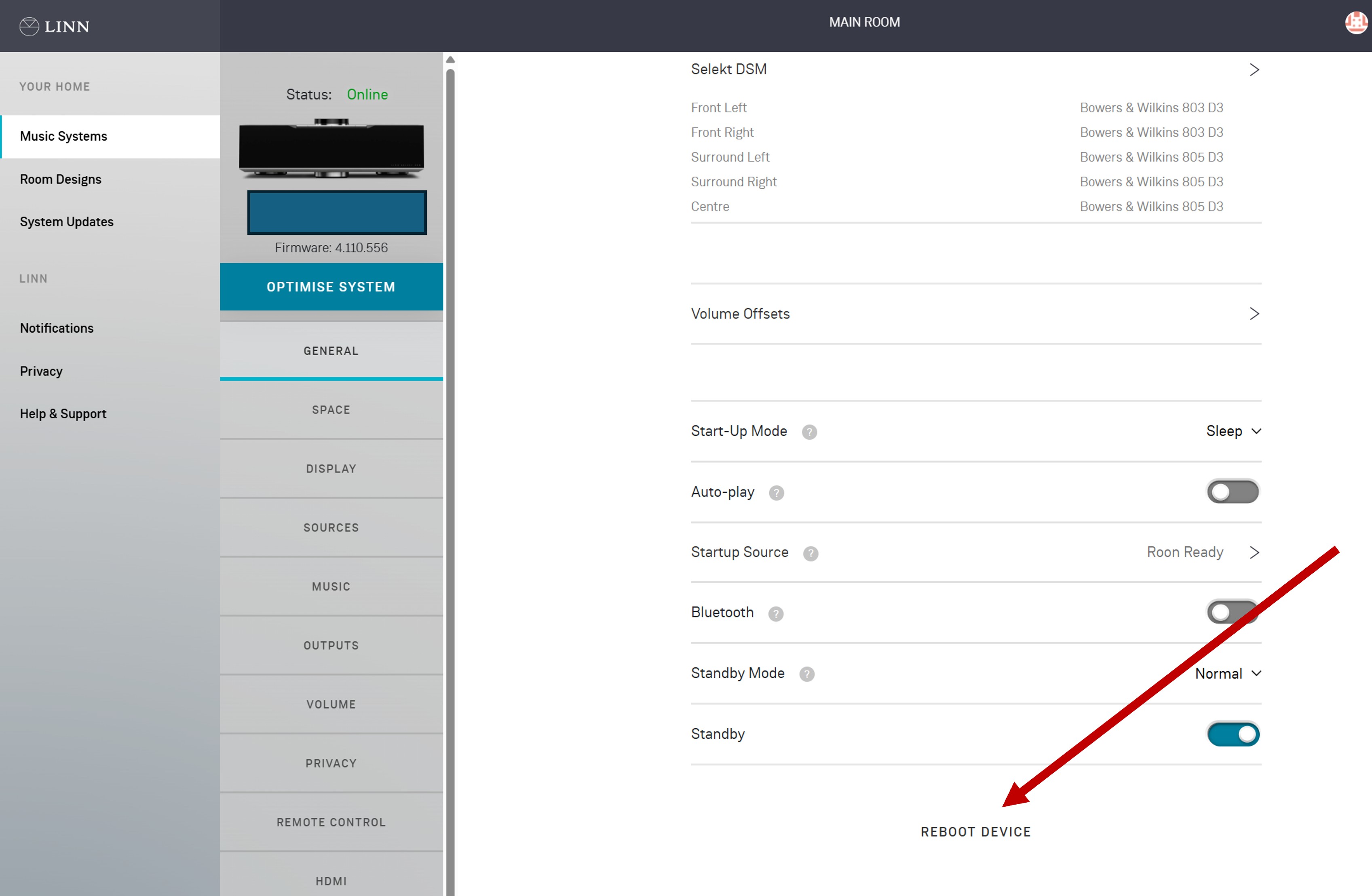

Two mitigating hacks I have discovered to keep Roon up and rolling for as long as possible:
Do a soft reboot of the Selekt preemptively from the Linn App – in advance of a listening session. That seems to clear the lines, so to speak.

PS: Users who have the same problem. Login to Linn Account an perform a “Reboot” - that is better than doing a “Power-Off” on the back
